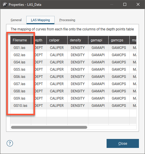

The Properties window for LAS Wells includes a LAS Mapping tab that shows what data files have been used for the selected well:
This is useful when data for a well originates in different files.

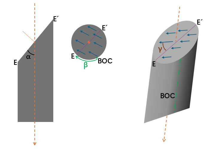

Alpha is the minimum acute angle measured between the core axis and the geological plane
Beta is the angle of rotation clockwise (looking towards the end-of-hole) from the bottom-of-core line to the apical trace, the long axis E-E’ of the ellipse formed by the geological plane when alpha < 90 degrees

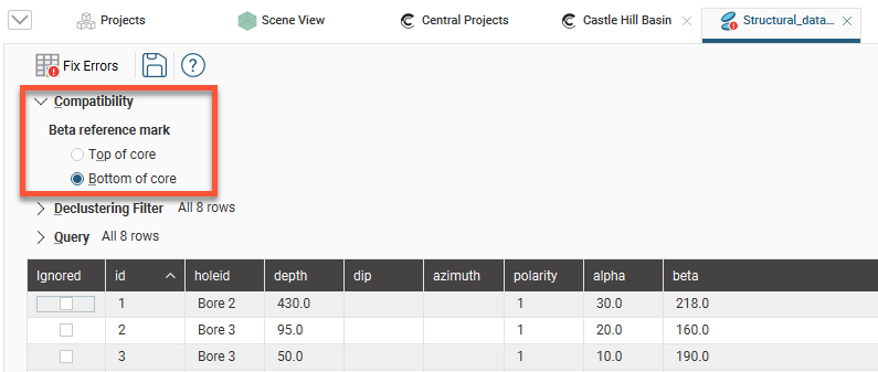

If the structural orientation is specified using alpha and beta, the reference line from which the beta is measured can be the bottom or top of the well. When the table is imported, the default setting is Bottom of core. To change this, double-click on the structural data table in the project tree. Next, click on Compatibility to change the Beta reference mark setting to Top of core:

Alpha (α) is the minimum acute angle measured between the core axis and the geological plane
Beta (β) is the angle of rotation clockwise (looking towards the end-of-hole) from the bottom-of-core line to the apical trace, the long axis E-E’ of the ellipse formed by the geological plane when alpha < 90 degrees
Gamma (γ) is the angle of clockwise rotation between the beta plane (the long axis E-E’) and the lineation plunge direction, when measured on the geological plane defined by alpha and the long axis E-E’ of the ellipse when alpha < 90 degrees
