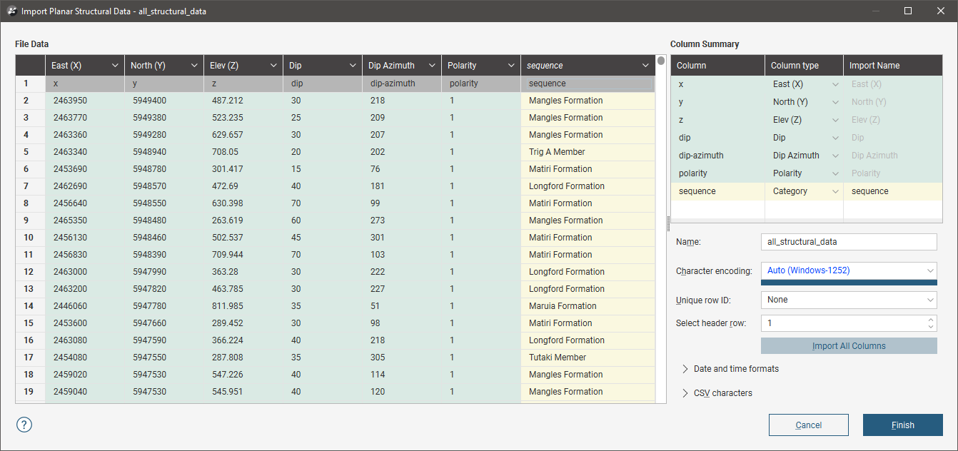

For each of these options, once the data source is selected, the process of importing the data is the same. Leapfrog Energy will display the data and you can select which columns to import:
Leapfrog Energy expects East (X), North (Y), Elev (Z), Dip and Dip Azimuth columns. The Polarity column is optional. The Base Category column can be used for filtering data once it has been imported.
If the source data contains alpha, beta and gamma columns, Leapfrog Energy will convert these to dip and dip azimuth for use in Leapfrog Energy.
Click Finish to import the data.
