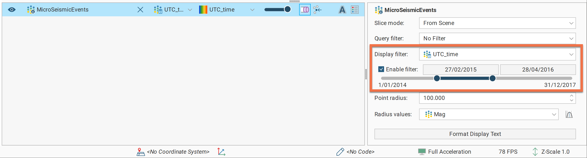

Time-dependent points can be filtered in the scene by another numeric column, e.g. a time or date column. This enables, for example, micro-seismic data to be visualised over time using a range slider. To view data in this way, click on the points table in the shape list, then select a time or date column as the Display filter in the properties panel:
Next tick Enable filter and either click the date buttons to set the upper and lower limits or use buttons on either end of the slider.
