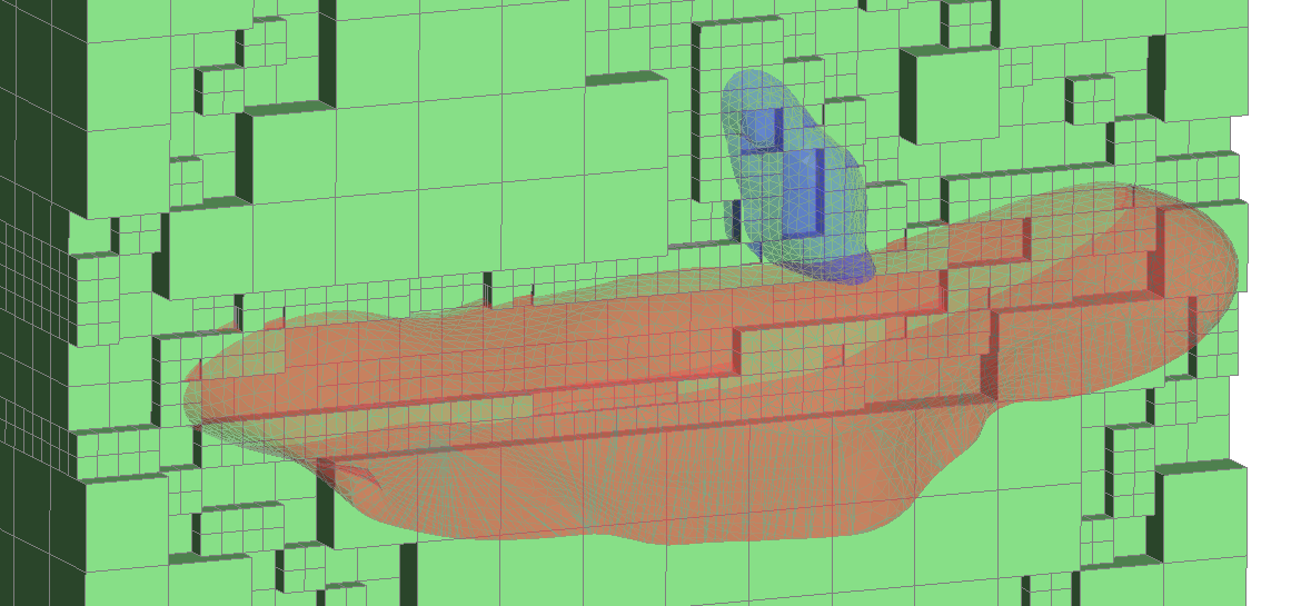

The Grid Pattern
The cross-hatched pattern shows how the parent blocks will be divided into sub-blocks. These properties can be changed by adjusting the Parent blocks and Sub-blocks settings. The Sub-block count is the maximum number of divisions a parent block can be divided into in a particular direction when it intersects a trigger. Note the block can only be divided into numbers of divisions that are a power of two to a maximum of 64, as the sub-blocking strategy is to repeatedly divide units in half. Variable height sub-blocks are not supported in octree block models.
Here the block size is 100 and the sub-block count is 4 x 4 x 32, so blocks will range in size from 100x100x100 down to 25x25x3.125. Note the variety of sub-block sizes as the sub-blocking is triggered on the geological model surfaces, two of which are shown (in red and blue):

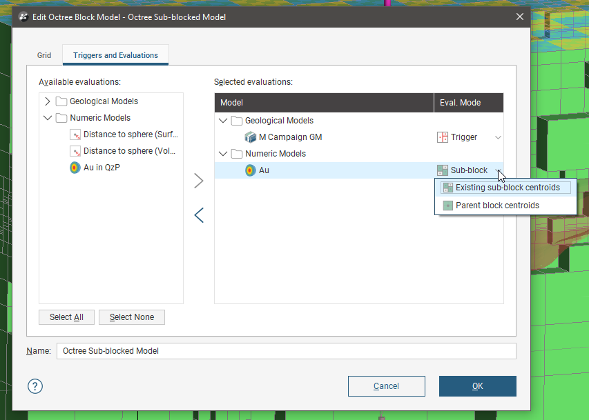

Triggers and Evaluations
Click on the Triggers and Evaluations tab to select from the volumes available in the project.
Triggers can be:
- Geological model volumes
- Combined model volumes
Meshes and interpolants cannot be used to trigger octree block model sub-blocking.
Evaluations can be:
- Grouped meshes
- Interpolants
- Distance functions
All suitable objects in the project will be displayed in the Available evaluations list.
Move the models you wish to use into the Selected evaluations list, then select the Eval. Mode. You can select from Existing sub-block centroids or Parent block centroids. Models that can trigger sub-blocking will also have the option to Trigger new sub-blocks. These selected options are abbreviated in the edit window as Sub-block, Parent, and Trigger respectively.
Enter a Name for the octree block model and click OK. The model will appear under the Block Models folder. You can make changes to it by double-clicking on it.

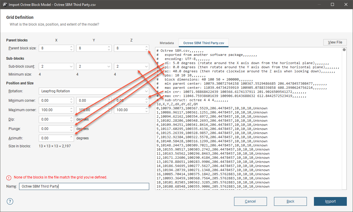

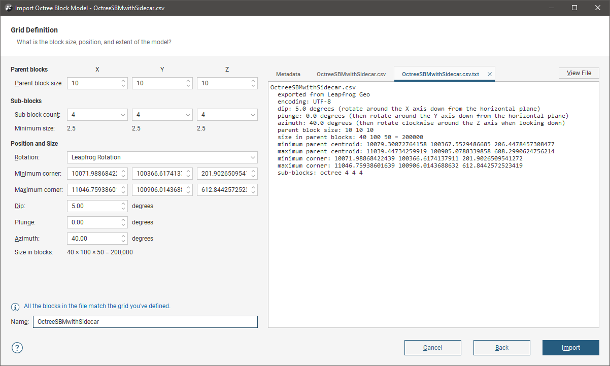

If you are opening an octree block model *.csv file created by Leapfrog, the Grid Definition fields will be automatically populated.
A Metadata tab contains additional information extracted or processed from the file content, including the block sizes that result and the counts for each, and the coordinates for the minimum and maximum grid corners were the grid not rotated.

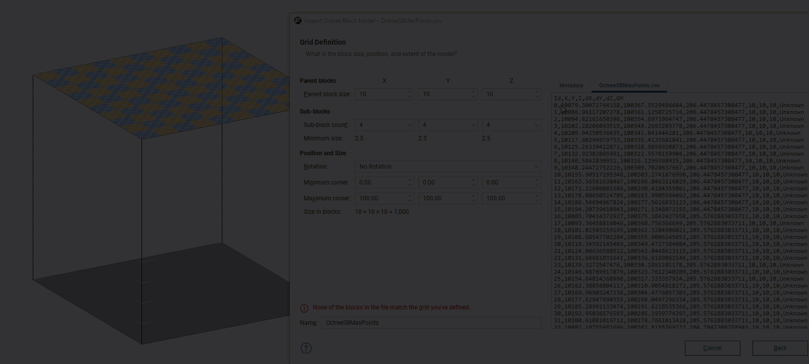

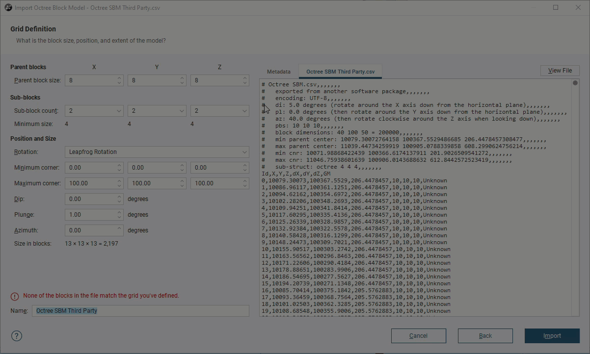

In cases where Leapfrog Geo cannot automatically parse the grid definition information from the file, it will be necessary to enter the block size, position and extent values for the block model you are importing. You may be able to find this information in the header at the top of the *.csv file, which is displayed on the right side of the screen. Copy the relevant information from the header into the Parent blocks, Sub-blocks and Position and Size fields.
Note that besides the Leapfrog and Surpac rotation type options, the Custom Rotation option for Rotation type allows the rotation values around X, Y and Z to be specified in any order, and, when needed, to indicate that the values in the file are in rotated model coordinates.
Validation messages at the bottom of the Grid Definition fields check to see if the values in the Grid Definition fields result in a match for the blocks in the source file. Once you have a valid set of definition fields, the validation message will read: All the blocks in the file match the grid you've defined.
To make this process easier, Leapfrog Geo makes it easy to move numbers from the file over into the Grid Definition fields. Select content from the right pane and drag it over to the Grid Definition fields. As you drag the value over fields on the left, boxes will be highlighted to show where the value(s) will be entered when you drop them. You may include the label and other content in the selection, and only the selected numbers will be pasted. When a line contains several numbers, all can be selected and dragged over, and depending on how many numbers you selected, two or three adjacent fields will be highlighted to show where the numbers will go.

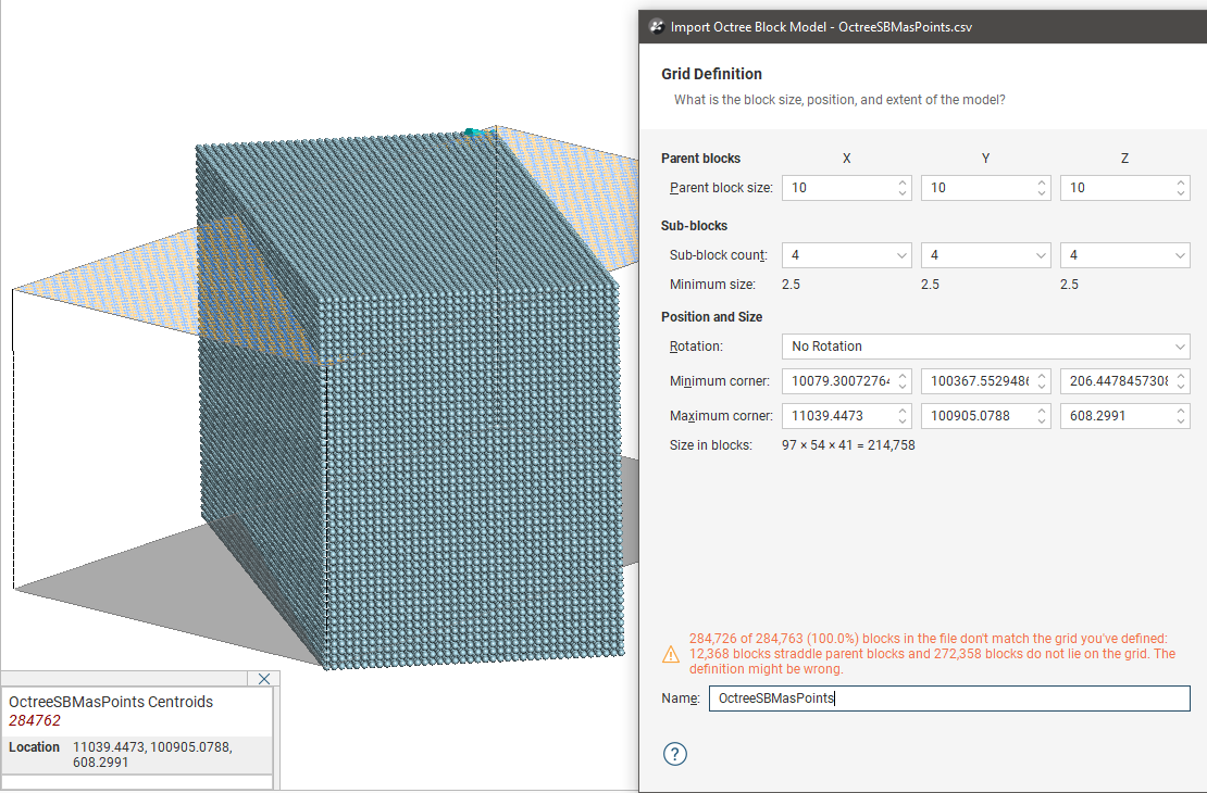

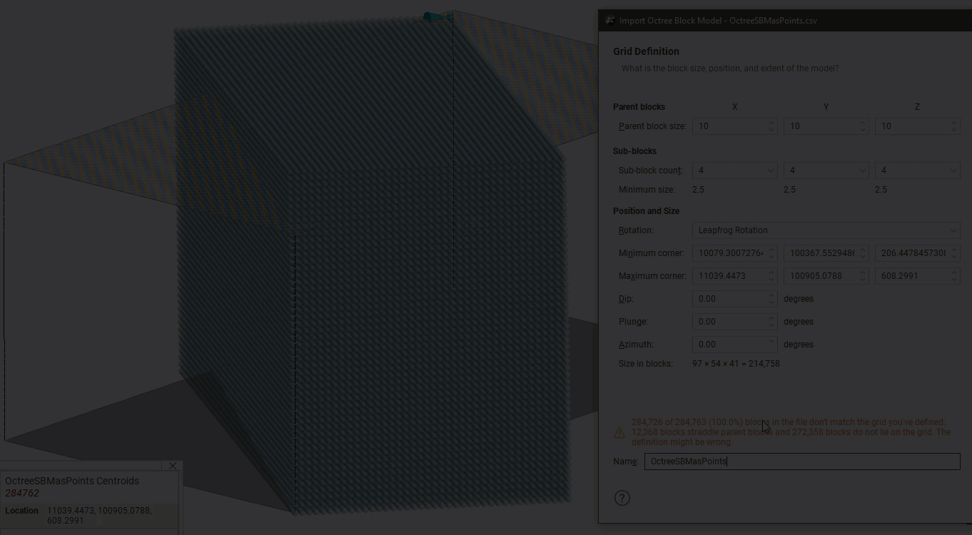

Clear the scene view, then open the *.csv file as you would for any other octree block model file. Right-click on the Block Models folder in the project tree and select Import Octree Block Model. Choose which columns in the *.csv file you want to import in the Select Attributes window, then click Next.
Move the Import Octree Block Model window so you can see the scene view window at the same time. Unless your imported points are near the origin, you probably cannot see both the grid definition preview box and the imported points in the same view. To position the grid definition preview box closer to the imported points, select the x, y and z coordinates from the first line of the *.csv file and drag them into the Minimum corner fields. Enter values in the Maximum corner fields that are larger than the Minimum corner values and likely to be close to enclosing the imported blocks. It isn't important to be exact right now as the purpose is to get the grid definition preview box adjacent to the imported points. Once you have entered approximate minimum and maximum corner values, click in the scene then hit the Home key to recentre the scene on the objects in the scene. You should see a cloud of imported points and the grid definition preview box, although they are unlikely to be properly aligned at the moment.

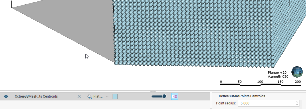

In the shape list, you can change the appearance of the imported block centroid points, such as making the points solid, changing their colour and changing their size. Selecting a point size radius to half the expected size of the parent blocks can be useful for visual alignment of the grid. The points should almost touch and generally not overlap, although this may be seen where there is sub-blocking evident.
Determine which corner is the minimum corner position, then select the most distant point on the opposite side of the imported points. The information window for the selected point will provide x, y and z coordinates for this point. Enter these values in the Maximum corner fields in the Grid Definition.
Do not hit the Enter key during this process because that will start the file Import process and the grid definition cannot be edited from that point, and it will be necessary to start the block model import over from the start

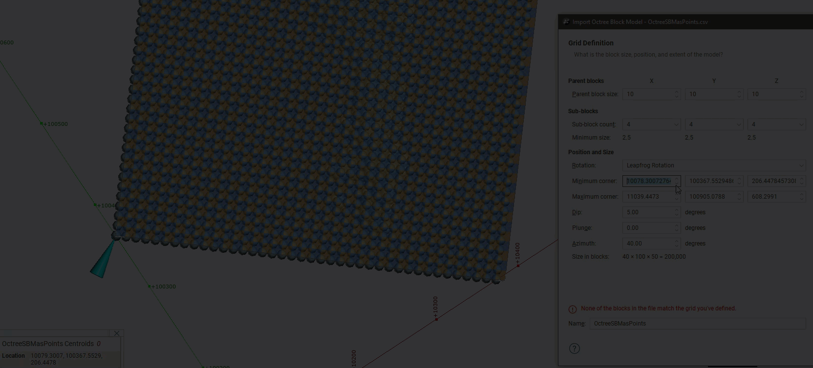

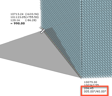

Use the ruler to draw along the edge of the points. Note the orientation in degrees to get helpful hints for the angles to enter for the grid definition rotation angles.
From the Rotation options list, select Leapfrog. Having already selected the Minimum corner and Maximum corner, the grid will reposition between these two points as the Dip, Plunge and Azimuth fields are changed. If you select Surpac, the Maximum corner will move as the Bearing, Dip and Plunge fields are changed, which will result in more adjustments as the manual alignment progresses.
Start with the Azimuth setting and change the angle until the grid definition preview box appears to align with the grid of points. Then adjust the Dip angle until the grid definition preview box aligns. Finally, adjust the Plunge angle to get the grid definition box fully aligned with the cloud of points.
Although the grid definition preview box should appear to be well aligned with the grid of points at this stage, the validation message is probably indicating that the blocks defined by the grid definition do not suit the points in the imported file. This will be because the grid corners were set up to align with the points which are block centroids and we need to offset the definition by half the parent block dimensions. Because of the rotation angles involved, this is often not as simple as reducing the Minimum corner values by half the block size, however. It can be useful to rotate the scene to look straight down a row of points and adjust the x, y and z coordinates to line up to the edge of the points, rotating the scene as necessary to observe the points from different angles. It may be necessary to adjust the Minimum corner coordinates by less than single unit steps to align the grid definition box well enough to match the grid with the block points in the imported file.
When you see that you have a good match with the blocks in the imported file, click the Import button. The octree block model will be imported and will be added to the Block Models folder in the project tree.

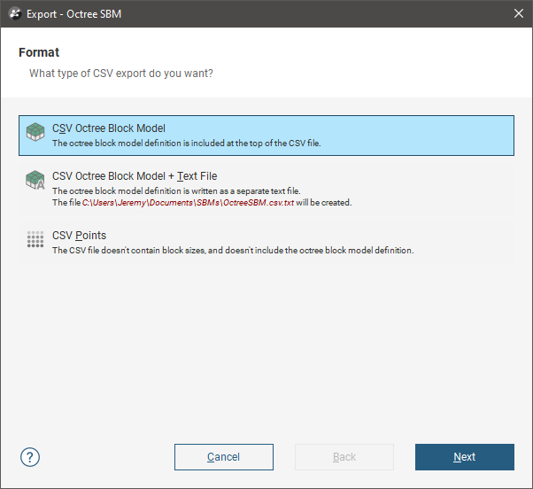

To export a sub-blocked model, right-click on the model in the project tree and select Export. Select whether you would like to save the file as a CSV Block Model File (*.csv) or a Datamine file (*.dm). Enter a name and location for the file and click Save.
If you wish to export the model in one of the CSV formats, select CSV Block Model Files (*.csv) in the Export Block Model window. You will be able to choose between the three CSV formats in the next step.
If you select CSV Block Model File you will be prompted to select a specific CSV file format: one with an embedded metadata header, one with a sidecar *.txt file containing the metadata information or a file containing only points data with no associated metadata.
