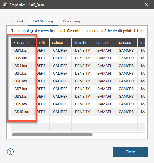

The Properties window for LAS Drillholes includes a LAS Mapping tab that shows what data files have been used for the selected drillhole:
This is useful when data for a drillhole originates in different files.

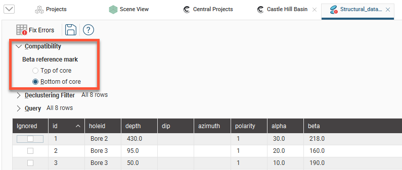

If the structural orientation is specified using alpha and beta, the reference line from which the beta is measured can be the bottom or top of the drillhole. When the table is imported, the default setting is Bottom of core. To change this, double-click on the structural data table in the project tree. Next, click on Compatibility to change the Beta reference mark setting to Top of core:
