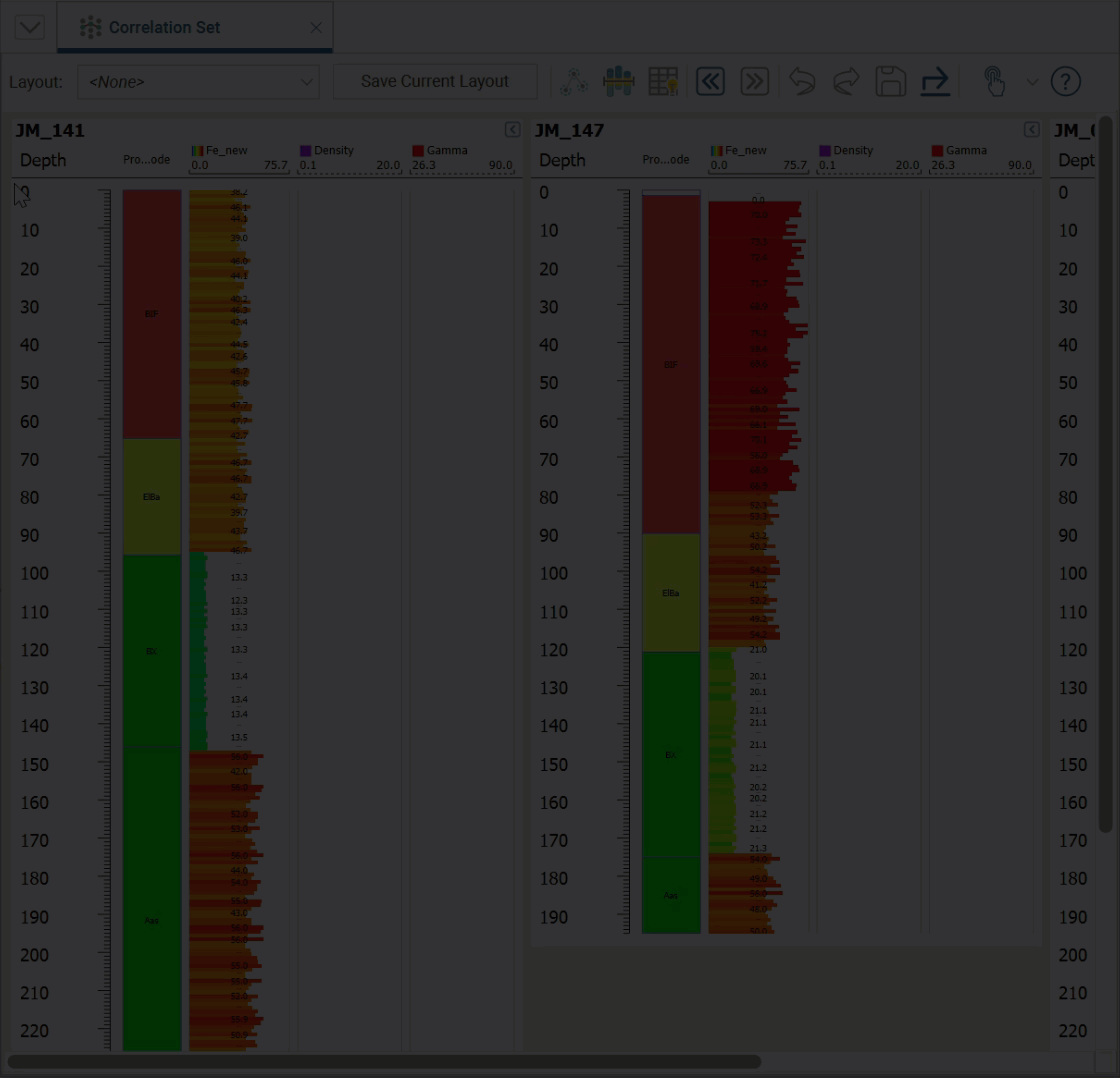

The Correlation Set Window
Each drillhole is represented by a vertical panel that can display several columns of information. You can change the sequence the drillholes appear in by clicking-and-dragging the collar to a new position. A vertical line will appear where the drillhole will be repositioned.
Remove collars from the correlation set by either editing the set in the scene, as described in Selecting Collars above, or right-click on a collar header and select Remove collar from the pop-up menu:
Collar metadata is available by right-clicking on a collar header and selecting Collar details.
Add data columns you want displayed for each drillhole by dragging-and-dropping data columns from the project tree somewhere onto a drillhole panel. Depending on whether the data is category or numeric, interval or points data, the default appearance of the data column will be set appropriately. This visual formatting can be adjusted to suit your preference or internal standards.
The sequence of data columns can be changed by clicking-and-dragging the column. A vertical line will appear where the column will be repositioned.
You can remove data columns from the drillholes by right-clicking on a column header, then selecting Remove. Multiple columns can be removed in a single action by holding Ctrl while clicking on the column headers, then clicking on Remove selected columns.
The width of each of the data columns in a vertical drillhole panel can be adjusted. Changing the column width in one drillhole will also change the width for the corresponding column in all other drillholes in the correlation set.
Drillholes in the correlation set can be individually collapsed and expanded, or collectively collapsed and expanded. To collapse a vertical drillhole panel, click the collapse button ( ) in the top-right corner of the drillhole panel. The collapsed drillhole will show an expand button (
) in the top-right corner of the drillhole panel. The collapsed drillhole will show an expand button ( ) in its place that can be used to reveal the drillhole data once again. To collapse all the drillholes, click the Collapse all drillhole information button (
) in its place that can be used to reveal the drillhole data once again. To collapse all the drillholes, click the Collapse all drillhole information button ( ) in the correlation set toolbar. The Expand all drillhole information button (
) in the correlation set toolbar. The Expand all drillhole information button ( ) restores the view for all drillholes.
