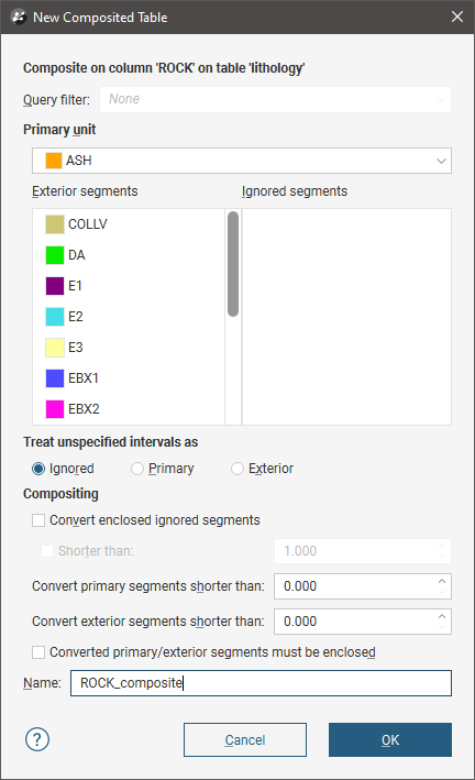

Right-click on the Composites folder, which is in the project tree as part of each drilling data set, and select New Category Composite. You will be prompted to select from the category columns available in the drilling data. Next, the New Composited Table window will appear, showing the options for sorting intervals in the selected column:

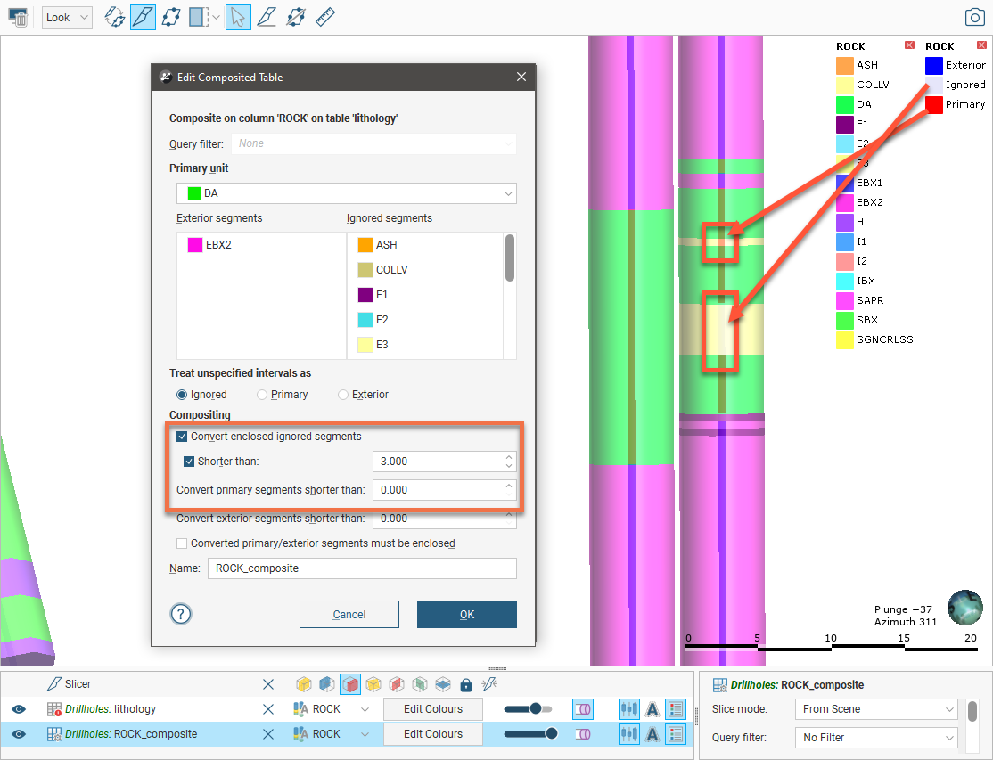

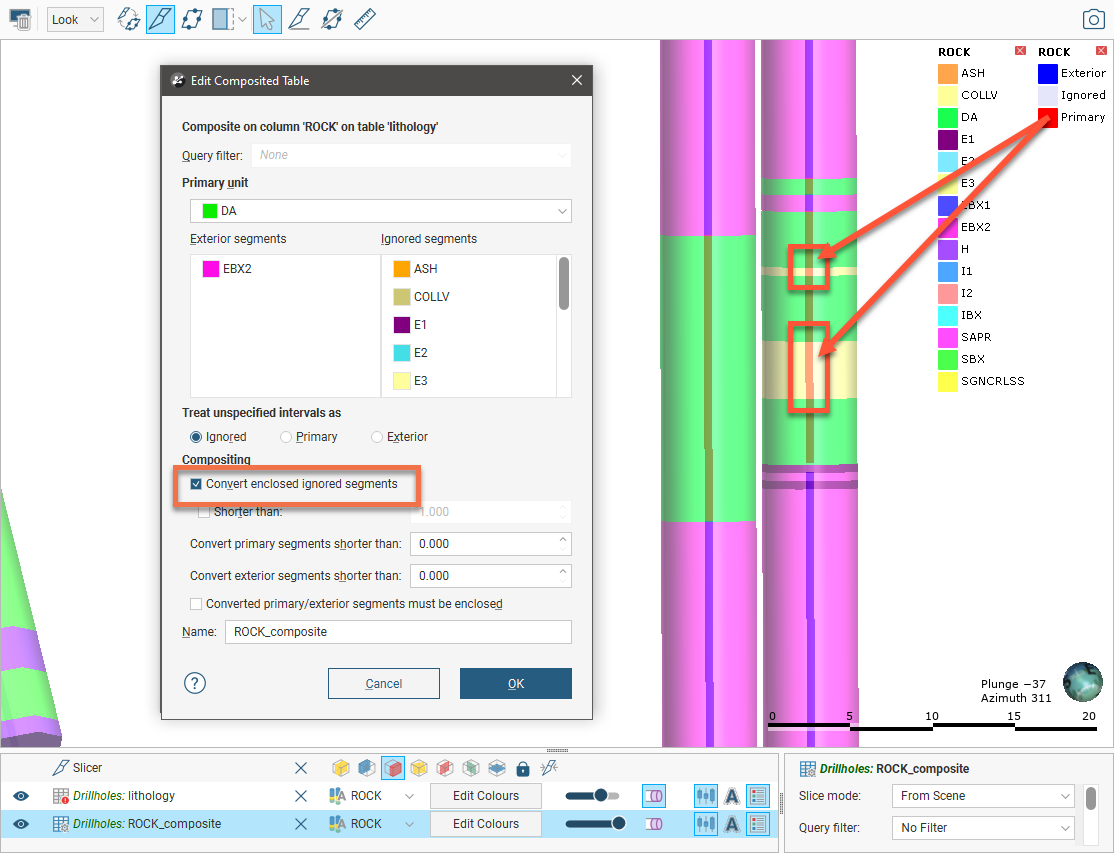

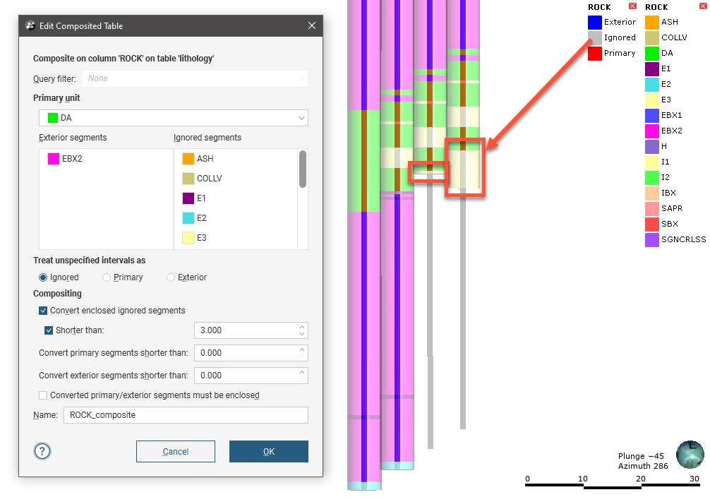

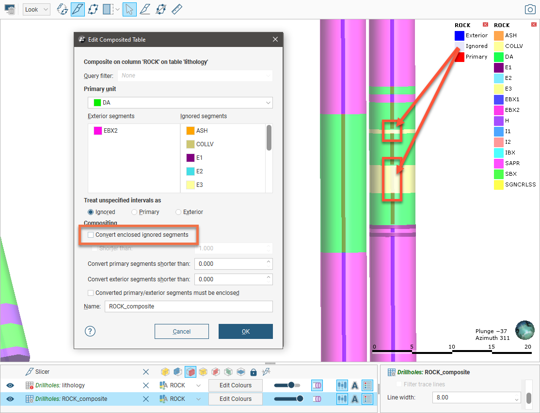

The Convert enclosed ignored segments setting determines how ignored segments are handled when they are flanked by either two interior segments or two exterior segments. If Convert enclosed ignored segments is enabled, Leapfrog Geo will convert enclosed ignored segments to match the surrounding segments. In cases where an ignored segment does not lie between two interior or exterior segments, it will remain ignored.
Where ignored segments are at the end of the drillholes and thus have no primary unit on the other side to enclose them, the ignored segments are not converted:

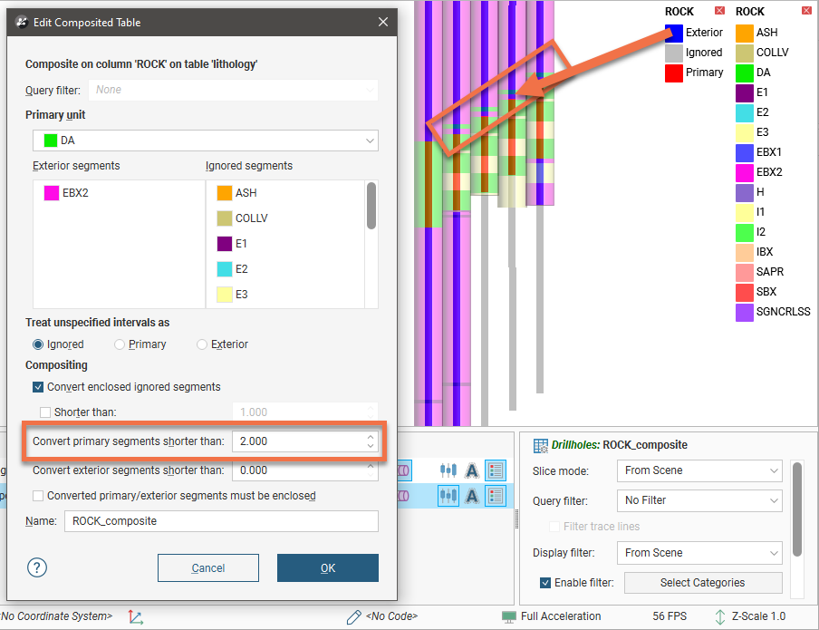

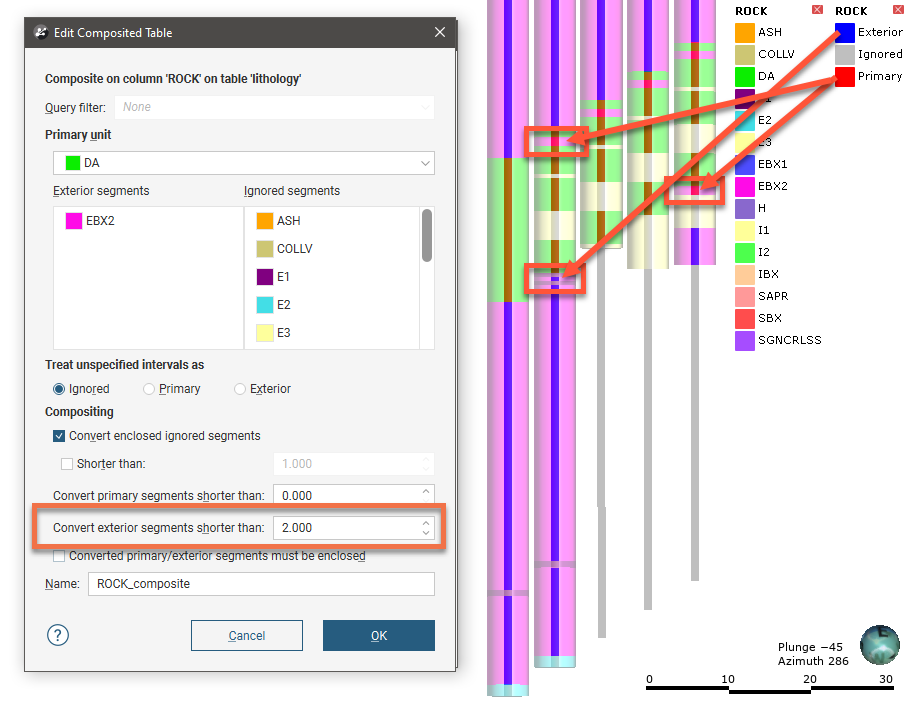

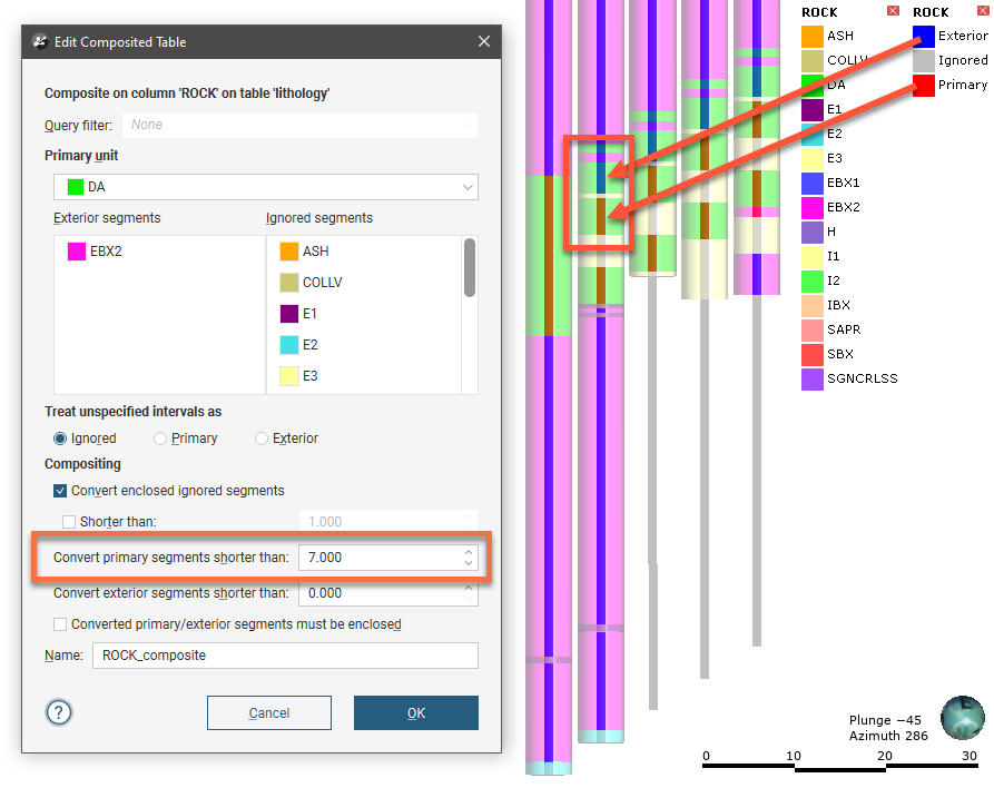

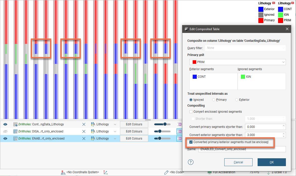

When Convert primary segments shorter than is set to a value, short primary segments adjacent to at least one exterior segment will be converted to an exterior segment.
The Converted primary/exterior segments must be enclosed setting is useful for situations where a primary or exterior segment is bounded on only one side by another segment type. For example, here we have original drilling (in blue, green and red) shown inside composited drillholes. There are eight composited drillholes (highlighted) where exterior segments have been converted into primary segments, despite only being bounded by the primary lithology on from above:

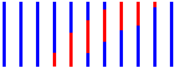

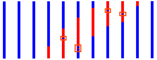

To see how these parameters can smooth the shape of a unit of interest, let’s look at a series of drillholes where we wish to create an intrusion boundary based on the red segments. Short segments are highlighted in the intervals that have not been composited:
