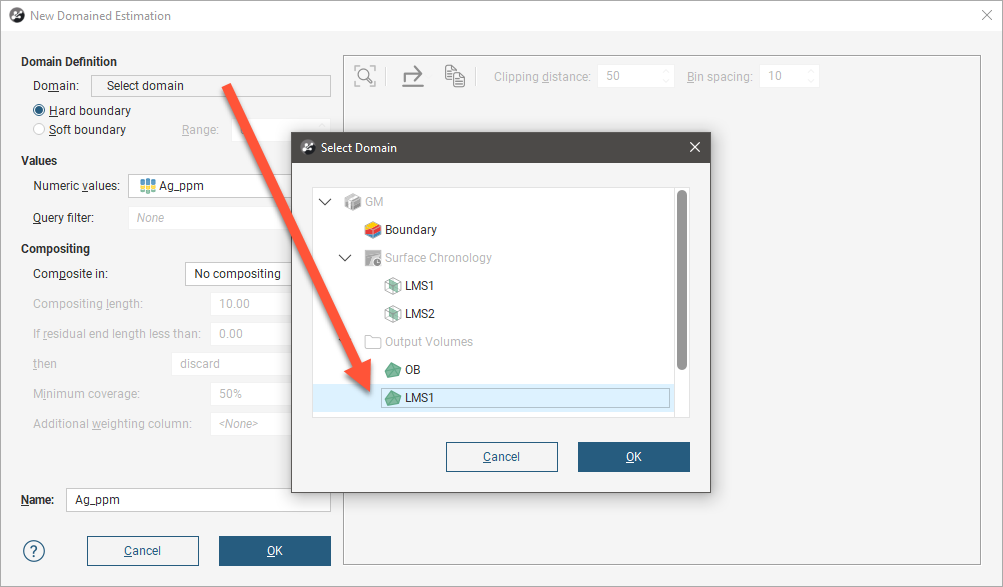

To create a domained estimation, right-click on the Estimation folder and select New Domained Estimation > Single Domained Estimation. The New Domained Estimation window will be displayed:
This window is divided into three parts:
- The domain definition
- The values used in the estimation and how they are composited
- The boundary validation chart
Tools in the window allow you to validate the domain and select whether the boundary should be a hard or soft boundary.
Defining the Domain
Click on the Select domain button to select from the suitable objects available in the project:
Any closed mesh can be selected to be used as the domain, including boundary objects and model volumes.

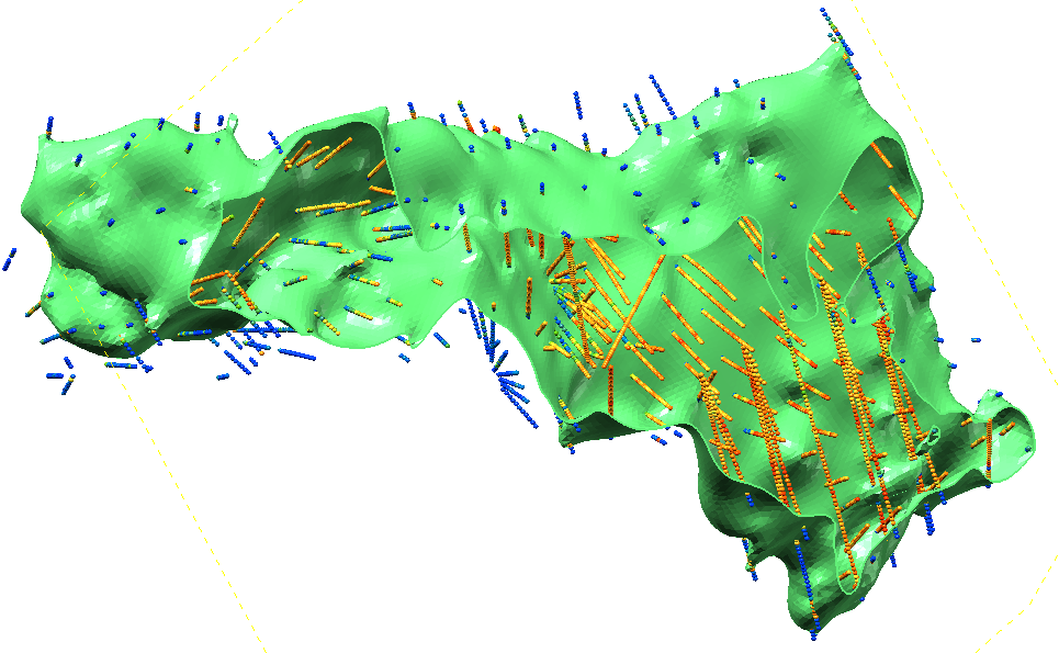

A Hard boundary uses only data within the domain’s boundary. This can be seen when you add an estimation to the scene; the values used do not extend beyond the boundary:
A Soft boundary will also make use of data beyond the domain boundary, up to the distance specified in the Range field. Here, the range is set to 10 and we can see that values outside the boundary are used:
The Soft Boundary option provides the ability to create estimation objects strictly within the selected boundary, but to inform those estimation objects using relevant data immediately adjacent to but beyond the boundary.

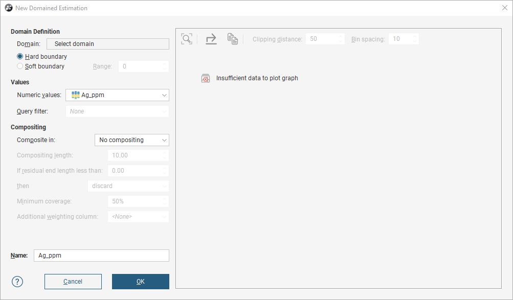

Boundary Validation

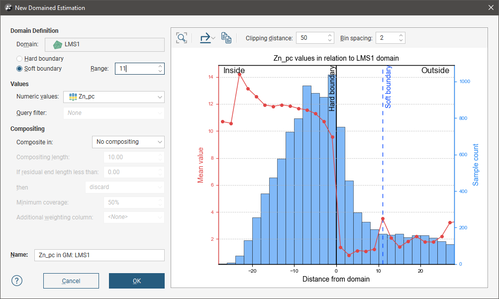

Once you have selected the domain and the values you wish to use and set compositing options, the boundary analysis tools in the New Domained Estimation window help you to determine the best type of boundary to use:
If compositing is enabled for the domained estimation, the boundary validation information displayed is that for the uncomposited data.

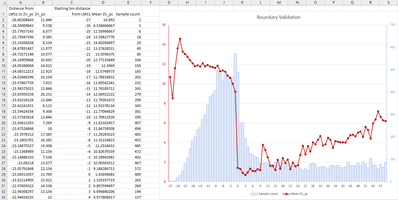

A histogram of the sample count for each bin is included, so you can ignore things like an anomalous spike in mean value associated with a very small sample count. Adjust the size of the horizontal axis bins using the Bin spacing setting.
The pale blue bars show the sample count for each bin, and the red dotted line segment plot shows the mean value for the bin. The position of the Hard boundary is marked with a solid black vertical line. When a Soft boundary is selected, a vertical dotted blue line appears to show what values will be included, based on the Range setting. You can click on the soft boundary line and drag it to adjust the range.
When the mean value line segment plot shows a sharp change at the boundary, a hard boundary may be appropriate. Click on points in the line segment plot to see statistics relating to the selected point.

You can export the graph for use in external reports and other documents. Select the export button () to see two options:
- The Export graph image option saves a PDF, SVG or PNG file of the chart.
- The Export data option saves a CSV file containing the data so it can be reproduced and reformatted in a spreadsheet application.
Alternatively, you can choose the Copy option to save a copy of the graph image to the Windows clipboard for pasting into another application.
Note that when the Export data option is used, it is the last three columns (Starting bin distance from domain, Mean value and Sample count) that are required to reproduce the chart. The first two columns, Distance from domain to value column and the values column contain all the data points required to create a new chart with different bin spacing.

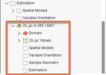

Once you have entered a name for the domained estimation, click OK. The domained estimation will be added to the project tree under the Estimation folder. You can edit its settings by double-clicking on it.
A domained estimation is made up of the following objects:
- The Domain defines the limits of the estimation object. To select another domain, double click on the contaminant estimation and click the Domain button to select a new mesh.
- The points data values object contains all the data used in generating the estimation object. These comprise midpoints for all the value intervals. You can easily change the values used by selecting a different Numeric values column or by applying an optional query filter.
- The Spatial Models folder contains variogram models. Create a variogram model by right-clicking on the Spatial Models folder and selecting New Variogram Model. See Common Variogram Models and Domain-Specific Variogram Models in the Variography and Estimators topic for a description of the difference between the Spatial Models folder in the domained estimation and the Estimation > Spatial Models folder.
- The Variable Orientation folder is used for creating objects that make it possible to re-orient the search and variogram according to local characteristics. See Variable Orientations for more information. See Managing Variable Orientations in a Project in the Variable Orientations topic for a description of the difference between the Variable Orientation folder in the domained estimation and the Estimation > Variable Orientation folder.
- The Sample Geometry folder contains data density functions that can be used when declustering data. See Standard Estimators for more information.
- The Estimators folder contains estimators that can be evaluated onto block models. Estimators are similar to Leapfrog RBF interpolants, with the exception that estimators select and refer to an independently constructed variogram model. See Standard Estimators for more information.

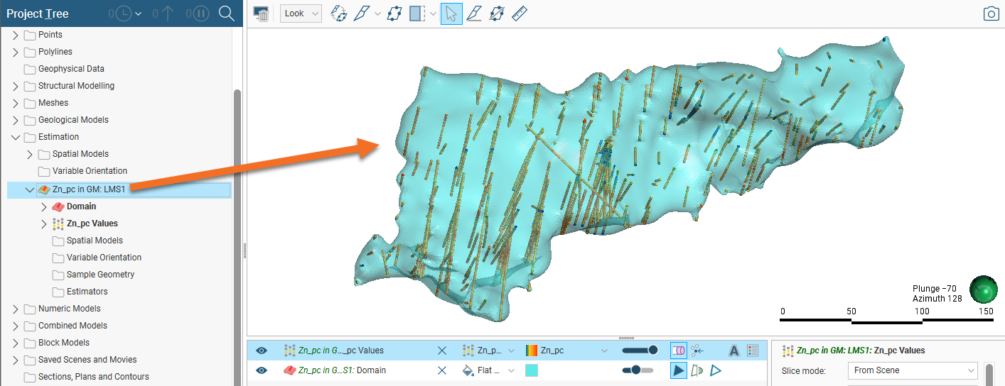

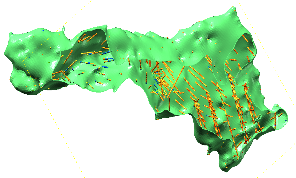

You can view a domained estimation by dragging it into the scene; this adds the Domain and Values objects to the scene.

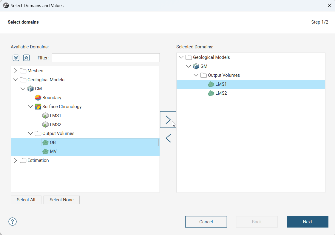

Bulk Creating Domained Estimations
You can also create multiple domained estimations at the same time using the bulk domained estimation creation wizard. Right-click on the Estimation folder and select New Domained Estimation > Bulk Domained Estimation. The New Multi Domained Estimation window will be displayed:
Click on the Add button () to add domains. The Select Domains page of the wizard provides the opportunity to move one or more domains from the Available Domains list to the Selected Domains list. Multi-selections in these lists are permitted. There are Expand all (
) and Contract all (
) buttons and a Filter box to assist in finding the available domains of interest.

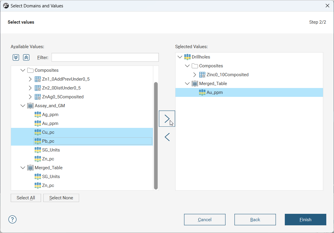

Click Next to Select values. Select and move one or more data columns from the Available Values list to the Selected Values list.
Once you click Finish, a table is displayed that shows all the possible combinations of the selected domains and values. If there are any specific combinations that are not of interest, click on them, then on the Remove button ().
Again, you can select multiple domain/value rows.

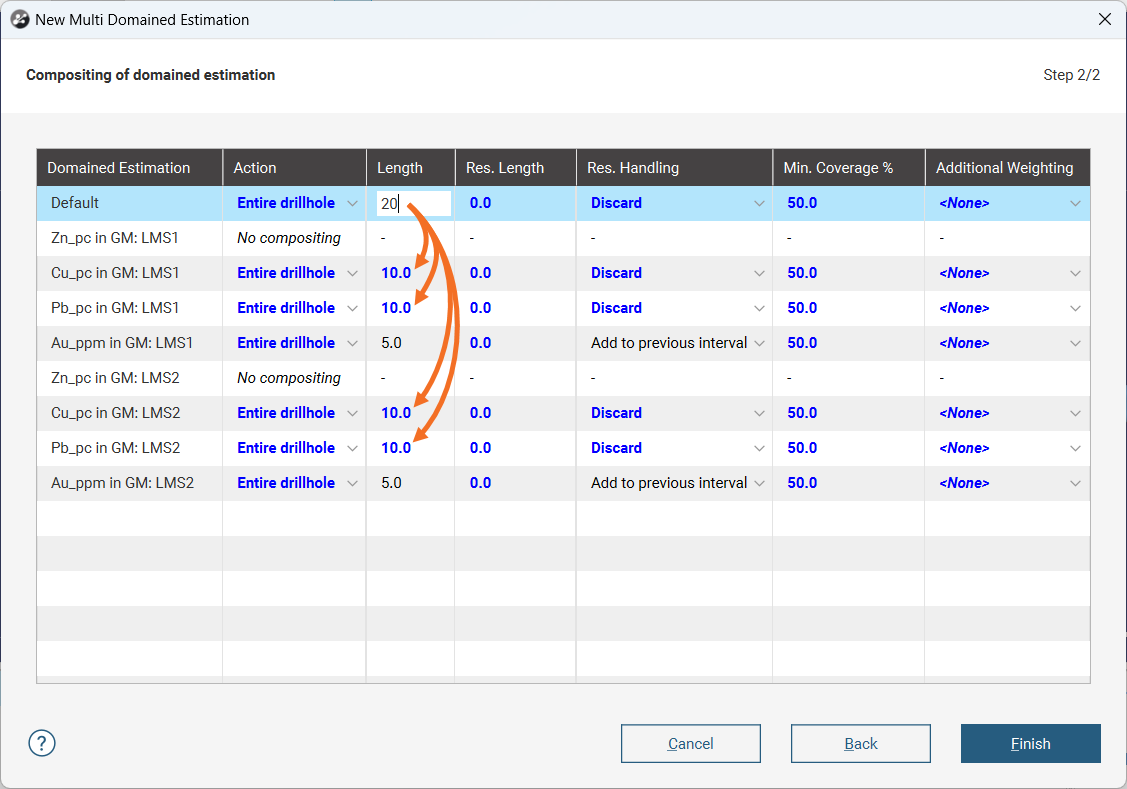

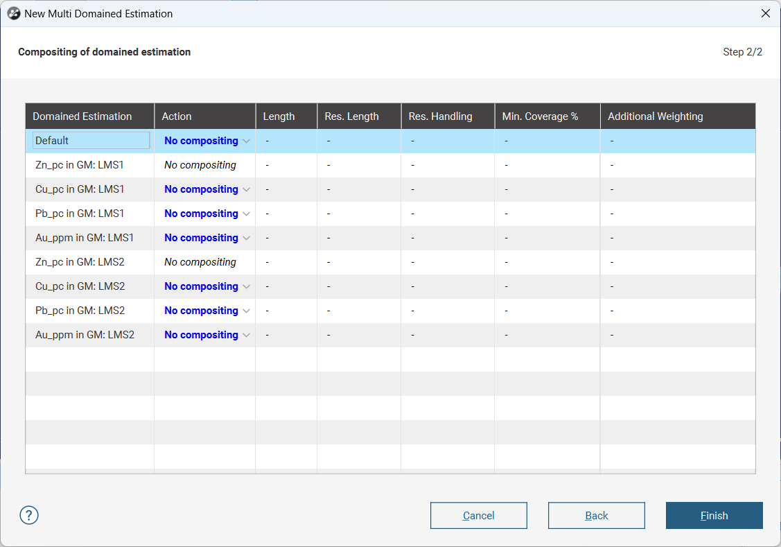

Click Next; you can then set compositing parameters in the Compositing of domained estimation window:
The first row in the table is the Default row, and changing values in this row will affect all rows, unless:
- the value cannot be changed, or
- the value has already been set for that specific row.
You can also set values for each compositing option for each of the individual domained estimation rows.
When you click Finish, all the domained estimations will be created and added to the project tree.

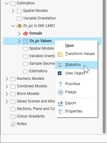

Viewing Statistics

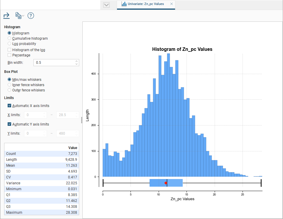

You can view statistics for the values used in the domained estimation by right-clicking on the numeric data object and selecting Statistics:
What happens when Statistics is selected depends on whether or not the data values were composited.
- If the values were composited, a popup window will offer the choice between:
- Univariate Graphs
- Compositing Comparison
- Compositing Interval Lengths
- If the values were not composited, a dockable tab window opens displaying the Univariate histogram of the point values.
For more details on these statistics options, see Analysing Data.
