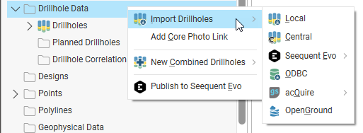

Drilling data forms the basis for creating models in Leapfrog Geo. Import drilling data by right-clicking on the Drillhole Data folder and selecting one of the import options:
Each of these options is discussed in the Importing Drilling Data topic.

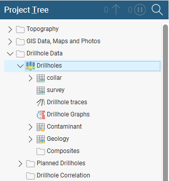

Here, a single drilling dataset made up of a number of tables has been added to the project, stored in the Drillhole Data folder:
Here there are three drilling datasets, M Campaign, MAC Campaign and MV Campaign:

In addition to the imported tables, each drilling dataset has two objects that help in visualising and analysing the data. These are:
- The traces object. See Displaying Drillhole Traces.
- The graphs object. See Displaying Drillhole Graphs.

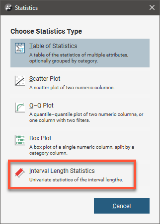

To view statistics on an interval table, right-click on the table in the project tree and select Statistics. The following options are available:
Right-click on a numeric column and select Statistics to open a univariate graph for that column.

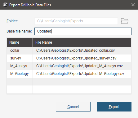

Once you have selected how you wish to export the data, click OK. The Export Drillhole Data Files window will appear:
The list shows the files that will be created, one for each data table. Choose the Folder where the files will be saved, then enter a Base file name, which will be added to the front of each file name. However, a Base file name is not required.
Click Export to save the files.

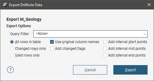

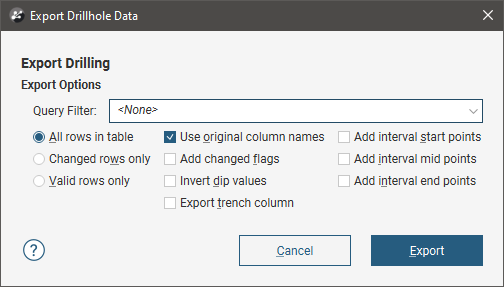

To export a single drilling data table from a drilling dataset, right-click on that table and select Export. The Export Drillhole Data window will appear:
You can select whether the exported file includes all rows, only changed rows or only valid rows. You can also apply a query filter, if any have been defined for the drilling dataset.
Once you have selected how you wish to export the data, click OK. You will be prompted for a filename and location.
