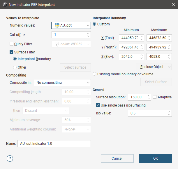

To create an indicator RBF interpolant, right-click on the Numeric Models folder and select New Indicator RBF Interpolant. The New Indicator RBF Interpolant window will be displayed:
The New Indicator RBF Interpolant window is a simpler version of the Edit Indicator RBF Interpolant window. While the Numeric values object selected when the interpolant is created cannot be changed later, all the other settings, and more, can be modified. The edit window also has features to assist value selection, such as a histogram to aid selecting a cut off value. If you are unsure of any setting, accepting the default value Leapfrog Geo proposes is a good option for creating a first-pass indicator interpolant. You can then modify the values in the edit window as you iterate to improve the model.
This window is divided into four parts in which you select the values used to create the interpolant, the interpolant boundary, any compositing options and general interpolant properties.
Selecting the Values Used
In the Values To Interpolate part of the New Indicator RBF Interpolant window, select the values that will be used and choose whether or not to filter the data and use a subset of those values in the interpolant.
You can build an indicator RBF interpolant from either:
- Numeric data contained in imported drilling data.
You cannot change the Values To Interpolate setting once the interpolant has been created.
Setting the Cut Off
The Cut-off value will be used to generate sample points and create two output volumes:
- An Inside volume that encloses all values likely to be above or equal to the Cut-off value.
- An Outside volume that enclose all values likely to be below the Cut-off value.
The probability that the enclosing volume encloses values above the cut-off is set by the Iso value.
If you are unsure of what Cut-off value to use, you can view statistics on the distribution of the data and change the Cut-off value once the interpolant has been created. Double-click on the indicator RBF interpolant in the Numeric Models folder to open the Edit Indicator RBF Interpolant window and switch to the Cut-off tab.
You can also change the names of the Inside and Outside volumes once the interpolant has been created.

Set the Surface resolution for the interpolant, whether or not the resolution is adaptive and whether or not the interpolant uses single-pass isosurfacing. See Surface Resolution in Leapfrog Geo for more information on the effects of these settings. The resolution can be changed once the interpolant has been created, so setting a value in the New Indicator RBF Interpolant window is not vital. A lower value will produce more detail, but calculations will take longer.
An indicator RBF interpolant produces a single isosurface that is used to determine the likelihood of values falling inside or outside of the cut-off threshold. The Iso value can be set to values from 0.1 to 0.9. Clicking the arrows changes the Iso value in steps of 0.1. To use a different value, enter it from the keyboard. Again, this option can be changed once the interpolant has been created, with the added assistance of a values histogram. Double-click on the indicator RBF interpolant in the Numeric Models folder to open the Edit Indicator RBF Interpolant window and switch to the Cut-off tab.

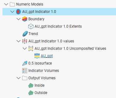

The new interpolant will be created and added to the Numeric Models folder. The new interpolant contains other objects that represent different parts of the interpolant:
- The Trend object describes the trend applied in the interpolant. See Changing the Trend for an Indicator RBF Interpolant.
- The sample grouping object (
) is the inside/outside sample grouping, which is generated by backflagging the indicator calculations on the values used. See Adjusting the Values Used for information on changing settings relating to how the sample points are grouped. - The isosurface is set to the specified Iso value.
- The Indicator Volumes legend defines the colours used to display the volumes.
- The Output Volumes folder contains the Inside and Outside volumes.
Other objects may appear in the project tree under the interpolant as you make changes to it. See Editing an Indicator RBF Interpolant below for more information on the changes you can make.

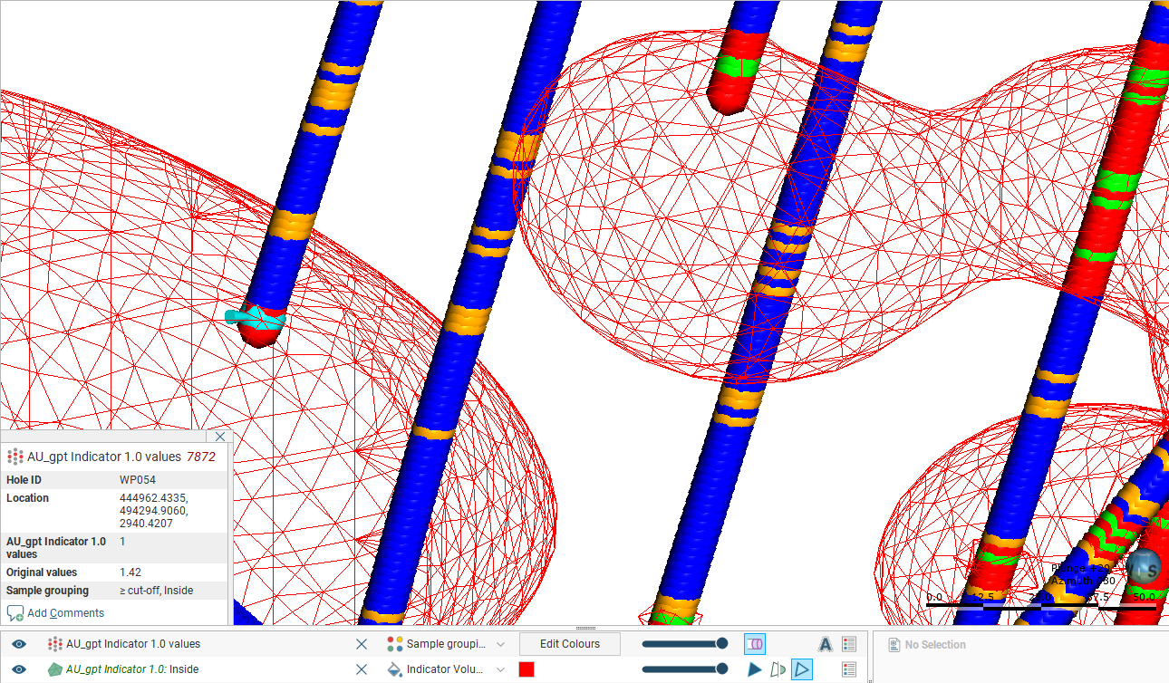

You can also display the sample grouping (
) generated as part of the interpolant, which is useful in making decisions about the Cut-off value and the Iso value:

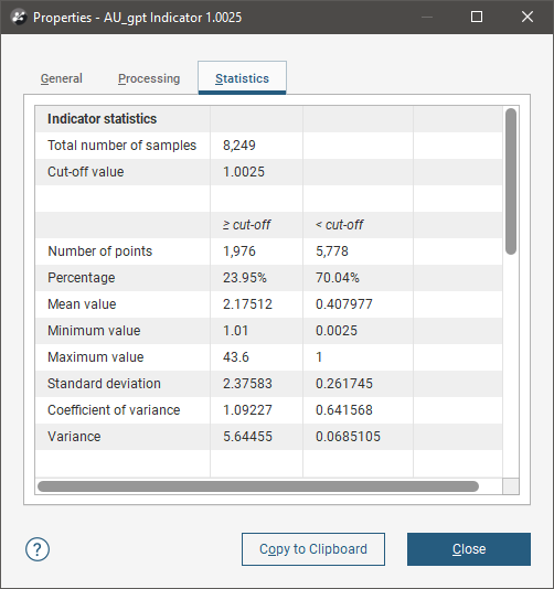

Indicator RBF Interpolant Statistics
You can view the statistics for the indicator RBF interpolant by right-clicking on the interpolant and selecting Statistics. Use the information available to adjust the cut-off value and other interpolant properties:

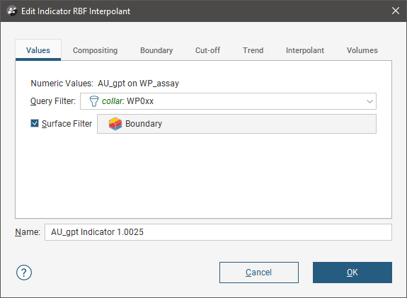

The Values tab in the Edit Indicator RBF Interpolant window shows the values used in creating the interpolant and provides options for filtering the data. You cannot change the values used, but you can filter the values using the Query filter and Surface filter options.

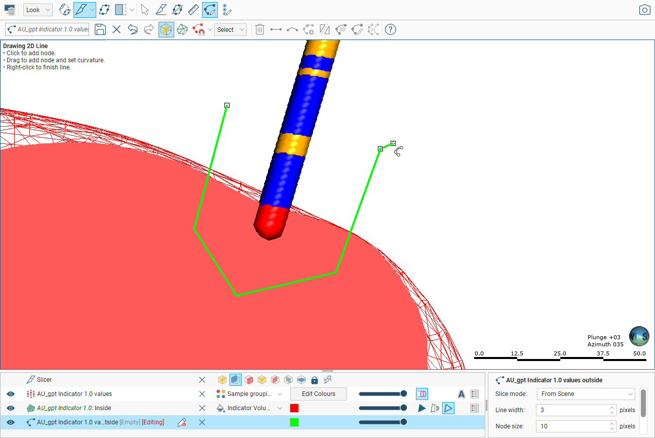

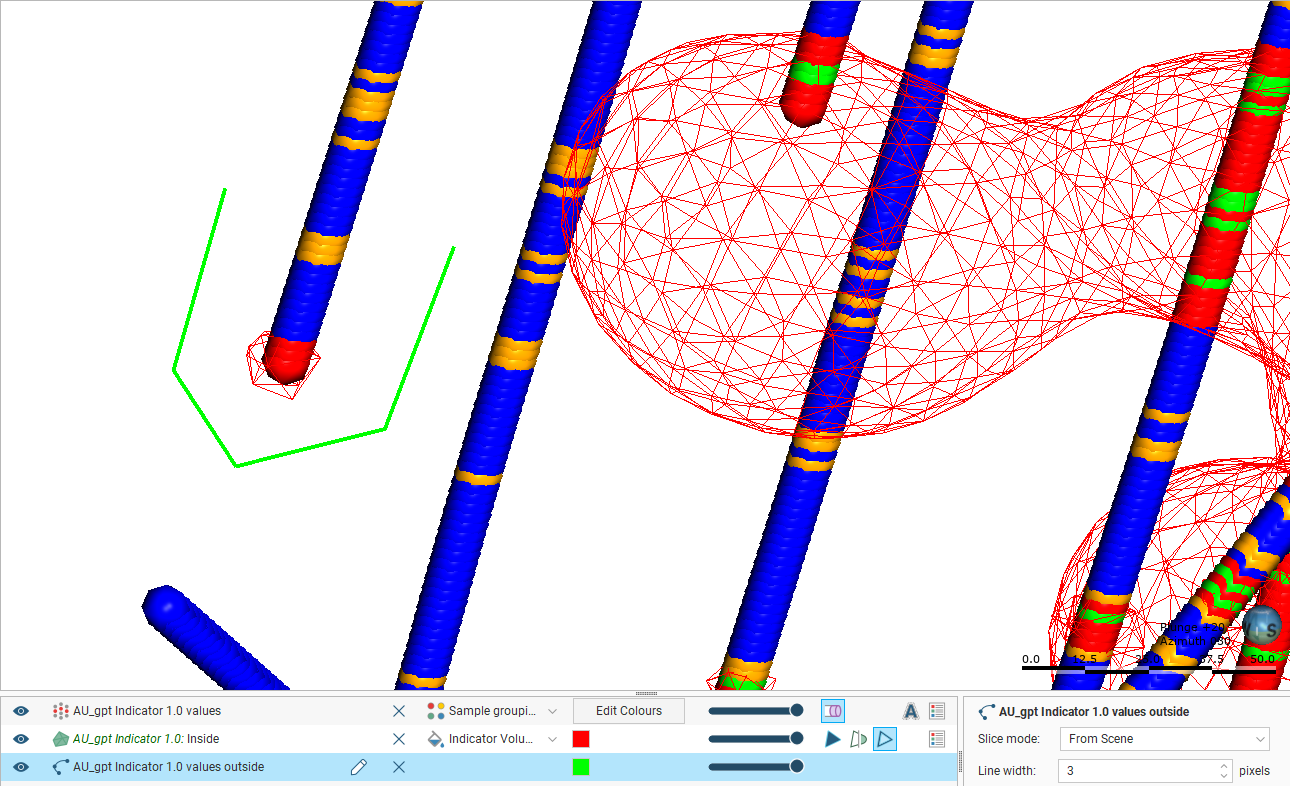

You can adjust the values using contour polylines set to inside (1), outside (0) or to the iso-value. Adding a contour polyline does not affect the indicator’s statistics.

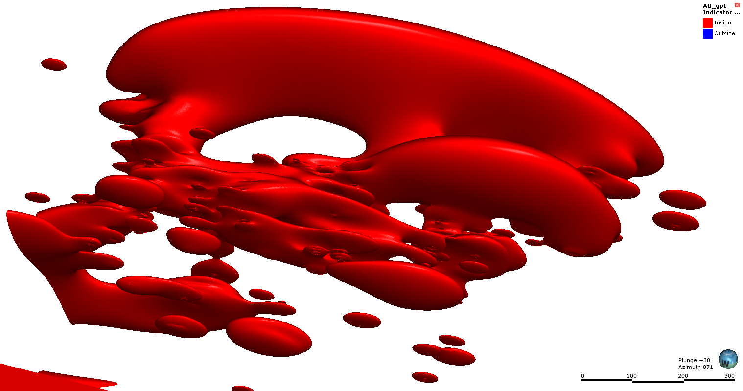

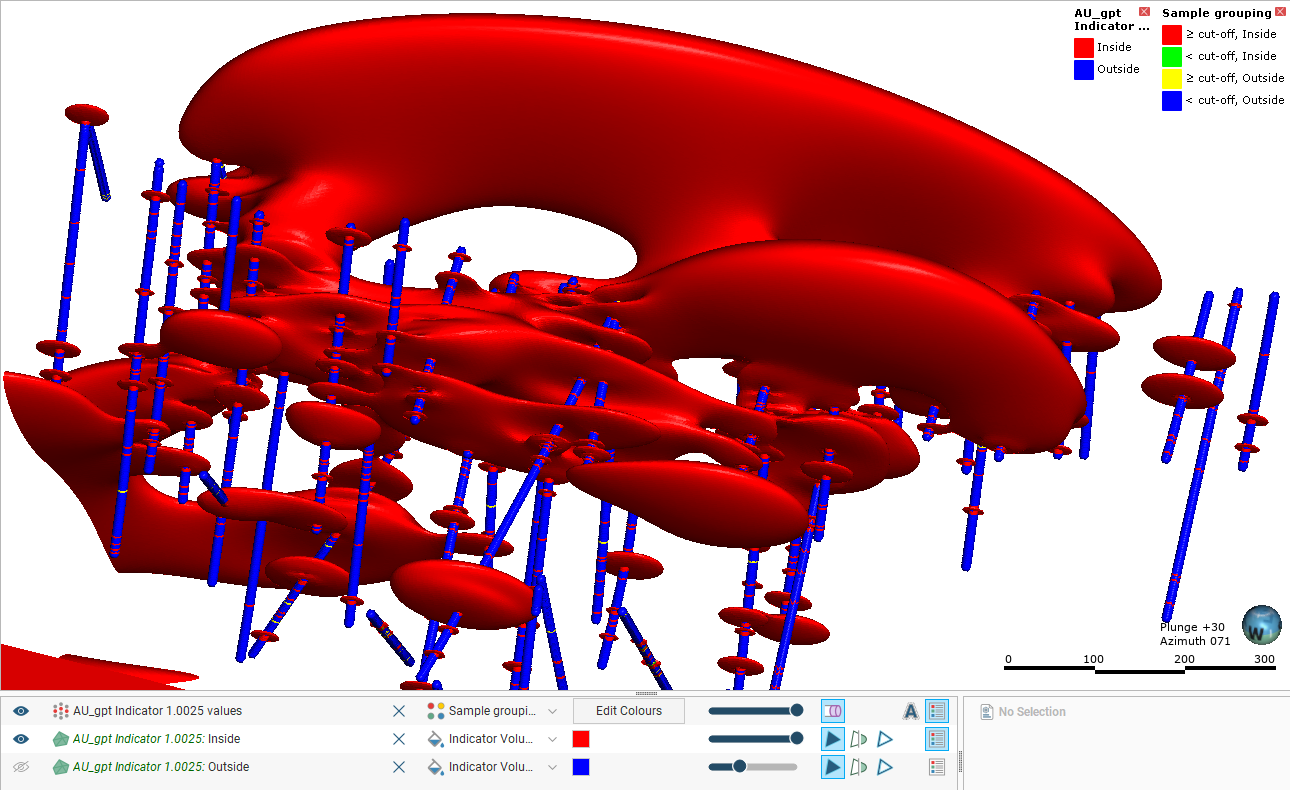

Setting a contour to inside or outside is a useful way of controlling blow-outs. Here, the inside volume occurs in the corner of the model because of the high-value points at the bottom of the drillhole:
This can be adjusted by drawing a contour polyline below the bottom of the drillholes and setting it to the outside value. For example, adding a polyline (in green) below the bottom of drillhole shown above removes the blow-out (the part of the mesh with only the edges shown):

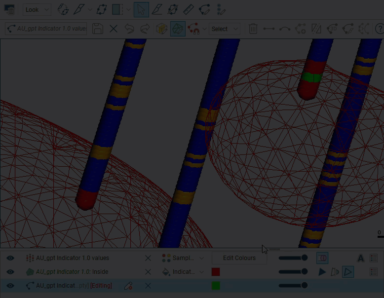

Polylines must be drawn either on the slicer or on an object. Here a slicer has been drawn across the drillhole and the scene repositioned to draw around the end of the drillhole:
Drawing a contour polyline precisely on the drillhole gives Leapfrog Geo conflicting data at the same location, which is why the polyline should be drawn below the drillhole. To draw a polyline below a drillhole without using the slicer, first draw the polyline on the drillhole, then move its nodes so the polyline lies below the drillhole.

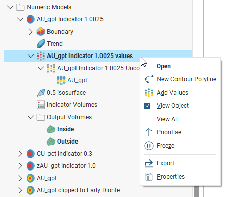

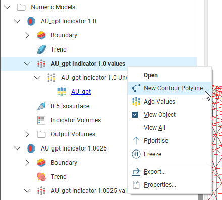

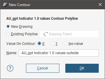

To add a contour polyline, expand the interpolant in the project tree. Right-click on the values object and select New Contour Polyline:
Next, choose whether you will draw a new polyline or use one already in the project, then select the contour value:
Click OK. If you have chosen the New Drawing option, the new object will be created in the project tree and drawing tools will appear in the scene. Start drawing in the scene as described in Using the Polyline Editor. When you have finished drawing, click the Save button (
). The new contour will automatically be added to the interpolant and will appear in the project tree as part of the interpolant’s values object.
To edit the polyline, right-click on it and select Edit Polyline or add it to the scene and click the Edit button (
) in the shape list. If you wish to remove a contour polyline from the interpolant, right-click on it in the project tree and select Delete or Remove.
You cannot change the value on the contour once it has been created. You can, however, share the polyline and use it to create a new contour polyline. To do this, right-click on it in the project tree and select Share. The polyline will then be added to the Polylines folder and can be used elsewhere in the project.

Query and surface filters can be changed by double-clicking on the interpolant in the project tree, then clicking on the Values tab.
Available filters will be listed in the Query Filter dropdown, building the indicator RBF interpolant from a subset of the available values data.
The Surface filter is enabled by default, with the default selection being the indicator RBF interpolant boundary. You can disable the surface filter to use all the data available, or you can select a different volume from the dropdown list to constrain the data influencing the indicator RBF interpolant. To modify the interpolant’s own boundary, switch to the Boundary tab.

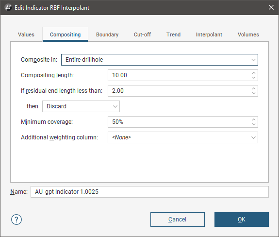

When an indicator RBF interpolant has been created from values that have not been composited, compositing parameters can be changed by double-clicking on the interpolant in the project tree, then clicking on the Compositing tab.
The Compositing tab will only appear for interpolants created from drilling data that has not been composited.
You can composite in the entire drillhole or only where the data falls inside the interpolant boundary. See Numeric Composites for more information on the effects of the Compositing length, For end lengths less than and Minimum coverage settings.

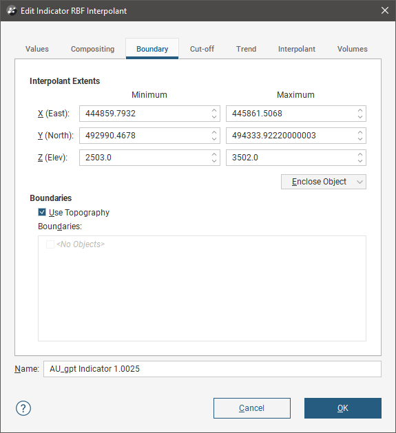

To change an indicator RBF interpolant’s boundary, double-click on the interpolant in the project tree, then click on the Boundary tab:
Techniques for creating lateral extents for indicator RBF interpolants are the same as those for RBF interpolants. See Modifying an RBF Interpolant’s Boundary With Lateral Extents for more information.

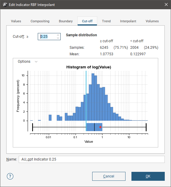

The Cut-off value is the value you would like to model. If you would like to visualise a shell representing values greater than 2.5, you would enter a value of 2.5 as the Cut-off value. This will be used to determine whether input values are treated as 0 or 1, waste or mineral. Another important consideration in visualising an indicator interpolant surface is the Iso value, which sets the probability you would like to maintain for the indicator interpolant isosurface. See Indicator RBF Interpolant Surfacing and Volume Options for more information.
To change the Cut-off value for an indicator RBF interpolant, double-click on the interpolant in the project tree, then click on the Cut-off tab. The tab also shows the distribution of the data used to create an indicator interpolant:
Adjust the Cut-off value, if required, and click OK to process the changes.

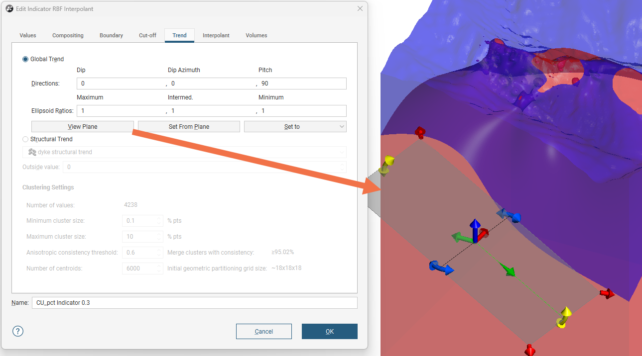

Using a Global Trend
The easiest way to change the trend applied to an interpolant is using a global trend set from the moving plane.
Click View Plane to add the moving plane to the scene, then click on the plane to view its controls. You may need to hide part of the interpolant to click on the moving plane:
You can also use the Set to list to choose different options Leapfrog Geo has generated based on the data used to build the interpolant. Isotropic is the default option used when the interpolant is created.
Click OK to regenerate the interpolant and view changes.

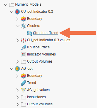

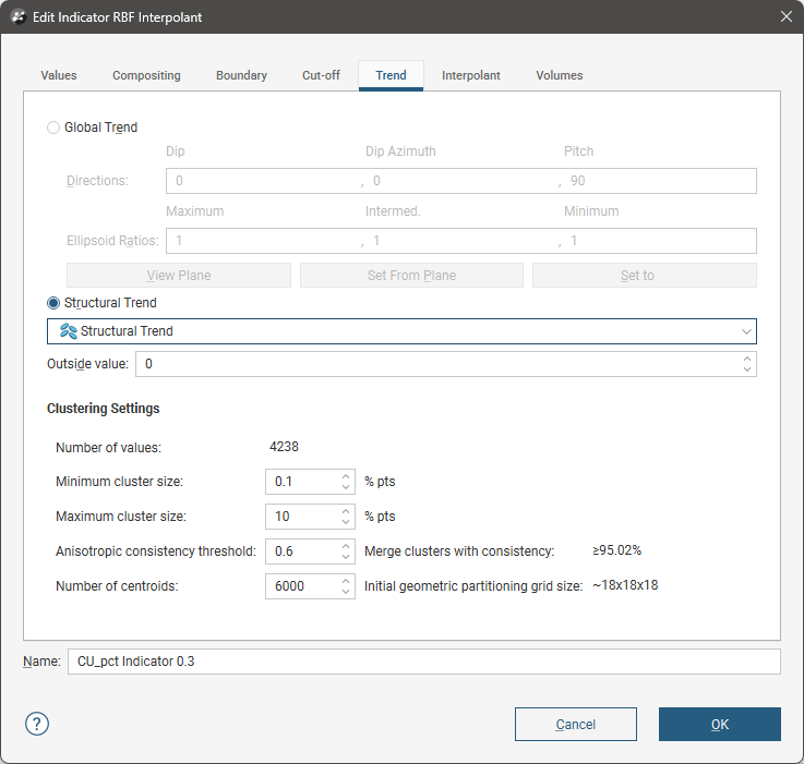

You can also set the trend for an indicator RBF interpolant from a structural trend. First, you must create or import the required mesh and create a structural trend.
Once the structural trend has been created, add it to the interpolant by double-clicking on the interpolant in the project tree, then clicking on the Trend tab. Select the Structural Trend option, then select the required trend from the list:
Outside value represents a baseline value, the expected ambient value of the surrounding region. The Outside value is factored into the interpolation algorithm and lowers the interpolated value in the areas away from the known data points. The blending with outside value is very steep. To increase the projection area outside of the area with data the Outside value can be increased to a value just below the cut-off value.
Once you have selected a structural trend, you can adjust the clustering settings. For more detailed information For more detailed information, see the Building a Structural Trend and Clustering Settings and Visualisation topics.
Click OK. The trend will be added to the interpolant and will appear as part of the interpolant, as shown:

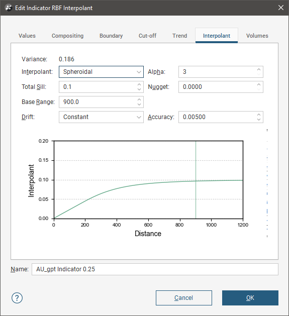

To adjust interpolation parameters for an indicator RBF interpolant, double-click on the interpolant in the project tree, then click on the Interpolant tab:

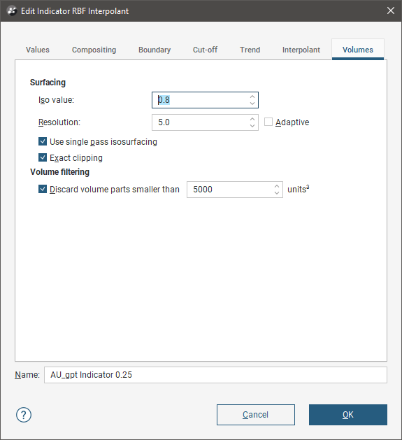

To change the properties of the isosurface for an indicator RBF interpolant, double-click on the interpolant in the project tree, then click on the Volumes tab:
An alternative to double-clicking on the interpolant is to double-click on one of the output volumes, which opens the Edit Indicator RBF Interpolant window with the Volumes tab displayed.
The Iso value can be set to values from 0.1 to 0.9. Clicking the arrows changes the Iso value in steps of 0.1. To use a different value, enter it from the keyboard. The indicator interpolant is a probabilistic numeric model, and the Iso value is the confidence you want to use, the probability that the indicator interpolant shell contains the Cut-off value. A value of 0.1 means there is a 10% confidence, and this will result in a surface that definitely contains the mineralisation, but also will include a lot of waste. Choosing a value of 0.9 means a confidence of 90%, meaning that you almost definitely have just mineralisation inside the isosurface, depicted as a much smaller enclosing volume. However a lot of mineralisation will not be captured and will be treated as being on the ‘outside’, or waste; to achieve a confidence level of 90%, intervals are excluded that are lower probability due to high-grade material being blocked by lower grade material. Mid-range values for Iso value should therefore be preferred in most cases, rather than values at the extreme limits.
Setting a lower value for Resolution will produce more detail, but calculations can take longer. See Surface Resolution in Leapfrog Geo for more information.
Leapfrog Geo uses single pass isosurfacing by default as the accuracy of the mesh is typically adequate with a single pass. Double-pass mesh generation can result in higher accuracy in some situations, but there are tradeoffs. See Single Pass Isosurfacing in the Surface Resolution in Leapfrog Geo topic for more information on this option.
Use Volume filtering to discard smaller parts of the volumes in which you do not wish to carry out further processing. For example, this interpolant has numerous small volumes:
Enabling Volume filtering removes the smaller parts:
