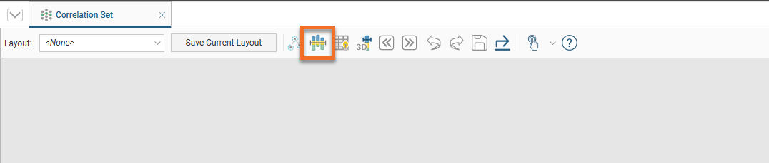

To start, add the collars you wish to work with to the scene. Next, right-click on the Drillhole Correlation folder and select New Correlation. The new set will be created and opened, but is empty until you select collars. Click on the Select Collars button (
) in the correlation set toolbar.

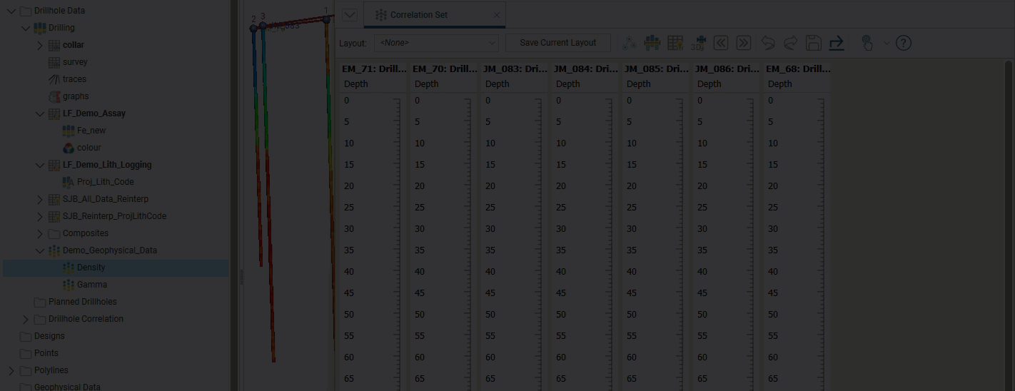

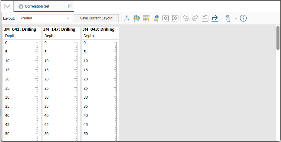

Once you have selected the required collars, click the Save button (
). The selected collars will be added to the correlation set window:
Remove collars from the correlation set by either editing the set in the scene, as described in Creating a Correlation Set above, or right-click on a collar header and select Remove collar:
Add data columns you want displayed for each drillhole by dragging-and-dropping data columns from the project tree somewhere onto a drillhole panel. Depending on whether the data is category or numeric, hex colour, interval or points data, the default appearance of the data column will be set appropriately. This visual formatting can be adjusted to suit your preference or internal standards, as described in Display Options and Formatting the Correlation Set.

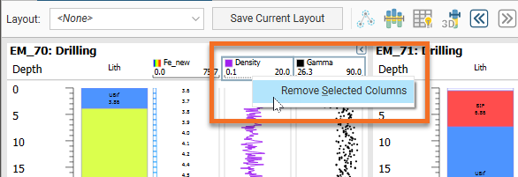

You can remove data columns from the drillholes by right-clicking on a column header, then selecting Remove. Multiple columns can be removed in a single action by holding Ctrl while clicking on the column headers, then clicking on Remove selected columns.

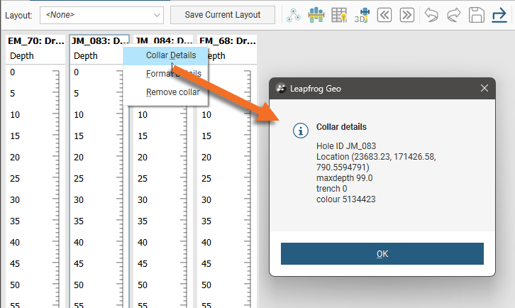

Viewing and Formating Collar Details
Collar metadata is available by right-clicking on a drillhole collar header and selecting Collar details.
The collar header can be customised using combinations of static labels and variables. Right-click on the existing collar header and select Format details. The Format Collar Details window has a Label editor where the default label can be customised and replaced. Type in the Label editor to add text that will be included in all the collar headers, and select from the Insert Column list to add a variable that will contain metadata specific to the drillhole collar. Some variables may also show Properties to the right that can be adjusted when selected in the Label editor.
Click on Close to save your changes, or Revert to discard them. Click on the Clear button (
) to delete the contents of the Label editor and restore the default label of holeid: Drillholes.
See Formatting Text Displayed in the 3D Scene topic for more information on how to use the text formatting dialog.

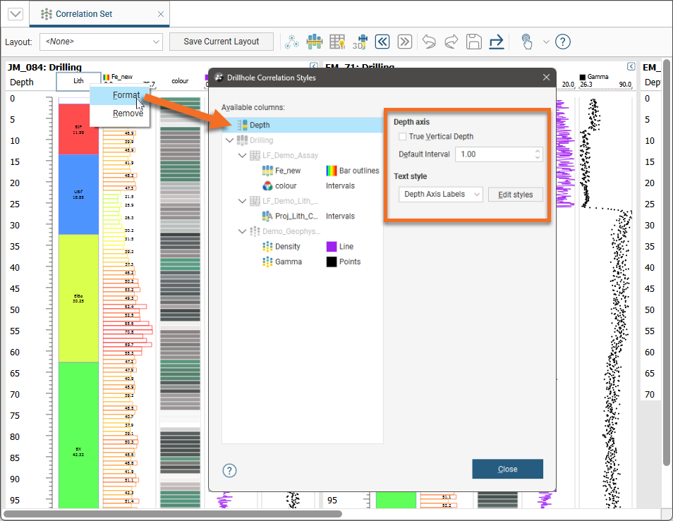

Correlation Set Depth View Options
Customise the depth scale by right-clicking on Depth or TVD and selecting Format. The tick interval can be adjusted by changing Default Interval, and the Text style can be changed by selecting one of the named text styles and/or clicking the Edit styles button where the font, point size and colour can be specified, along with whether or not the text should be bold or italic.
It is also possible to tick the True Vertical Depth box to change the depth scale from downhole distance to true vertical depth. When selected, the Depth label is changed to TVD, and the borehole data is referenced to the z-height. In conjunction with the Elevate Collars feature, this may be especially useful with drillholes with significantly different dip angles.
Constrain a drillhole or the entire correlation set to a depth of interest by setting the depth filter. Right-click on Depth or TVD for a drillhole and select Filter. In the Depth Filter window, specify the From and To depth constraints. If Apply to all is unticked, the changes will only apply to the drillhole selected when Depth or TVD was right-clicked. If Apply to all is ticked, the depth filter will affect all drillholes in the correlation set. Any drillhole with a depth filter applied will have a filter indicator (
) above the scale.

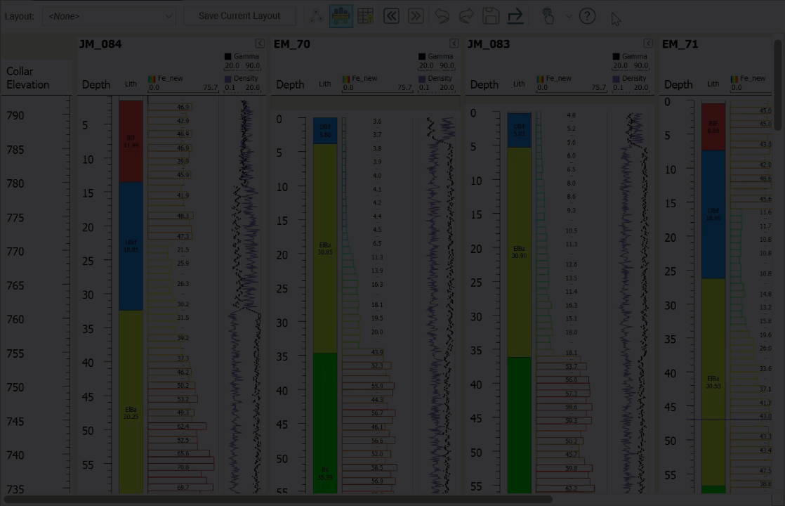

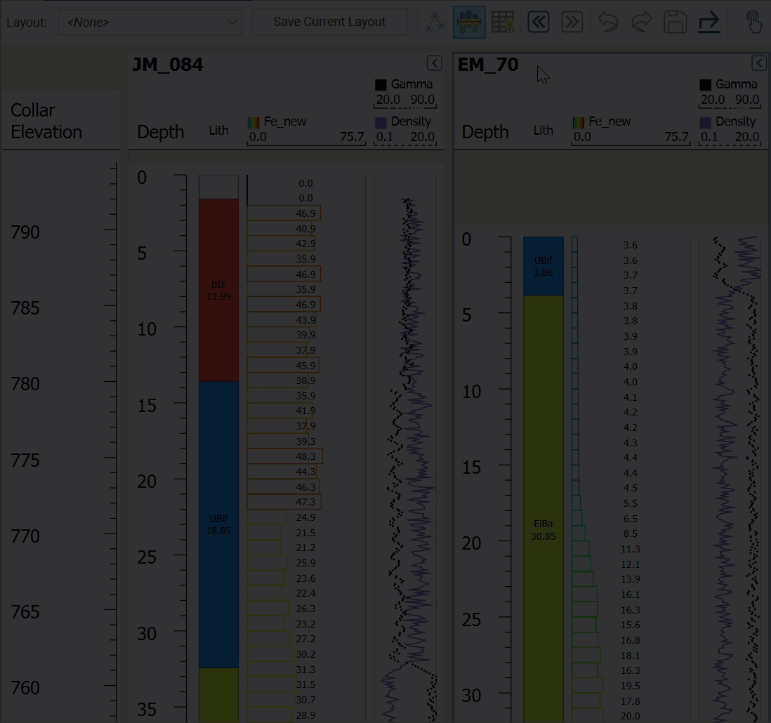

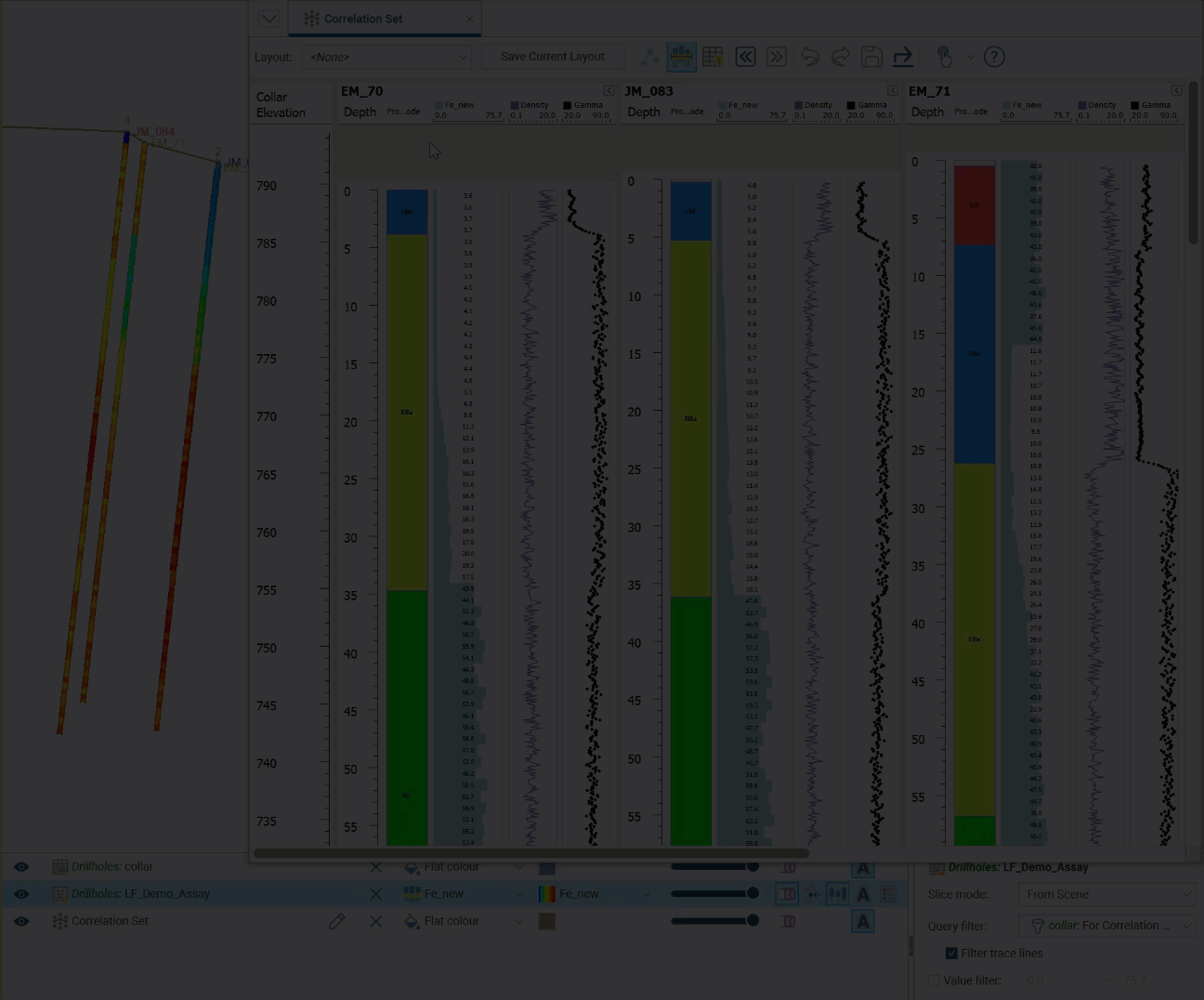

Adding a Collar Elevation Scale
Correlating data is harder when the topography is not flat and the drillhole collars are at different elevations, unless the starting points for each drillhole are adjusted to be relative. Click the Elevate Collars button (
). This sets collars to their z-height and adds a Collar Elevation scale to the lefthand side of the correlation set.
Click the Elevate Collars button again to reset the depth scales so they are not relative.

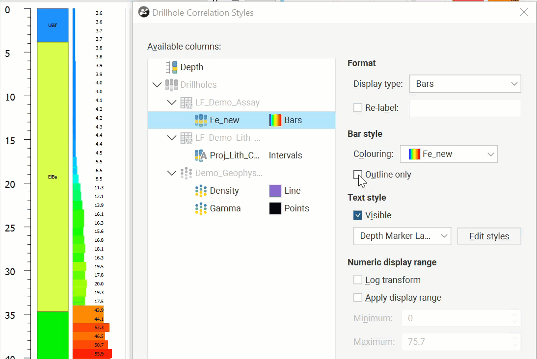

Styling How Data is Displayed
The columns in the correlation set can be formatted and styled to present the data in a manner that suits your analysis and presentation needs. Right-clicking any column header and selecting Format will open the Drillhole Correlation Styles window. Position this window so you can see the correlation set, as style changes made in this window are updated immediately in the correlation set.
Each of the displayed columns is shown in the Available columns list and when a column is selected, formatting and styling options appear on the right side of the window, specific to the type of column data selected.

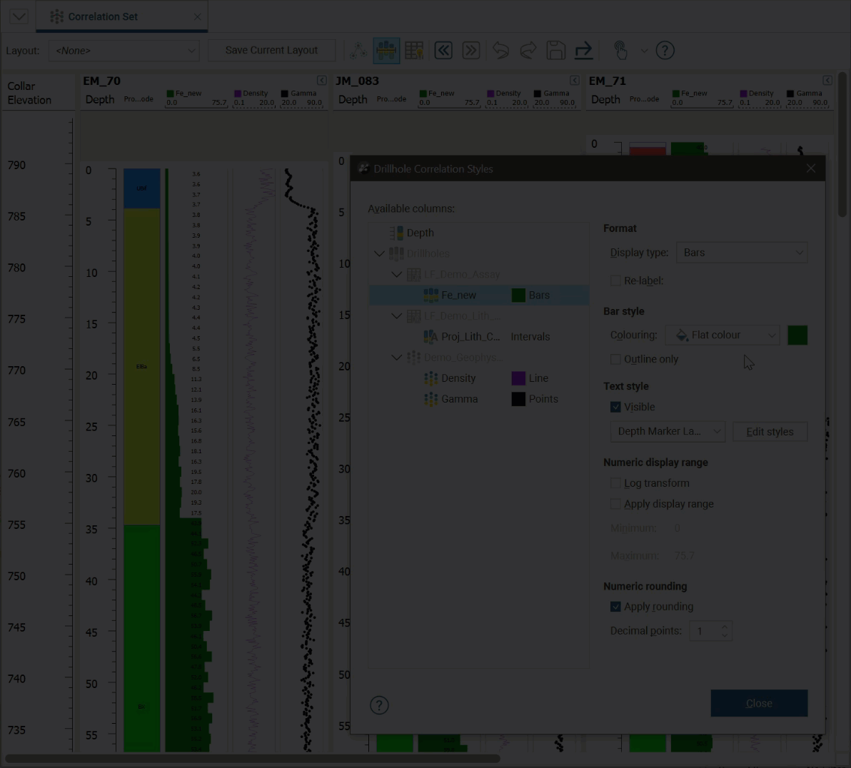

Under the Format heading, the Display type provides options for displaying data as Bars, a Line, Points or Midpoints or Intervals. Available options will be limited by the selected data type.
When Bars are selected for the Display type, the Bar Style section provides styling options for the bar chart. The Colouring can be specified as a Flat colour and a specific colour selected by clicking on the colour chip, or an available colourmap can be selected from the dropdown list. Colourmaps are not defined or managed within the Drillhole Correlation Styles window; the available colourmaps match those defined for the data column when added to the scene. If necessary, add a new colourmap from the shape list.
Tick Outline only to change the bar style from bars filled with colour to bars with a coloured outline and a white fill. Note that when Outline only is enabled, where the edges of two bars are adjacent the colour of the bar with the higher value is used.

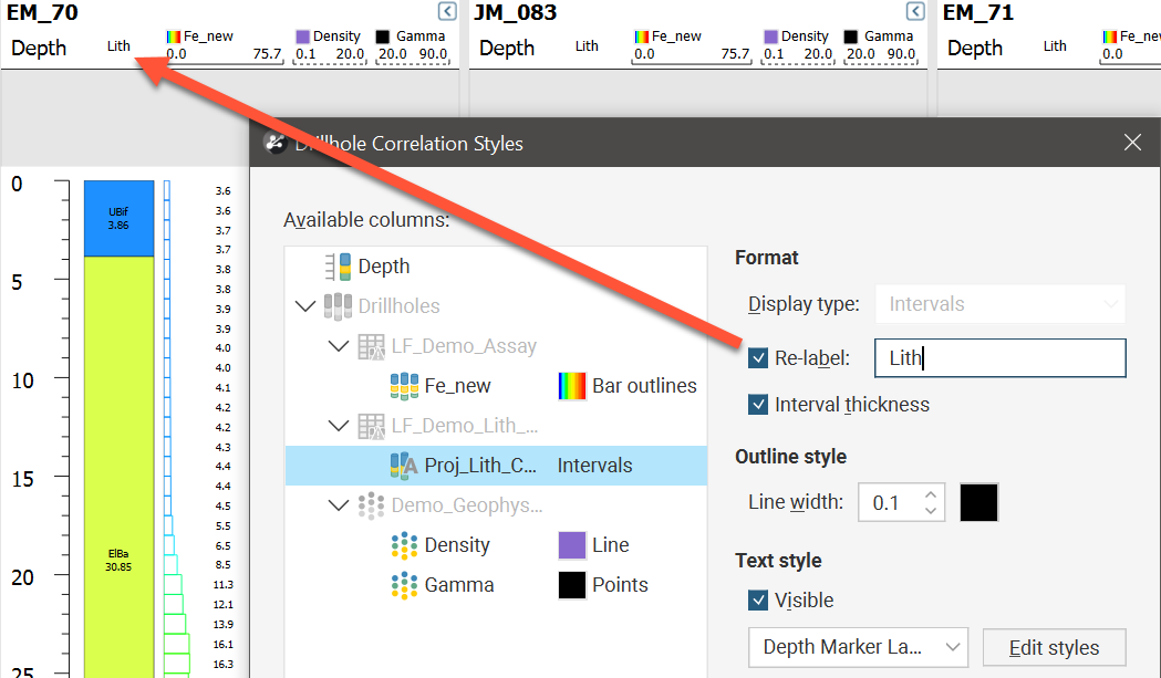

Change the default data column header label by ticking Re-label and providing a new header label.

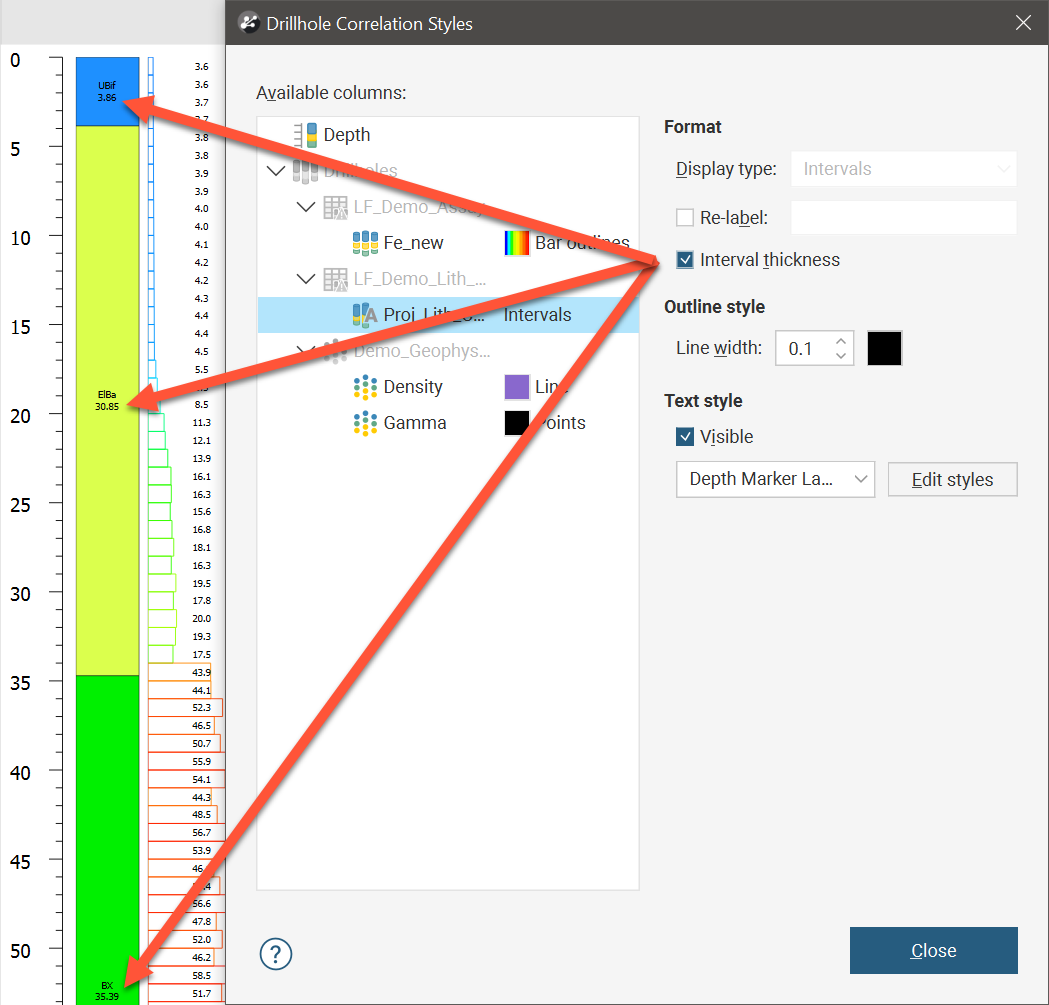

When the Display type is Intervals, there is an option to show Interval thickness. This will add the thickness dimension to the interval label for each interval.
Numeric data columns have Numeric display range options. You can constrain the plot axis by ticking Apply display range and specifying a Minimum and Maximum for the axis. You can also adjust from a linear scale for the axis to a log scale by ticking the Log transform box. Note the styling of the axis line under the column header indicates the type of axis:
- A solid line indicates a linear axis with a range that represents the full scale of the data values in the column.
- A regular dotted line indicates a linear axis with a restricted range.
- A dotted line with varying dot lengths indicates a log axis.
You may choose to round data values shown in the correlation set for numeric data columns. Tick Apply rounding and specify how many Decimal points to show.
It is possible to overlay numeric data plots. Click-and-drag a column header and drop it on top of another column header, and both sets of data will be plotted together, with adjacent axes above. Note that it is not possible to display category data on top of other category data.
The styles used to display columns can be used by other sets in the project and can be exported to other projects. See Managing Layouts and Styles below.

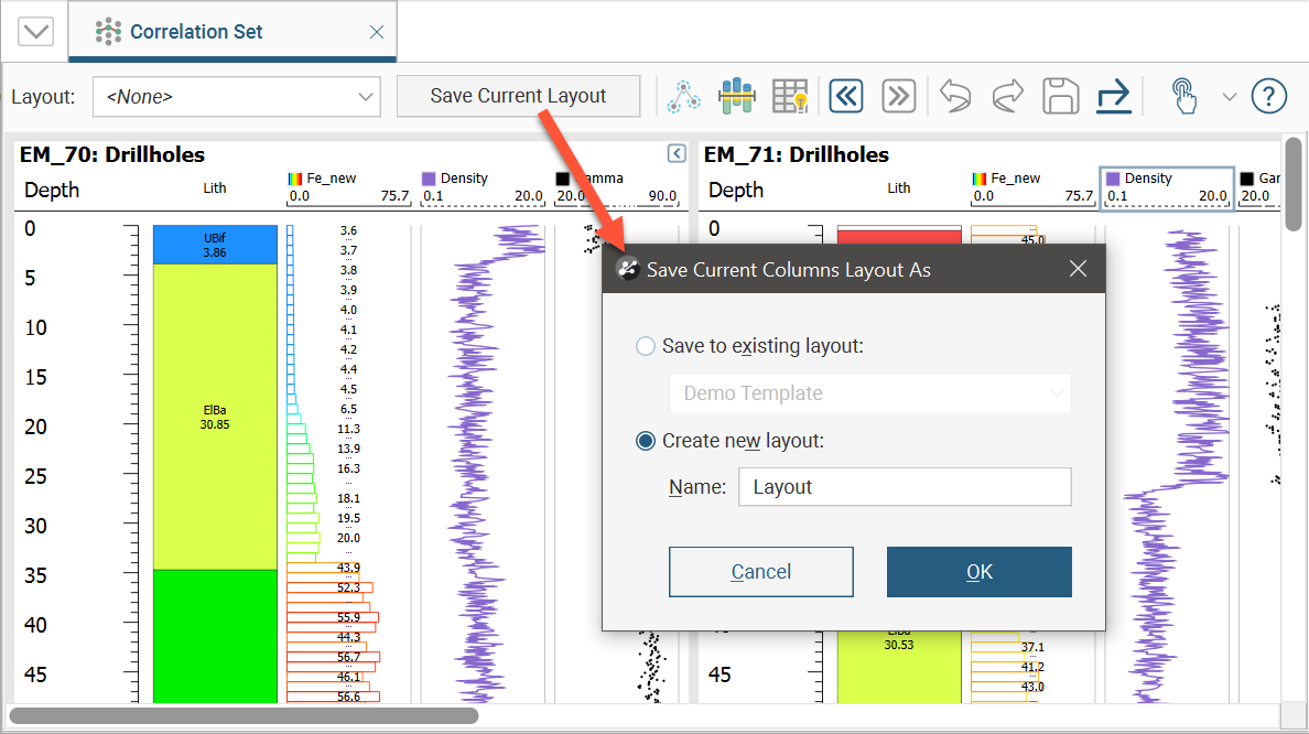

Correlation Column Layouts
Once you have formatted and styled a correlation set, you can save this styling as a layout that can be applied to other correlation sets. Click on the Save Current Layout button in the toolbar, then either select Save to existing layout and select an existing layout to overwrite, or select Create new layout and provide a Name for the layout.
Layouts can be applied to a correlation set by selecting one of the existing options from the Layout dropdown list.

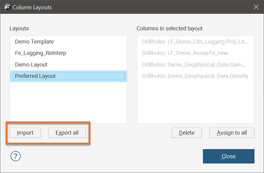

To manage correlation set layouts, right-click on Drillhole Correlation in the project tree and select Layout Manager. Here a layout can be selected and re-used for all correlation sets in the project by clicking the Assign to all button. The Column Layouts window also provides the option to Delete a selected layout.
To re-use the correlation set layouts in other projects, click the Export All button and provide a filename.
In another project where the correlation set layouts are to be re-used, right-click on Drillhole Correlation in the project tree. Select Layout Manager and click the Import button.
The Column Layouts window will be updated and a informational dialog will let you know how many layouts were imported from the file.
You can then select an imported layout to Assign to all correlation sets or open individual correlation sets and change the Layout to suit from the available options.

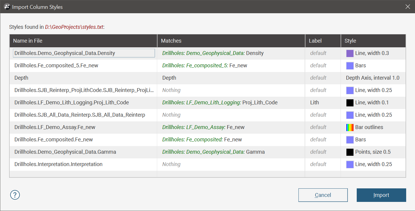

It is also possible to export and import the column styles being used within correlation set layouts. Right-click on Drillhole Correlation in the project tree and click Export Column Styles. You will be prompted to provide a file name for the exported file.
In a project where you wish to re-use column styles from another project, right-click on Drillhole Correlation in the project tree and click Import Column Styles. Select the file to import and the Import Column Styles window will open.
This window will indicate which of the styles in the imported file Leapfrog can automatically match with columns in the currently open project. There is no option to make assignments of column styles to unmatched columns in the project. Click Import to assign the column styles to the matched columns.

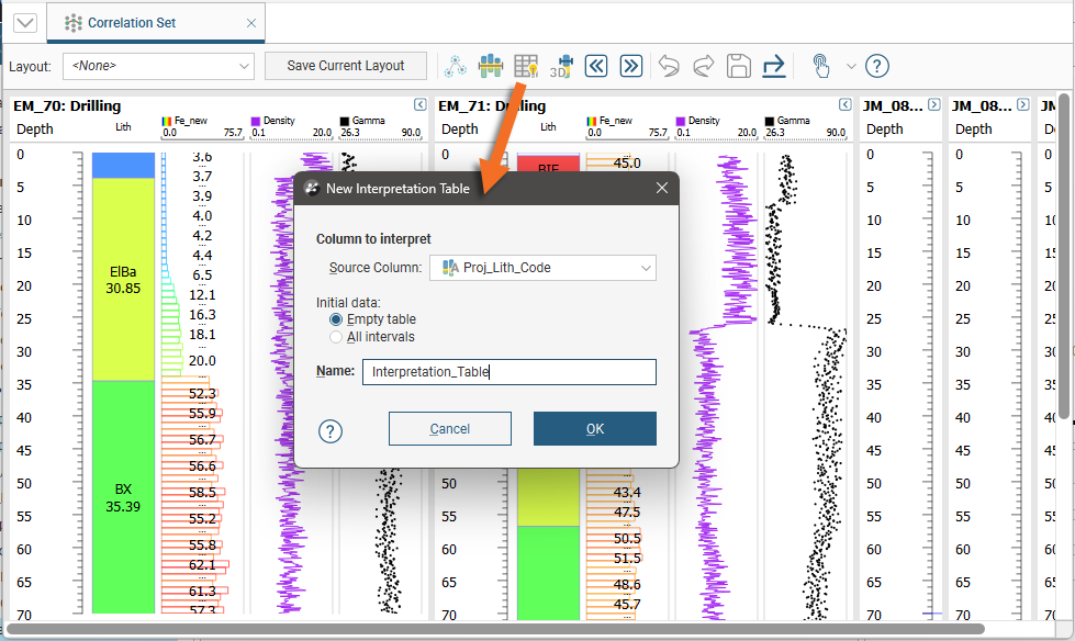

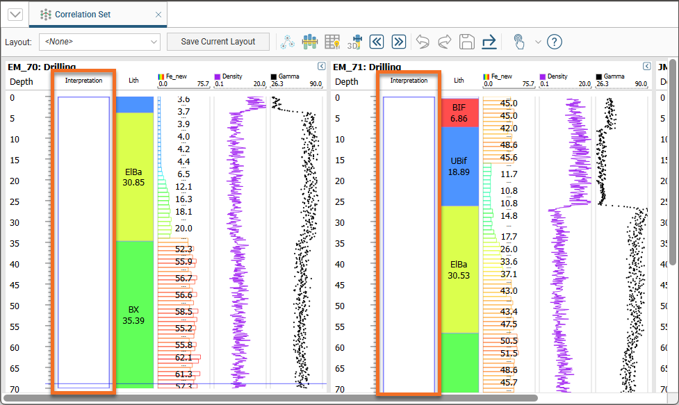

Interpretation Tables
- Create the table without using a base table. Each drillhole will have an empty legend and a single empty interval from 0 to its maximum depth. Select <None> for the Source Column.
Click OK to create the table. A new interpretation table will be added to the project tree in the selected drilling dataset and the column will be added to the correlation set window:

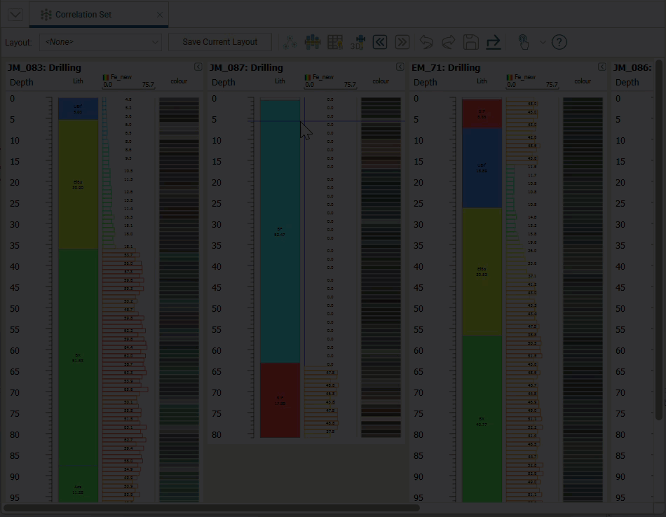

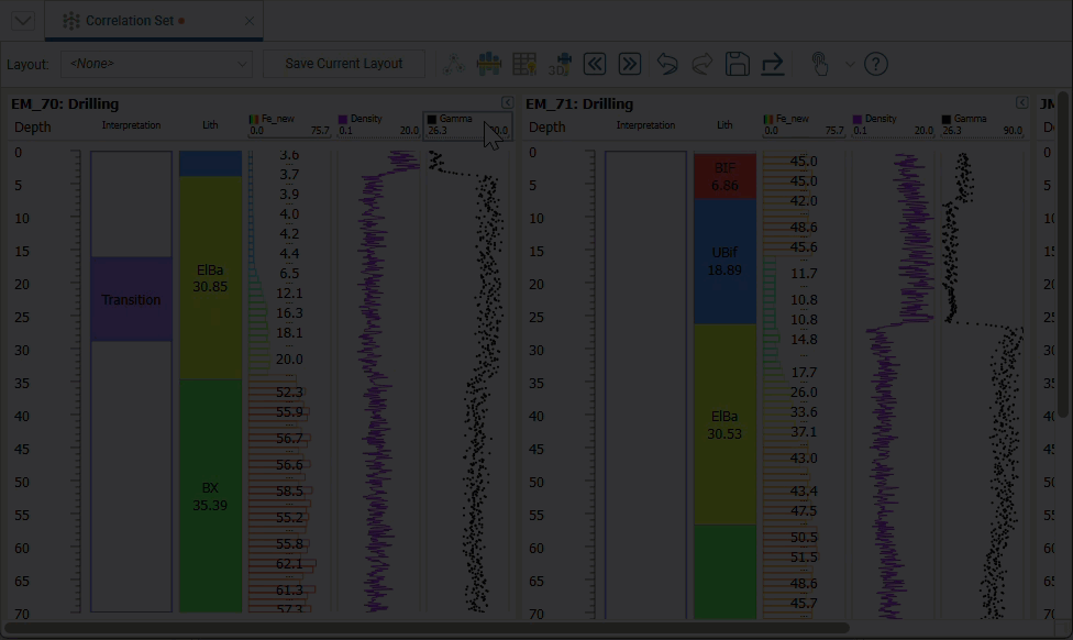

Assigning Lithologies
In the correlation set window, the blue line that appears as you mouse over the columns is used to create intervals. Position the blue line then right-click on it and select one of the options:
For example, to break up the “ElBa” interval below and create an interval called “Transition” where the “Fe” values are raised, move the blue line near to where you wish to create the interval. You do not need to be precise as you can adjust the interval once you have added it. Right-click and select Insert interval:
In the legend window, click the Add button and add a lithology called “Transition”:
Click OK to select the new lithology and close the legend window. The new lithology has been assigned to the interval:
To resize the interval, click and drag the interval end points.
- Click on the interval end point and drag it into position without releasing the mouse button.
- Move the mouse across to the data point you wish to snap to.
- Release the mouse.
