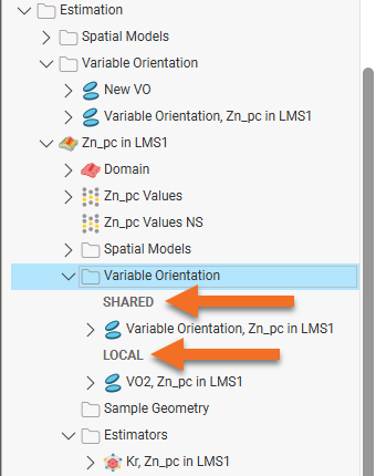

The Estimation folder contains a Variable Orientation folder, as does each domained estimation defined in a project. The Estimation > Variable Orientation folder is for storing ‘shareable’ variable orientation objects. These can be used by all domained estimations in the project. Here two domained estimations are using the same variable orientation object:
In domained estimations, variable orientations applied can be either ‘local’ (available only to that domained estimation) or ‘shared’ (from the Estimation > Variable Orientation folder). Here in the Zn_pc in LMS1 domained estimation, the variable orientations are organised into local and shared subsets:

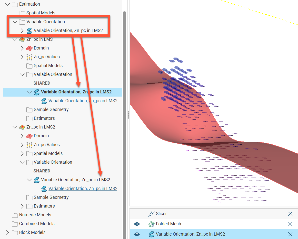

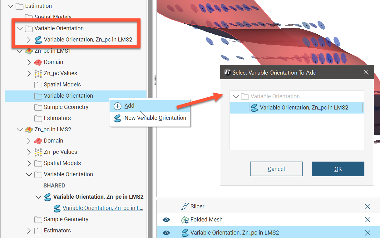

You can create variable orientations in the Estimation > Variable Orientation folder and in a domained estimation’s Variable Orientation folder. See Creating Variable Orientations later in this topic.
To add a shareable variable orientation to a domained estimation, right-click on the domained estimation’s Variable Orientation folder and select Add. In the window that appears, select the shared variable orientation object you wish to use:
Variable orientations created locally need to be shared before they can be used elsewhere in a project. To do this, right-click on a local variable orientation object and select Share.
The variable orientation object will be moved into the Estimation > Variable Orientation folder and a link to it will be added to the domained estimation’s shared list.
If you add the variable orientation from the Estimation > Variable Orientation folder to the scene, there is no domain applied to it and so your visualisation options are limited. Once the variable orientation has been shared with a domained estimation, you can add the variable orientation from the domained estimation to the scene.

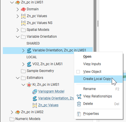

If you are using a shareable variable orientation object in a domained estimation but wish to make changes to it without affecting where the variable orientation is used elsewhere, you can make a local copy of it and then make the required changes. To make a local copy, right-click on the shared object and select Create Local Copy:
The variable orientation in the Estimation > Variable Orientation folder remains, but a local copy of it is made in the domained estimation and the link to the shareable variable orientation is removed.

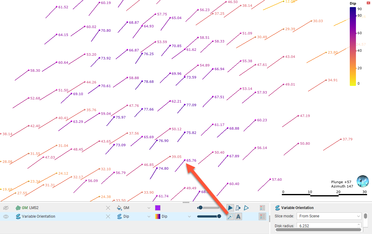

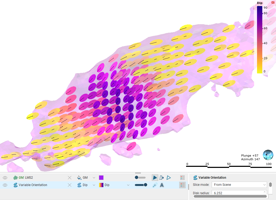

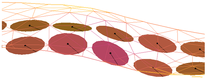

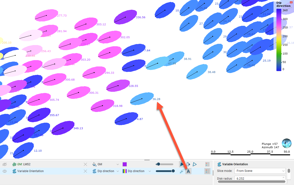

Variable orientations can be viewed as disks or lines. The grid used for visualisation can be any block model or sub-blocked model in the project, or a custom grid can be specified as part of setting up the variable orientation.
Here a variable orientation is visualised on a custom grid, with disks coloured using the Dip direction values at each point on the grid. Enabling text display (
) shows the values in the scene. The disks are a representation of the local orientation of the maximum-intermediate plane calculated at the chosen centroids. They represent both the search ellipsoid and the variogram, by indicating their principal plane. The line on each disk indicates the position and direction of the major axis.
Search ellipsoids are described using axes of maximum, intermediate and minimum continuity. Variogram ellipsoids are described using major, semi-major and minor axes. Because both the local search ellipsoid and local variogram orientation are indicated by variable orientation disk and line objects in the scene, we will avoid potential confusion by using the terms maximum, intermediate and minimum in this topic, unless specifically discussing variograms.
Click on a disk to view further information about it.
There is also the Show as lines option (
), which hides the disks to reduce visual clutter while still showing the fundamental orientation information in the form of the maximum axis direction for each search space local to each centroid:
You can also change the Anisotropy used to display the variable orientation. Options are Isotropic and any variogram models and search spaces defined in the estimation:
When anisotropy is displayed, the ratio of the maximum-intermediate axis of the chosen object is displayed. The actual range is not shown.

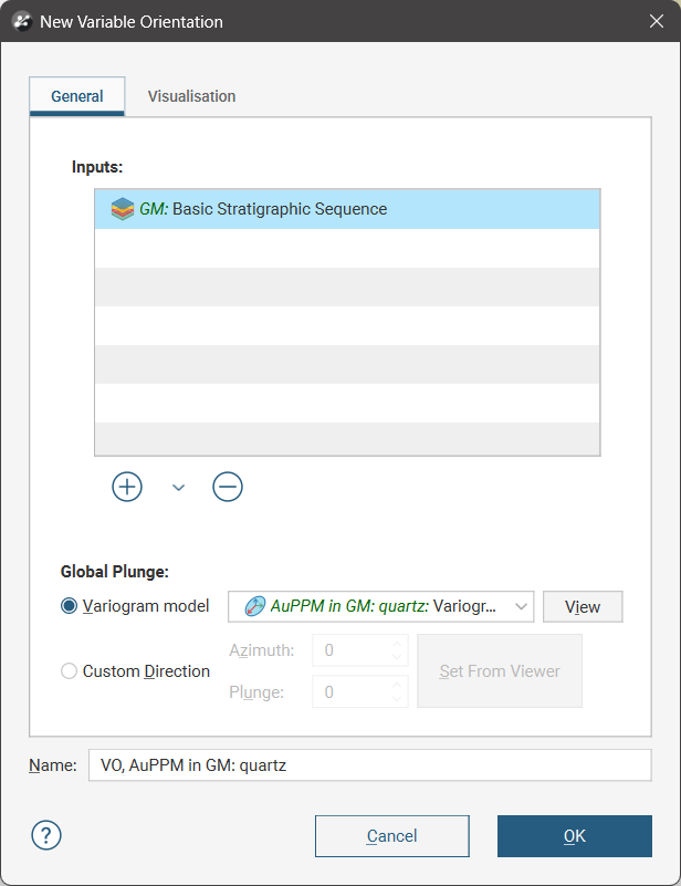

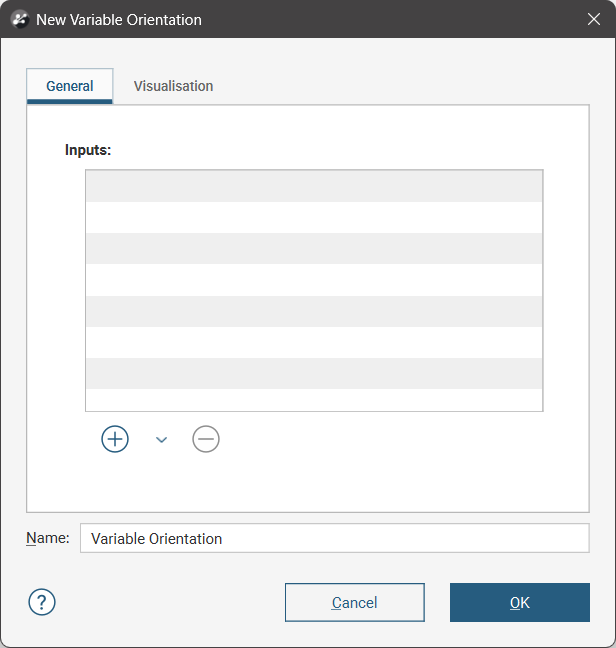

To create a variable orientation, right-click on either the main Estimation > Variable Orientation folder or on the domained estimation’s Variable Orientation folder and select New Variable Orientation.
If creating a shared variable orientation from the main Estimation > Variable Orientation folder, the New Variable Orientation window will have these controls:
If creating a local variable orientation from the domained estimation’s Variable Orientation folder, the New Variable Orientation window will also have Global Plunge options:
Both windows control how the variable orientation will be displayed in the Visualisation tab.
Selecting the Inputs

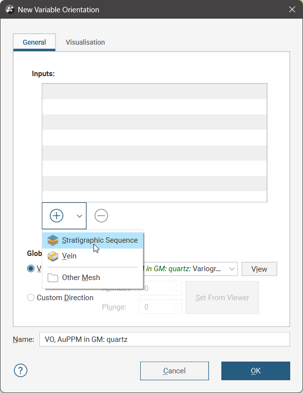

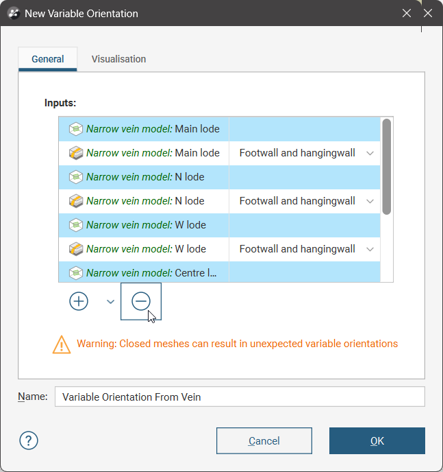

On the General tab, click the Add Inputs button, then select a type of object to use to provide a form for the variable orientation. You can choose from:
- Stratigraphic Sequence objects
- Vein objects
- Other Mesh objects
You will then be presented with a Select window presenting a list of available objects and a list of selected objects. Move the objects you want to use to provide form to the variable orientation into the list of selected objects.
Inputs to a variable orientation can include veins, a stratigraphic sequence and any mesh in the project. When a mesh is used, it should be an open mesh that draws out the shape of the undulations of the structure, rather than a closed mesh such as the domain. The facing direction of the surface is relevant; it is used to determine the direction of the surface normal vectors. Each vertex of the mesh is used to generate the orientation, so the resolution of the mesh should be sufficient to capture subtle changes in trend without adversely increasing processing time.
Using closed meshes such as the mesh of the domain used in the estimation is not advised. Doing so may result in boundary effects and inconsistent vector orientations, and the vector may become undefined in the middle of a mesh if components interpolate to zero.

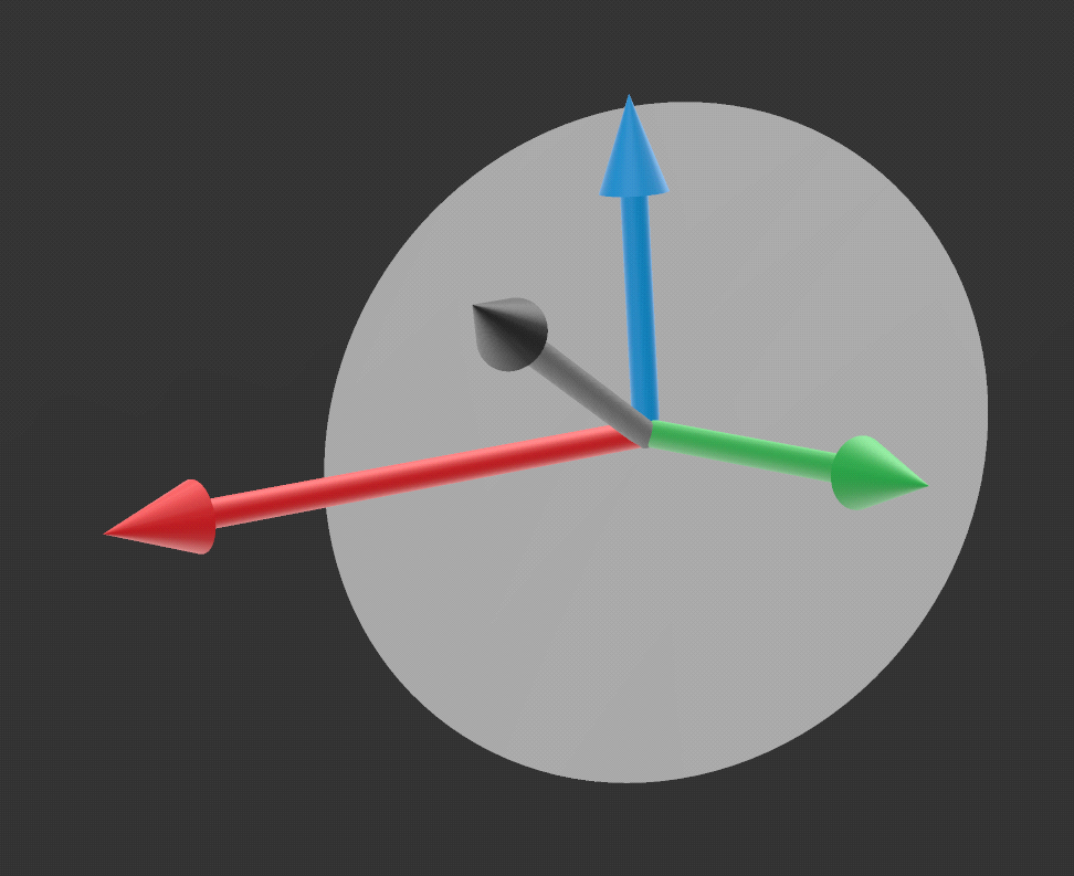

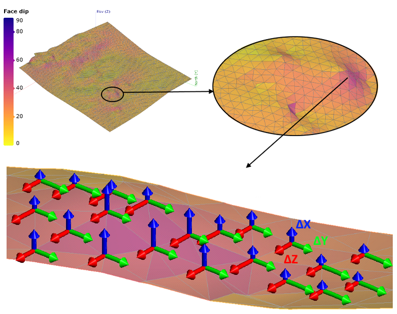

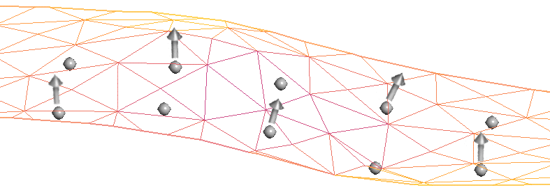

At each vertex of the input mesh, a normal unit vector is calculated from the average orientation of the faces that meet at that vertex. This normal vector is then resolved into three orthogonal component vectors, Δx, Δy and Δz. Take a close look at this slice of an undulating part of a hangingwall mesh shaded according to the face dip:
In the above image, the component vectors have been added as explanatory annotations; these are not part of the scene.
Three radial basis functions are then created, one for each of the three orthogonal component vectors. These RBFs use a biharmonic spline basis function of degree zero and ‘reduce’ fit type. Accuracy is set at 1%. These parameters are fixed and cannot be customised or controlled.
Now that RBFs have been created and we have a continuous function throughout the space of interest, the component vectors for any point in space can be determined, not just at the vertices in the mesh. From the component vectors, the normal vectors can be constructed at any point in space, again, not just at the vertices in the mesh.
When a normal is reconstructed at any given point in the model, this defines the minimum axis, and, implicitly, the orientation of the principal plane that the maximum and intermediate axes lie on orthogonal to the minimum axis.

When a vein is added as an input, you will get both closed mesh and open hangingwall and footwall meshes. Removing all the closed meshes by selecting these objects and clicking the Remove button will dismiss the warning.
For each of the open vein surfaces, you can choose to use the Footwall only, Hangingwall only or Footwall and hangingwall meshes.

Setting the Global Plunge
If you are creating a local variable orientation, or editing a shared variable orientation that has been applied to a domained estimation, you have Global Plunge options.

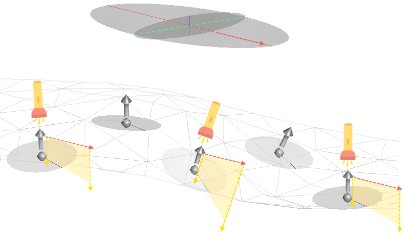

The Global Plunge is used to determine the direction of the principal axis on the principal plane. The Global Plunge is a vector defined by either the major axis of the global variogram or globally defined search, or it is set from the view. This vector is used to determine where the direction of the principal axis should lie within the locally re-oriented principal plane. This is achieved by finding the direction on the local plane that is closest in orientation to the global vector. In practice this amounts to projecting the shadow of the global plunge vector, in the direction of the local normal vector, onto the re-oriented local plane.
You have two choices for the Global Plunge:
- Use one of the variogram models defined for the domained estimation. Select one from the dropdown list.
- Set a Custom Direction. Click and drag in the scene to align the view to the direction of the perceived maximum continuity, then click Set From Viewer. Capture the current scene to bookmark the direction you have set, as the Custom Direction cannot be visualised in the scene.
The projected Global Plunge is represented by the black pitch line on each of the variable orientation disks. Visually validate the disk’s pitch lines to confirm that the Global Plunge has been applied in the manner you expect.
The Global Plunge is projected onto the principal plane to define the direction of the principal axis. Imagine a flashlight shining down the normal vector towards the principal plane and shining through a variogram model ellipsoid. The shadow cast by the major axis defines the principal direction.
The intermediate axis will lie on the principal plane at 90° to the principal direction axis. Together, the normal vector, the principal direction and the intermediate axis orthogonal to them define the orientation for the minimum, maximum and intermediate axes for use at each point required for estimation. These orient the search space and variogram for that specific location in space. These directions are determined for each required location.
When visualised as lines, only the principal direction is shown, pointing away from the reference point. When visualised as disks, a circular disk is added to indicate the principal plane.

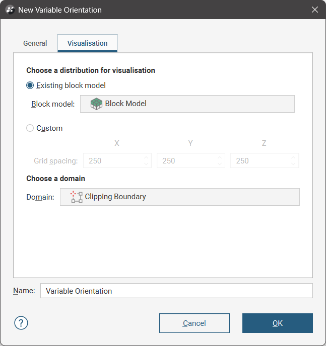

Setting Visualisation Options

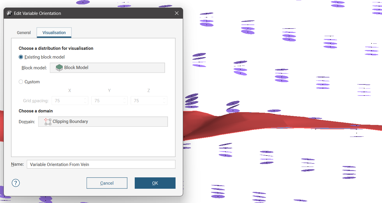

In the Visualisation tab, you can choose between visualising the variable orientation on an existing block model or on a custom grid. Here a variable orientation created from a vein is visualised on a block model:
Using a block model or sub-blocked model for visualisation does not evaluate the variable orientation on the selected model. All block models and sub-blocked models in the project can be selected.

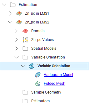

The Variable Orientation in the Project Tree
Enter a name for the variable orientation and click OK to create it. It will be added to the project tree. Expand it to see its parts:
The variable orientation includes links to the variogram model, if used, and to the inputs.
Drag the variable orientation into the scene to check it, and double-click on the variable orientation in the tree to edit it.

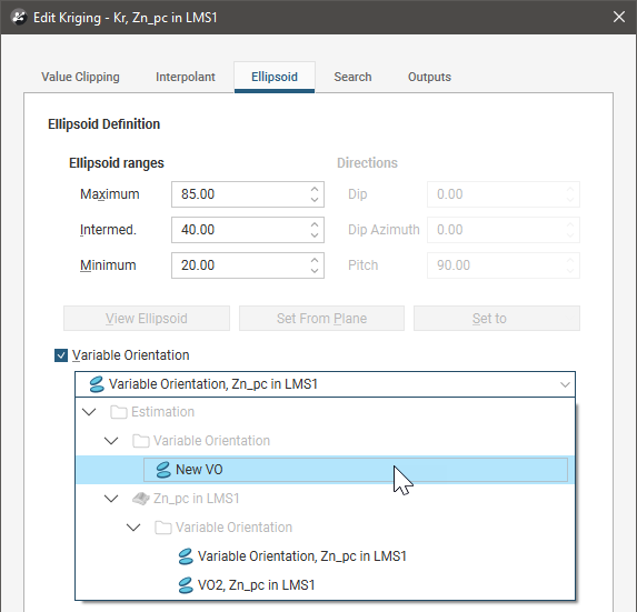

Leapfrog Geo supports variable orientations in Kriging and inverse distance estimators. Double-click on the estimator, then click on its Ellipsoid tab. Tick the box for Variable Orientation and select from those available, which will include shared variable orientations in the Estimation > Variable Orientation folder and local variable orientations:
If you select a shareable variable orientation, a link to it will be copied to the domained estimation, as described in Managing Variable Orientations in a Project earlier in this topic.

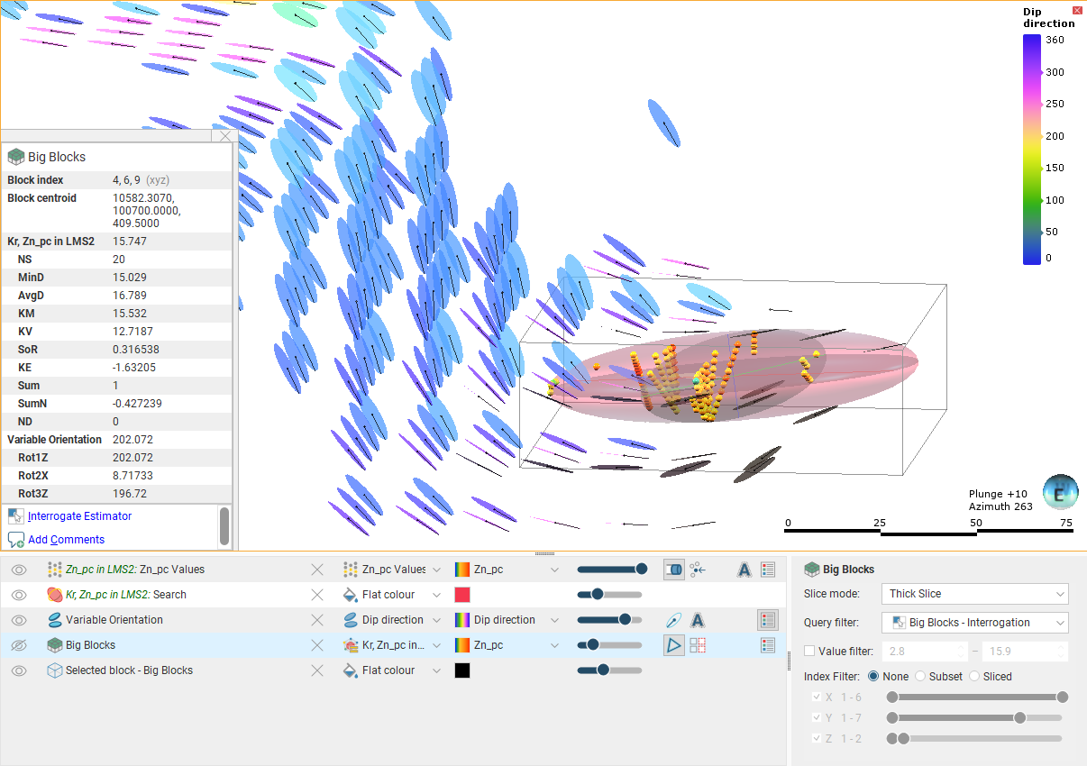

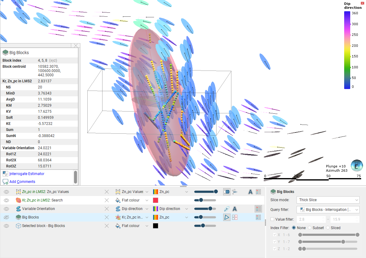

When a variable orientation is applied to an estimator, the local search can be visualised using the block model interrogation tool.
Here one block in a block model is shown with the search area indicated by the ellipsoid widget. The orientation of the ellipsoid reflects the direction set by the variable orientation for this block:
Here the viewing angle is the same but a nearby block is selected, showing a different orientation for the widget. This reflects the effect of the variable orientation on this block, demonstrating that each block can have a different search space and variogram orientation:
See Block Estimate Interrogation for more information on the interrogation tool.

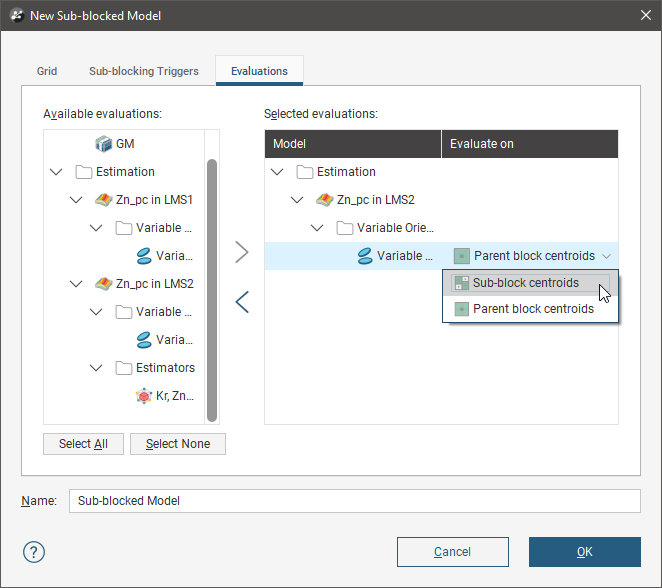

Exporting Rotations

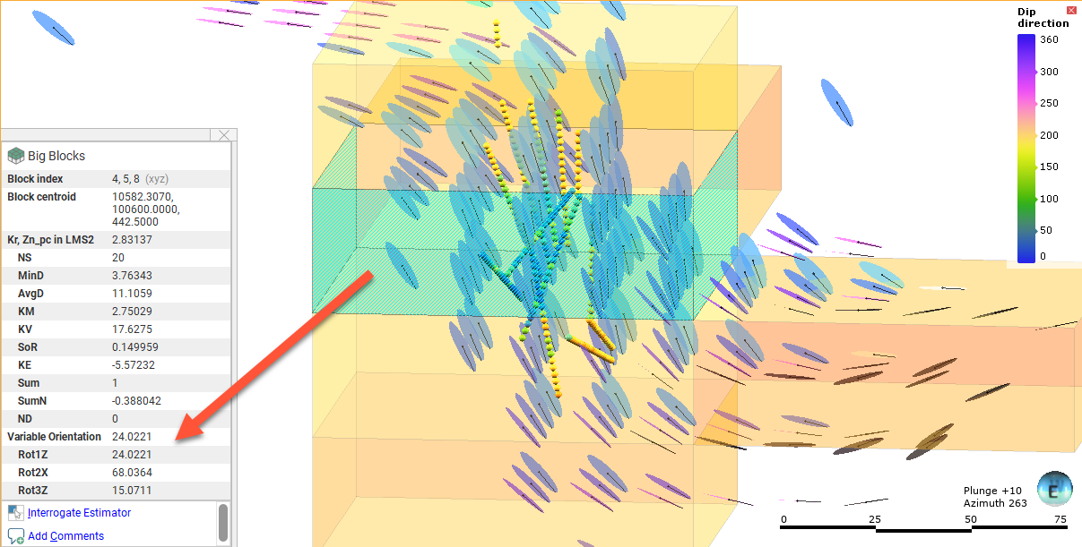

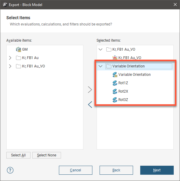

When you evaluate a variable orientation onto a sub-blocked model, you can use the parent block centroids or the sub-block centroids. The default setting is to evaluate onto the parent block centroids:
When a variable orientation is evaluated onto a block model, the Dip Direction and Dip in the variable orientation are represented in the rotation using the ZXZ convention.
- Rot1Z is the value of the rotation about the z axis. This turns y into y' and x into x', which is equivalent to the Dip Direction in the variable orientation.
- Rot2X is the value of the rotation about the x' axis and is equivalent to Dip.
- Rot3Z is the value of the rotation about the z'' axis.
The use of the mesh "Left Hand Rule" (https://skfb.ly/6XBOH) by mHafiz0809 is licensed under Creative Commons Attribution (http://creativecommons.org/licenses/by/4.0/).

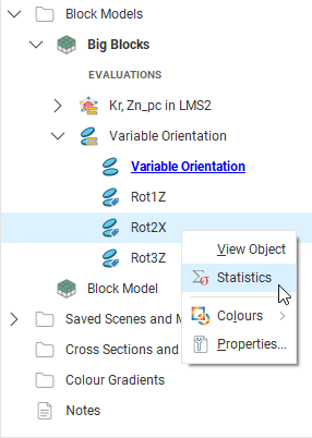

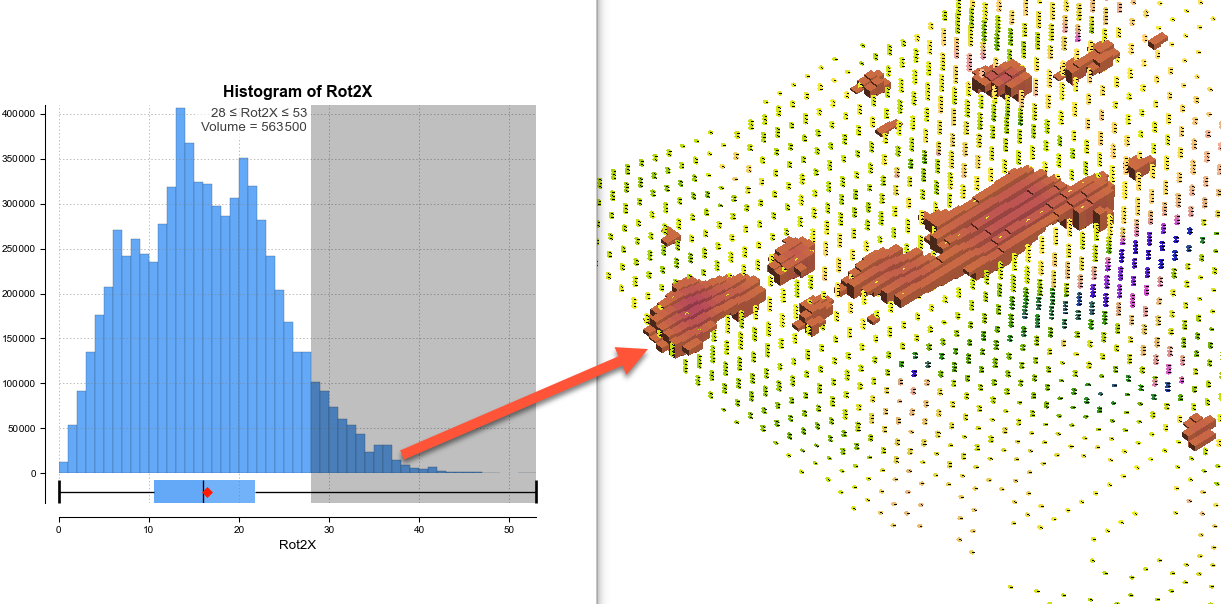

When a variable orientation is evaluated onto a block model or sub-blocked model, you can click on a block to view the rotation information:
You can right-click on the evaluation in the project tree to view its statistics:
For example, here the histogram is displayed for the Rot2X values. Rot2X varies throughout the surface, indicating that a global trend would not adequately describe the characteristics of the surface. The variable orientation is displayed in the scene, along with selected blocks from the block model where the Rot2X values are selected in the histogram. They are highlighted in the scene, indicating the parts of the variable orientation that have the steepest dip:
If required, you can export the rotations for use in other packages. When exporting the block model, be sure to select the variable orientation evaluation:
