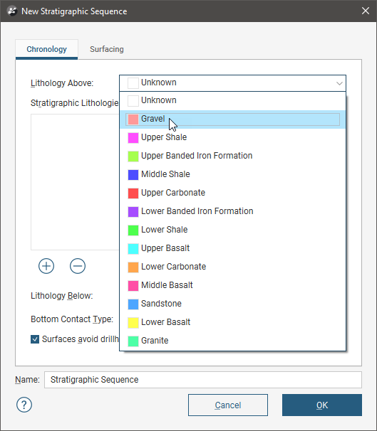

To create a basic stratigraphic sequence, right-click on the Surface Chronology object and select New Stratigraphy > Basic Stratigraphy. The New Stratigraphic Sequence window will appear:
Select the lithologies at the top and bottom of the stratigraphic sequence. To do this, select the Lithology Above and Lithology Below from the lithologies available in the geological model:
You can add lithologies to the Stratigraphic Lithologies list first, but if you set the Lithology Above and Lithology Below first, those lithologies will be filtered out when you select the Stratigraphic Lithologies.

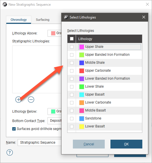

Next, click the Add button (
) to view available lithologies:

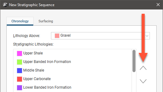

Select the lithologies that you want to use in the stratigraphic sequence, then click OK to add the layers to the Stratigraphic Lithologies list. Make sure they are arranged in the correct order, using the arrows alongside the window to rearrange them, if necessary:

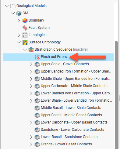

The objects that make up the stratigraphic sequence include the generated contact surfaces and any points that result in pinch-out errors:

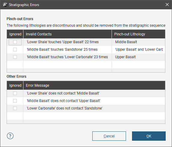

Correcting Pinch-Out Errors
Add the pinch-out errors object (
) to the scene to view the points that are causing errors. To find out more about the errors, either:
- Right-click on the stratigraphic sequence and select List Errors
- Double-click on the pinch-out errors object (
In the Stratigraphic Errors window, information is provided about the different errors that occur in the stratigraphic sequence, with pinch-out errors and other errors listed separately:
Use this information, together with the pinch-out error points, to either remove lithologies from the sequence or adjust surfaces using any of the tools available for individual surfaces, as described in Editing Individual Surfaces below.
Remove lithologies from the sequence by double-clicking on the sequence in the project tree, then reorganising the lithologies in the Chronology tab.
You can also ignore an error by ticking the Ignored box in the Stratigraphic Errors window.
