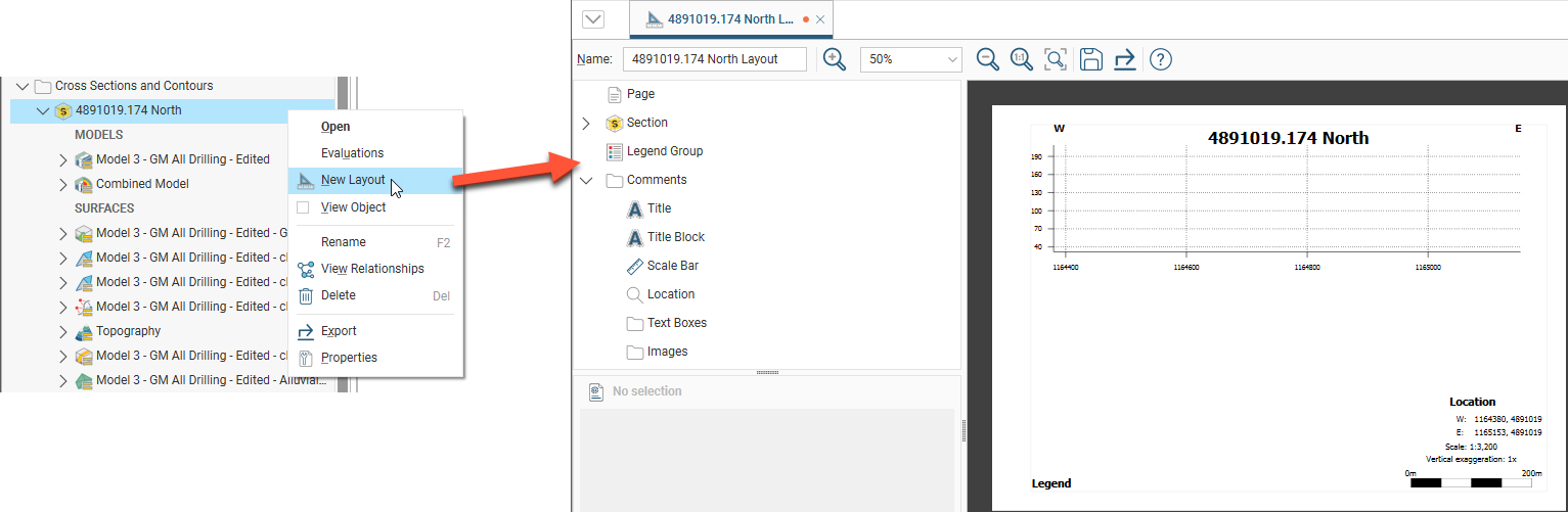

To create a section layout, right-click on the section in the project tree and select New Layout. A new tab will appear in which you will be able to make changes to the section layout. This tab has a layout tree that you can use to change different parts of the section and add data to it. See Using the Section Layout Editor below for detailed information on adding information to the section layout.

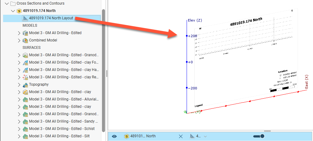

In the project tree, the section layout is saved as part of the section. Drag the layout into the scene to display it:
Edit the section layout by double-clicking on it in the project tree. See Using the Section Layout Editor below.

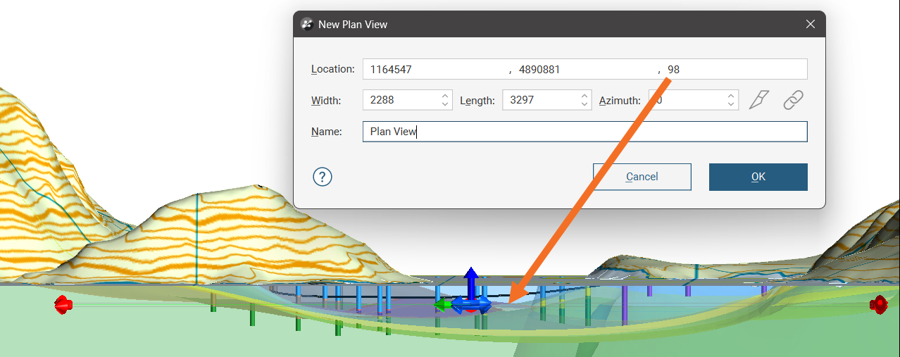

If there is no existing plan view, first add a model to the scene and press the D key to get a top-down view of the model. Next, right-click on the Sections, Plans and Contours folder and select New Plan View. The New Plan View window will appear, together with a plan view plane and controls in the scene that let you adjust the position of the plan view plane:
Use the handles in the scene to position and size the plan view plane. The handles work in the same manner as the moving plane controls, as described in The Moving Plane.
Switch to a side view to set the elevation of the plan view. Use an elevation over the project area if you are creating a plan view purely for context, or choose a specific elevation in the project space to view horizontal sections through the scene.
Once the plan view plane is positioned as required, click OK to create the new plan view, which will appear in the Sections, Plans and Contours folder. Right-click on the plan view in the project tree and select New Layout. A new plan view layout window will open.

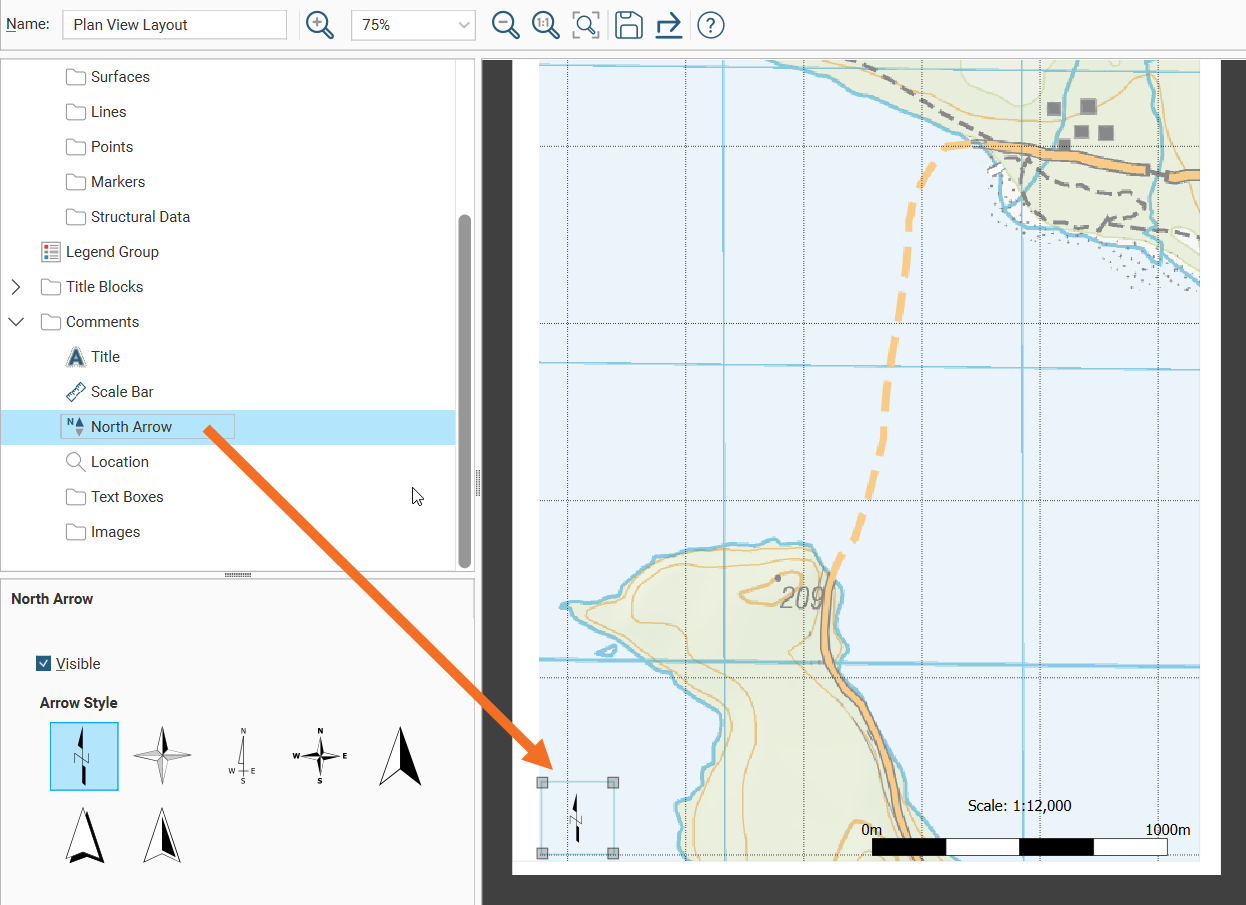

Plan view layouts are similar in most respects to section layouts, except plan views can also have a North Arrow feature added to them from the Comments folder.

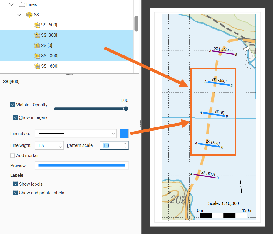

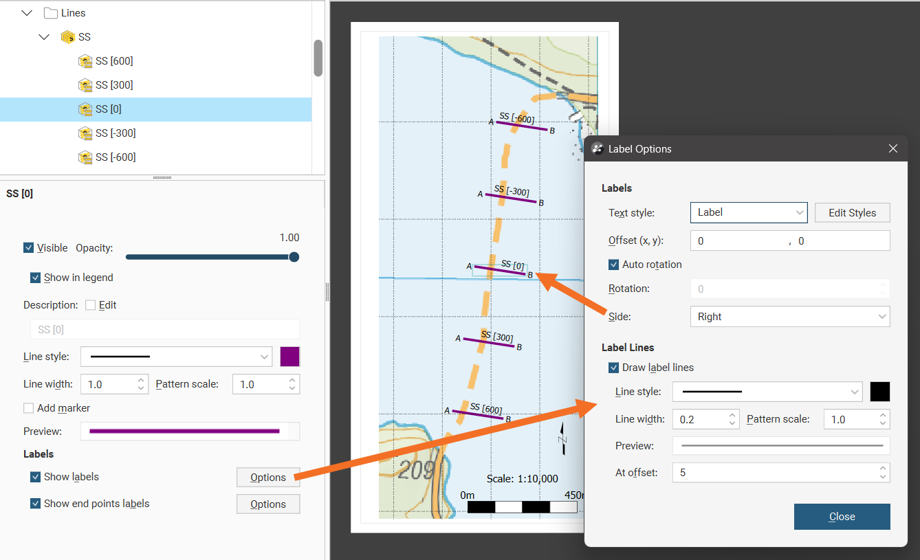

Along with other line colour, style and width controls, section lines can have their labels positioned to the Left, Centre or Right by clicking through to the labels options.
You can select multiple lines by holding down the Shift key or the Ctrl key while clicking. You can then style the selected lines similarly without having to make individual customisations to each line.

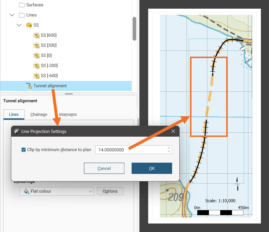

Lines projected onto the plan view can be clipped to parts of the line within a clipping distance. Double-click on the line object or right-click on the line object and select Projection settings, then tick Clip by minimum distance to plan and specify a clipping distance. Here the minimum distance selected is less than the distance the tunnel alignment line drops below the plan view elevation, so part of the tunnel alignment is not shown on the plan view:

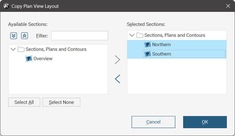

Plan view layouts can be reused and modified for other plan views. When multiple plan views are available, right-click on a preferred plan view layout in the project tree and select Copy Layout To. The Copy Plan View Layout window will show the Available Sections. Move plan views over to the Selected Sections list to apply the plan view layout.

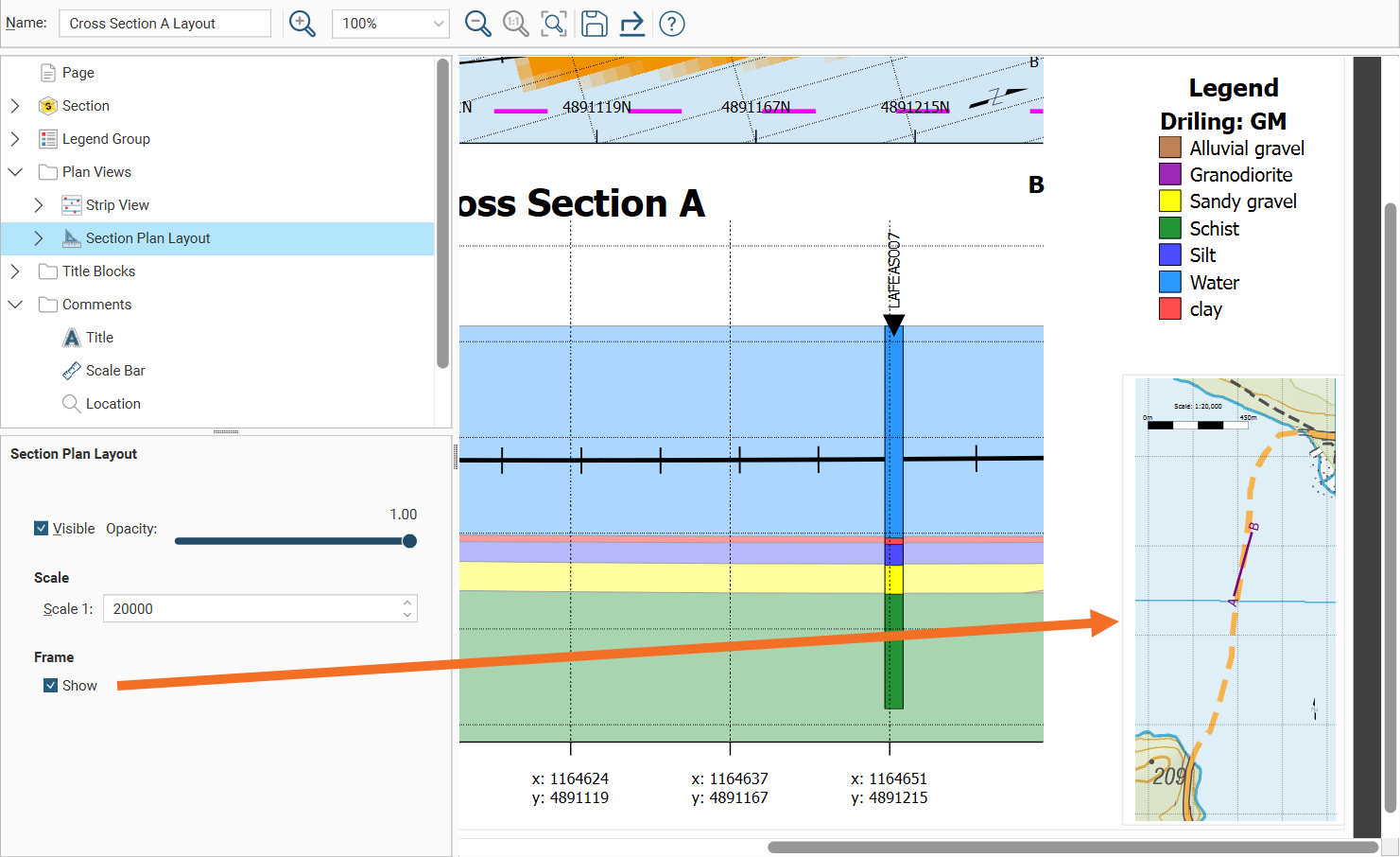

Once created, a plan view can be added to a section layout from the Plan Views folder. Right-click Plan Views in the layout tree and select Add Plan View. The Add Plan View window will appear, listing the available options for plan view layouts. Select one and click OK.
One setting unique to plan views is the Show checkbox in the Frame section. This will add a thin box around the outside of the plan view to visually separate it from the rest of the section layout.

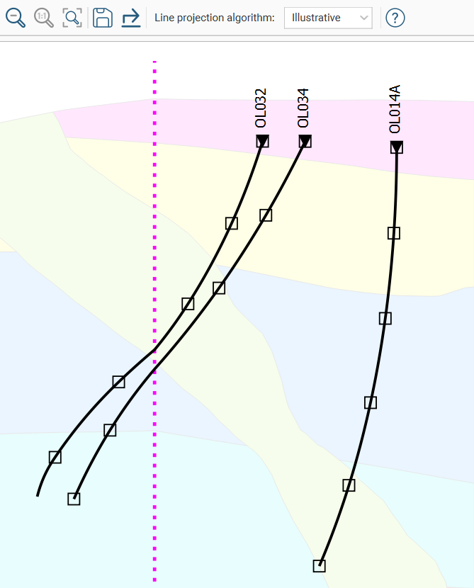

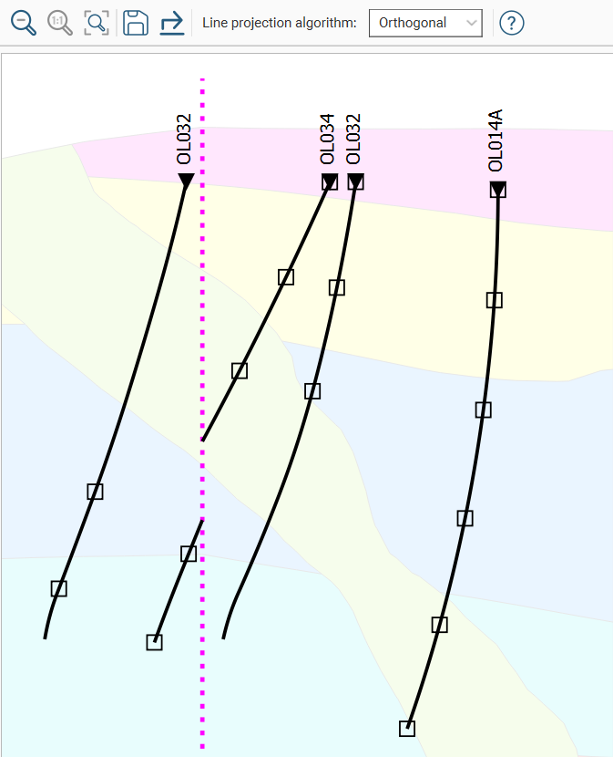

Long section layouts get an additional Projection algorithm option.
Choose between:
- Orthogonal. Drillholes, planned drillholes and downhole points will be projected onto long sections using a strict orthogonal projection. Where a long section has panel bends due to the shape of the long section, this may result in a drillhole appearing discontinuous, although the projection is strictly correct due to the bend being flattened onto the section. It is also possible for a drillhole to appear on more than one panel.
- Illustrative. Drillholes, planned drillholes and downhole points will be projected onto long sections using a projection that proportionally scales the projection angle into section panel bends, giving all drillholes a natural contiguous appearance on the section. This projection cannot be used for obtaining accurate distance measurements using the section drawing, but it can be useful for communicating the underground model to non-technical audiences.
When drillholes, planned drillholes and downhole points are added to a curved long section, each object is projected onto each panel segment of the section. When the orthogonal projection algorithm is used, the projection point of origin is orthogonal to the section panels. When the illustrative projection algorithm is used, the bisectors of the angles between each panel segment and its neighbour determine the projection point of origin for a given segment of the section. When objects are filtered by the distance to the section plane, the distance is measured at 90 degrees from the section. With illustrative projection, some objects may report a distance that is greater than the specified minimum distance; if this is the case, it is because the evaluation distance is relative to the projection origin.
On the inside of a tight corner, a single object may be projected multiple times onto the section. If this is the case, the multiple instances of the object will appear in the projection settings window and you can turn individual instances off, if required.
Leapfrog Geo will remember the option you select and will use that as the default the next time a new layout is created.

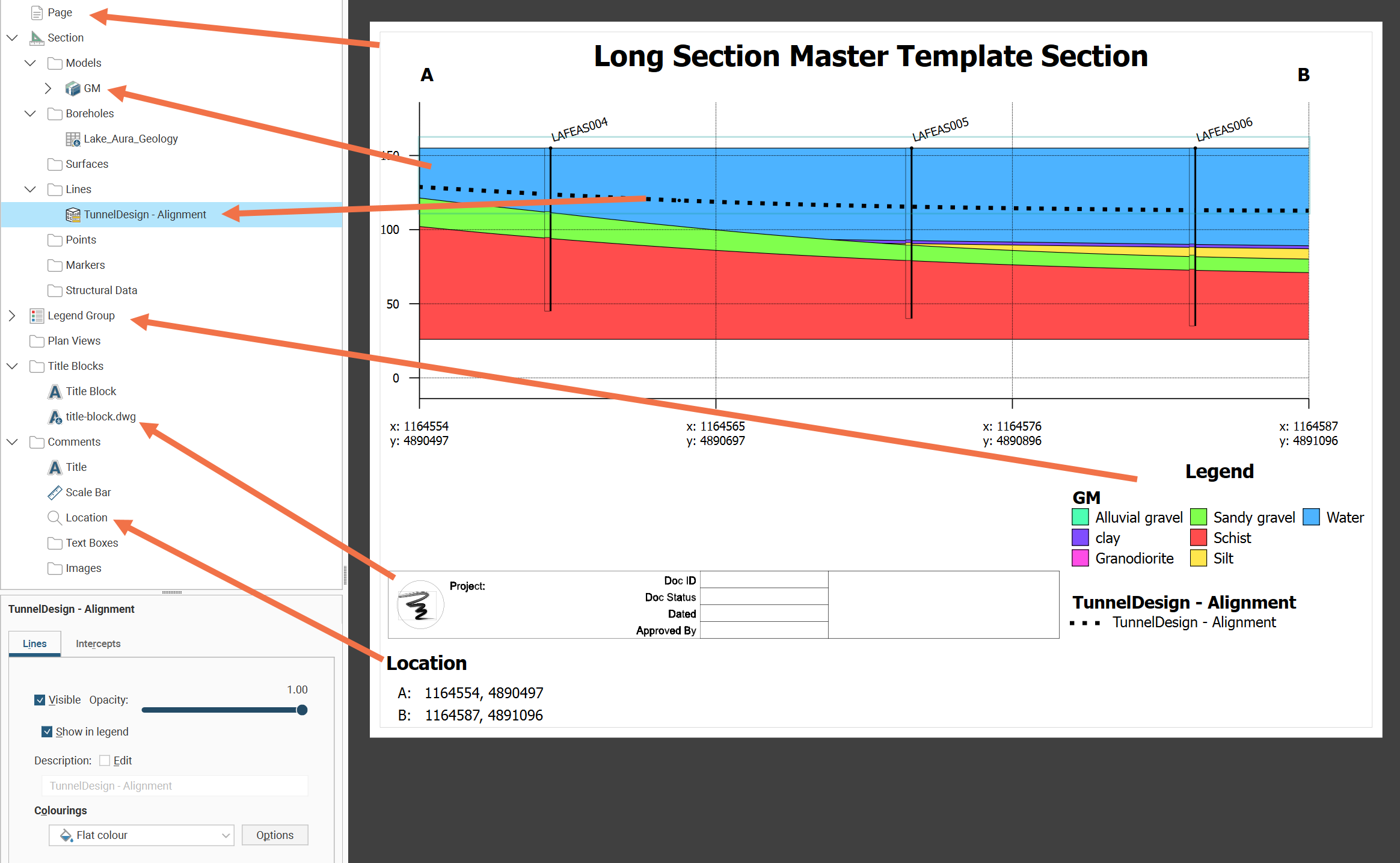

In the section editor, the layout tree shows the different layers that can be added to the page. The different parts of the layout tree as they relate to the page preview are shown below:
When you select an object in the layout tree, it will be highlighted by a blue line on the page. In the example above, the Lines object Tunnel - Alignment is selected. Click on an object in the page preview to move or resize it. This will also select the object in the layout tree and you can see what properties can be changed. For example, in the preview, click on the Title to view its styling options:
Text displayed in the section layout is controlled by a style sheet that can be accessed whenever you are editing a text object. For example, clicking on Edit Styles for the Title opens the list of Text Styles with the Title selected, but also allows you to change the appearance of styles used for other text objects visible in the preview:

Sections can be displayed in the scene by dragging a layout into the scene to see the section in relation to models in the scene, but the usual way sections will be viewed is by exporting them as files to be imported into other software or as documents to be printed.
Some sections will be too large to display in the scene, which will be indicated in the section layout editor.

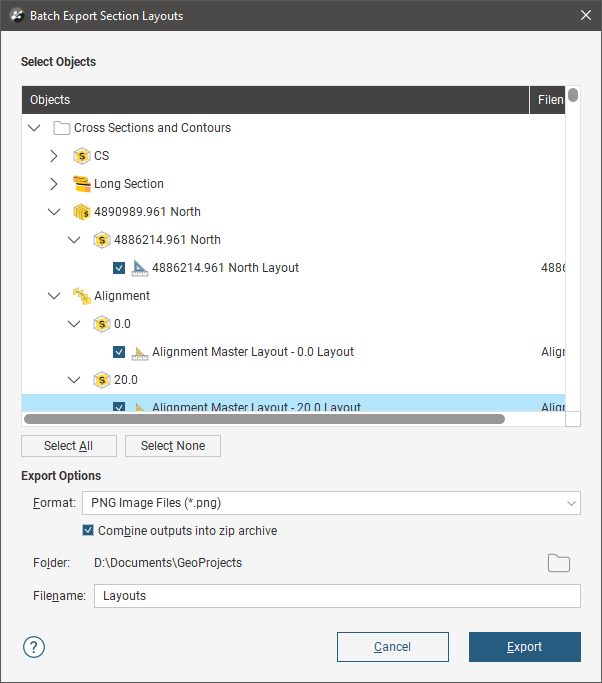

You can also batch export multiple section layouts. To do this, right-click on the Sections, Plans and Contours folder and select Batch Export Layouts. All selected sections can be exported as a single PDF or individually in PDF file (*.pdf), Scalable Vector Graphics file (*.svg), PNG image (*.png) or GeoTIFF (*.tiff, *.tif) formats. When section layouts are exported individually, all outputs can be combined into a zip archive.
In the window that appears, select the layouts you wish to export, then select a format. If you select a format other than Single PDF, you can combine all outputs into a zip archive. Select where you wish to save the outputs, then click Export.

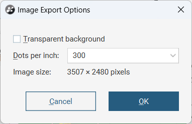

If the export format is selected as a GeoTIFF file, an Image Export Options window will appear where the resolution can be specified in Dots per inch and you can specify whether or not the image will have a Transparent background.
