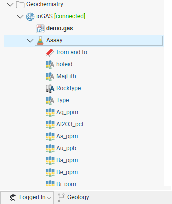

Once the connection is established, any dataset open in ioGAS will be available from the ioGAS object and can be displayed in the Leapfrog Geo scene window:
The status of the connection to ioGAS is indicated in Leapfrog Geo, and the data file open in ioGAS appears in the Geochemistry folder (e.g. demo.gas).
You can view the data in Leapfrog Geo by adding the ioGAS data object to the scene. When attributes are changed in ioGAS, the display will be updated in Leapfrog Geo. You can also:

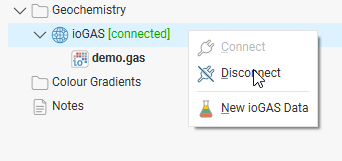

To terminate the connection to ioGAS, right-click on the ioGAS object and select Disconnect:
Once the connection to ioGAS is terminated, ioGAS data (*.gas) will no longer be available in Leapfrog Geo.

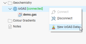

To create a new ioGAS data object, right-click on the ioGAS object and select New ioGAS Data:
You can filter the data you send to ioGAS using any of the query filters defined in the project. Make sure the query filter you wish to use has been defined before you start creating a new data column.
In the window that appears, select the table you wish to use for the Base table, then select the columns to send to ioGAS. If you wish to filter the data, select the query filter required from the list.
Enter a Name for the data column and click OK. The new data column will appear as part of the ioGAS folder:

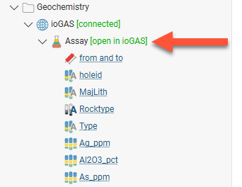

In ioGAS, select File > Open Link Data. Once the column has been opened, you can use the tools available in ioGAS to analyse the data. That the data is open in ioGAS is indicated in the project tree:

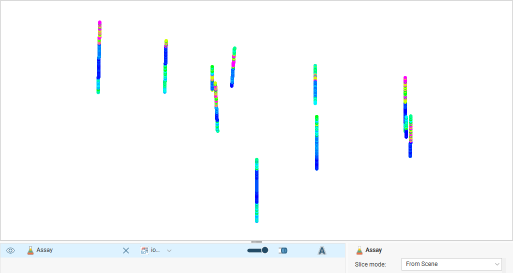

If you have the data visible in the Leapfrog Geo scene, changes made will be displayed in Leapfrog Geo. Here the ioGAS attribute manager has been used to assign colours to the selected values in ten equal ranges:
The changes to attributes are automatically updated in the Leapfrog Geo scene window as long as the link is live.

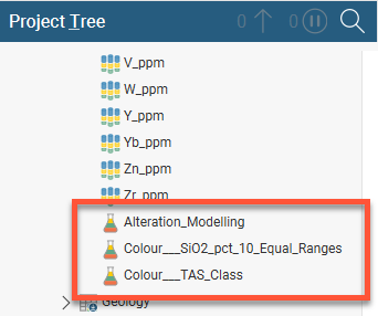

To save the changes and send a new data column back to Leapfrog Geo while the ioGAS link is live, select one of the Make Variable From options from the Data menu in ioGAS.
In Leapfrog Geo, the column will be added to the base interval table used to create the new lithology. Here, three columns () have been added to the base table:
When the connection to ioGAS is terminated, the ioGAS data column will remain in the project tree as part of the ioGAS folder. Data columns created in ioGAS will also be available and will appear in the base interval table.

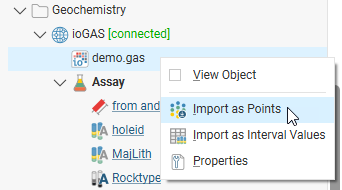

To import ioGAS data as points, right-click on the ioGAS data object in the project tree and select Import as Points:
In the window that appears, select the data columns you wish to import and how they will be imported. Click Finish to import the data, which will appear in the Points folder. You can then display the points in the scene and work with them as you would any other points object. The new points object will remain in Leapfrog Geo once the connection to ioGAS is terminated.
