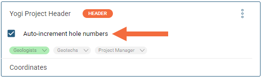

Auto-incrementing Hole/Point Numbers

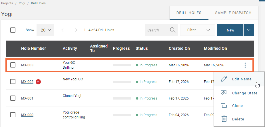

The Auto-increment hole/point numbers setting is available for the header table. This determines how each new logging activity is named. When selected, MX Deposit will automatically assign the first hole/point number with the prefix of MX.
This can be changed once the hole is created and the status is set to In Progress. Here, the Hole Number assigned is MX-003. It can be changed by selecting Edit Name from the overflow menu of the new hole:
Sequential numbering will be updated to the new naming convention for any further holes created in the same activity.
When the Auto-increment hole/point numbers setting is not selected, the logger will be prompted to enter a hole/point number.

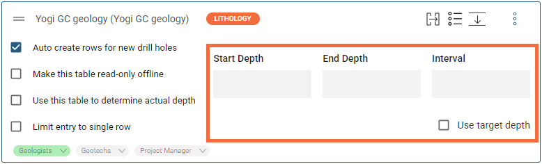

Auto Creating Rows
The Auto create rows for new drill holes setting is available for all tables in a drilling activity except the header table.
Enabling this setting is useful in streamlining the data entry workflow for loggers, since new rows are auto created according to parameters configured for the activity.
Once this setting is enabled, you can set a Start depth, End depth and Interval to determine how the new rows are created.
Alternatively you can select the Use target depth option if you have already specified a target depth when setting up the table.
