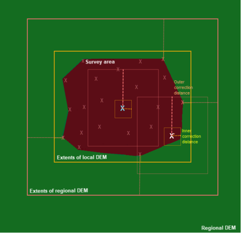

Figure 1: The Regional DEM grid (green) should cover at least the survey areas (filled brown polygon stations marked with Xs) extended by the outer correction distance (pink dashed lines). The pink rectangle denotes the required extents of the regional DEM grid. The yellow rectangle denotes the required extents of the local DEM grid.
