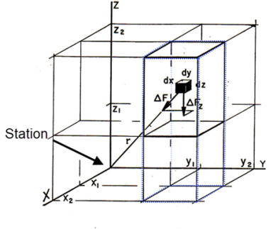

Zones 1 & 2: Right rectangular prism (Nagy)
1 to 8 cells away from station:
The three bars indicate the limiting values x1, x2 – y1, y2 - z1, z2. The above notation expands to 9 terms, each with a combination of xi, yj, zk.
