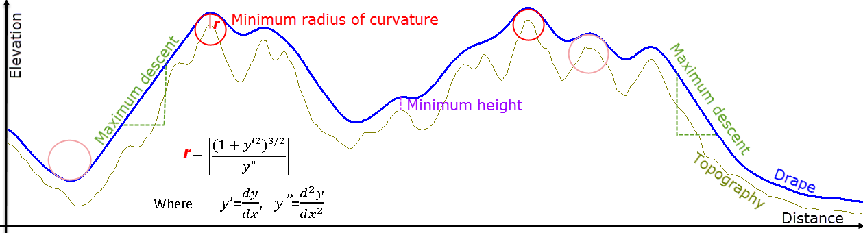

The draped surface is calculated along the survey line, using:
  • the Topography (DEM) as the base reference.
  • the gradient of ascent/descent to control the maximum slope along the flanks of a topography rise.
  • a minimum radius of curvature of 1000m to control the sharpness of the peaks and valleys.
