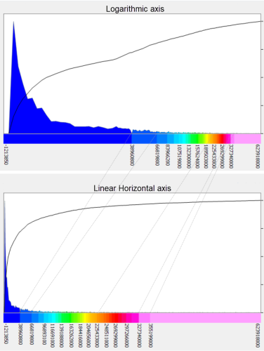

Logarithmic axis |
Leave this option unchecked when the data distribution is Gaussian by nature. The Logarithmic axis option should be used when the data distribution spans over many orders of magnitude, and a sizable amount of the data resides towards the low values of the data distribution scale. The use of a logarithmic scale will help emphasize the low values on the transform graph and highlight more detail. This option only affects the transform graph (the graph and the profile are redrawn); the data bins are not affected and the data layer/colour symbol in the active document (i.e., map, grid, 3D view, voxel) does not change.
