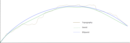

Local datum transforms are used to convert coordinates between different map datums. For example, a local datum transform is required to convert longitude and latitude coordinates on the WGS 84 datum to longitude and latitude coordinates on the NAD27 (North American Datum 1927). The difference in location that arises between map datums can be up to several hundred metres.
The key to understanding local datum transforms is an understanding of the geoid and its relationship to a datum. The Geoid is the actual surface of the Earth at mean sea level, which is everywhere normal to the Earth’s gravitational force. Because of local and regional variations in the Earth’s gravity field, the Geoid is not of a perfect mathematical form, but rather it has local variations as illustrated in Figure 2 (from Verhoogan, John, Francis J. Turner, Lionel E. Weiss, Clyde Wahrhaftig, William S. Fyfe (1970), The Earth, Holt, Rinehart and Winston, Inc., New York):
Figure 2: The Geoid represents the surface of equal gravitational potential at Earth’s sea level. The Geoid is not a perfect mathematical form because Earth’s gravitational field is not symmetrical.
A datum defines the Earth's surface on which maps are based when mapping a specific region of the world. Older datums such as NAD27 are based on the Geoid, while newer datums such as WGS84 and NAD83 are based on an ellipsoid surface. For geoid-based datums, an ellipsoid is used to approximate the geoid for the region of the Earth mapped using that datum. An ellipsoid is what the geoid would have been if the mass of the Earth were uniformly distributed. A datum is defined by an ellipsoid (described by the major axis and flattening), a prime meridian (Greenwich, England at longitude 0°), and for geoid-based datums, a tie point, which is the location on the Earth at which the ellipsoid and the geoid are the same for the region that the datum is used. The ellipsoid and tie point are chosen such that the differences between the surface of the ellipsoid and the geoid are minimized.
Most common mapping operations within the same datum are only concerned with the ellipsoid, which is why an ellipsoid name is often used interchangeably with a datum name. Also, many datums share the same ellipsoid. This has led to the unfortunately common use of different datum names to describe the same area. For example, NAD83 and WGS 84 are both commonly used in North America, Adindan and Arc 1960 are commonly interchanged in North-East Africa, Corrego Alegre and Chua in Brazil, and there are many more examples.
With the advent of satellites and later the Global Positioning System, it became necessary to define datums tied to the gravitational center of the Earth (as opposed to being tied to a location on the Earth’s surface). Such datums are called geocentric, and the most common example is WGS 84. Most of the difference between an Earth surface- tied datum and a geocentric datum can be described by a shift in the location of the center of the ellipsoid (the assumed Earth center). However, there can also be a small rotation difference caused by differences in the direction of North, and a scale factor caused by differences between the elevation of the tie point and mean sea level. Further, local perturbations of the geoid that result from local gravity variations within a datum will produce additional “residual” differences.
