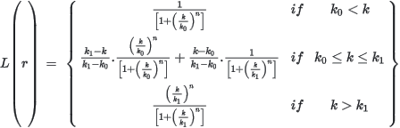

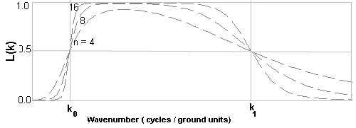

The Butterworth Bandpass filter allows passing the desired mid-wavenumber range while attenuating the low and high extremes of the wavenumber continuum. The Filter Order controls the degree of the sharpness of the cutoff wavenumbers; the higher the number the closer the shape of the operator is to the ideal bandpass operator. However one is cautioned not to apply the ideal bandpass filter as it manifests a ringing artefact. A common, but more complicated alternative is the Cosine Bandpass roll-off filter (FFTCOSNB).
Butterworth Bandpass Filter
Where:
k0 |
Low wavenumber cutoff in cycles/ ground unit. |
k1 |
High wavenumber cutoff in cycles/ground unit. |
n |
Positive integer value determining the degree of sharpness of the cutoff. |
