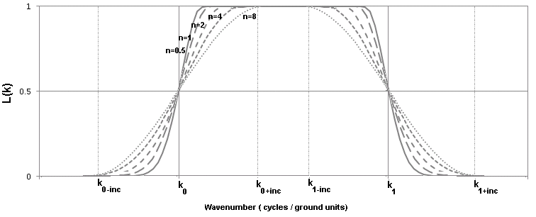

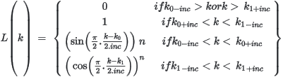

The Cosine bandpass filter allows to pass the desired mid- range wavelengths while attenuating the low and high extremes of the wavenumber continuum. The Filter Order controls the degree of the sharpness at the two cutoffs. The higher the number the closer the shape of the operator is to the ideal bandpass operator. However one is cautioned not to apply the ideal bandpass filter as it manifests a ringing artefact. A common alternative is the Cosine roll-off filter (COSN).

k0 |
Low wavenumber cutoff in cycles/ ground unit. |
k1 |
High wavenumber cutoff in cycles/ground unit. |
inc |
wavenumber width max(3,n/10). |
n |
Number of data points in the wavenumber domain. |
k |
Wavenumber domain increment, used to depict a radially symmetrical variable. |
where: np is the number of points cs is the cell size |
u |
X component in the wavenumber domain. | k = 2π ( i μ+j ν ) |
v |
Y component in the wavenumber domain. |
r |
Radial component in the wavenumber domain. |
θ |
Polar component in the wavenumber domain. |
