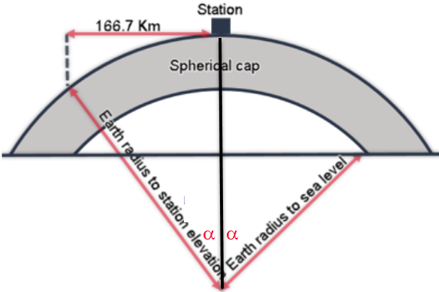

Curvature (Bullard B) Correction Gc
The purpose of the curvature correction as a step in producing the Bouguer anomaly is to convert the geometry for the Bouguer correction from an infinite slab to a spherical cap whose thickness is the elevation of the station and whose radius (arc length) from the station is 166.735 km. Curvature correction depends on the station elevation (e.g.,1.1 mGal at 1000 m, 1.5 mGal at 2000 m, 1.2 mGal at 3000 m, 0.2 mGal at 4000 m, -1.5 mGal at 5000 m and –3.9 mGal at 6000 m), and latitude (ranging in dozens µGal). LaFehr’s formula [6], is used here for the curvature correction.
Figure 1: Schematic illustration (not to scale) of the spherical cap in Bullard B correction. The spherical cap surface radius of 166.7 Km, which is the outer radius or the Hayford-Boweie Zone O, is based on minimizing the difference between the effect of the cap and that of an infinite horizontal slab [LaFehr, 1991].
LaFehr expands the Bullard B correction calculation as per below:
Where:
BB: Bullard B correctionγ: Gravitational constantρ: Densityh: Elevation (from sea level)R: Earth radius to the station:
Where:
Ro: Earth’s sea level radius at the survey location
μ: Dimensionless coefficient:
λ: Dimensionless coefficient:
Where:
α = The half angle subtended at the earth’s center by the section of the earth’s surface at sea level for which the outer distance from the station is normally taken to be 166.7 km.
For context, below is what each of the Bullard corrections refers to:
- Bullard A: approximates the local topography (or bathymetry) by a slab of infinite lateral extent, constant density, and thickness equal to the elevation of the point with respect to the mean sea level.
- Bullard B: curvature correction, which replaces the Bouguer slab by a spherical cap of the same thickness to a distance of 166.735 km.
- Bullard C: terrain correction, which consists of the effect of the surrounding topography above and below the elevation of the calculation point [Nowell, 1999].
