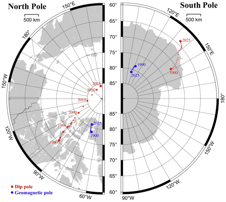

The illustration below depicts the motion of the geomagnetic north and south poles since 1900.
Figure 1: Motion of Magnetic Pole and Dip since 1900. The geomagnetic pole is theoretical and cannot be located directly, while the magnetic (dip) pole describes the two locations where the planet's magnetic field is vertical to Earth’s surface. The scale indicates the distance on the WGS84 ellipsoid, which is correct along lines of constant longitude and the middle lines of latitude shown. The maps use stereographic projection. The left and right panels use different longitude ranges. Image downloaded from MS Bing.
