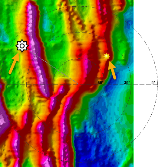

When you click the Interactive Shading button, an overlay, as illustrated in the image below, is displayed and centered on the view. This serves as a guide, providing you with additional information:
Two lines intersecting at the center of the view, which represents the rotation point.
Three circles that represent the inclination of 0, 30, and 60 degrees. (The inclination of 90 degrees is at the central focal point.)
The sun location, represented by the yellow sun symbol, at the existing Inclination and Declination location.
Moving the mouse cursor will show the interactive sun (
) at the new location with a line extending to the center of the view (the rotation point). The sun moves with the cursor, and the image updates. The current inclination and declination values are updated in the status bar (lower-left corner) as long as the cursor is within the view of the image.
