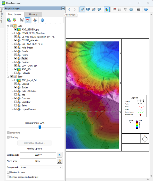

Map Manager
The Map Manager tool, embedded inside every single Map window, shows all the layers contained within the currently open Map document. Any layers that have been added or drawn to the map will be visible in the Map Manager tree.

You can use the Map Manager to edit raster and vector layers, to rename or remove layers, and to change the appearance, transparency and visibility options for any map layers displayed in the Map document:
Right-click on any of the layers in the tree, and perform simple operations like Zoom to Selection, Delete Group, Rename, or make the layer Movable. Note that the child nodes under a LYRX layer cannot be deleted.
Right-click on a vector group layer, and the Edit Vector Group and Export to GDB context menu options are activated.
Right-click on a CSYMB group layer, and the Colour Tool and Export to GDB context menu options are activated.
Right-click on multiple selected CSYMB layers, and the Colour Tool context menu option is activated. -
Right-click on a selected AGG layer*, and the following context menu options are activated: Colour Tool, Smoothing, Shading, and Interactive Shading.
Right-click on multiple selected AGG layers, and the following context menu options are activated: Colour Tool, Smoothing, and Shading.
To select single layers in the tree, click on the intended layer and it will be highlighted to indicate your selection.
Multiple selections of layers or groups within a view can be achieved by holding the Ctrl key and clicking on the desired items. Changing the selection during group editing will end group editing without canceling any current changes.
*The Colour Tool and Smoothing options are not available for image grid layers.
Folder Structure
You can control the visibility of multiple layers by organizing them into folders and subfolders. New folders can be added to views by right-clicking on the view name. One additional level of folder can be added to folders. Folders can only be two levels deep. Attempting to add a third level will simply not result in any action. The default folder name is "New folder". To change the name of the folder, press the F2 key or double click on the entry. New folders are added to the top-most node of a view or a folder.
Groups from the same view can be dragged and dropped into folders by panning the cursor to the folder name (in which case they will always append at the top) or to any point in the folder tree, provided it is expanded. Dragging and dropping groups into a collapsed folder will always expand the folder; all contained folders and layers will retain their original collapsed or expanded state.
Folders within the same grouping can be moved out of their parent folders into either the main tree or another parent folder.
Layers on a map are rendered in the top-down order of the groups in the Map Manager. The render order of views, folders, and groups can be changed by dragging and dropping them at the desired location. Modifying the rendering order also works for multiple selected groups.

Map Layers Tab Options
Toolbar |
Save Changes |
Saves changes to the map. |
Discards changes made to the map. | |
Open 3D View |
Enabled when a 3D view is selected. Click on the button to open the view in the 3D view er. |
Select View Mode |
Click this button to switch between views (e.g., Data view (ground coordinates), Base view (map coordinates) , Section view , etc.). |
Select Group Mode |
Click this button to select the different groups in a Map (rasters, vectors, and other graphics layers). Once selected, you can move, cut, copy or edit the group. |
Edit Vector Group |
Click this button to start editing the selected vector group. |
Colour Tool |
Click this button to activate the Colour Tool for the selected AGG layer or colour symbol (CSYMB) group. A double click on the layer has the same effect as clicking the Colour Tool button. The tool enables you to interactively edit the colour display of the selected layer, to store your custom colour configuration in specialized colour scheme files (*.ITR, *.AGG, *.ZON, *.TBL, *.LUT), and to apply the colour scheme file to the selected layer. This button is not available for image grid layers as they are not supported by the Colour Tool. You can select multiple AGG layers or multiple CSYMB groups within a view and assign the same colour scheme and colour distribution to all selected items. The Colour Tool will then open, and you can further revise the colour properties and apply the changes simultaneously to all your selected data. |
Smoothing |
Click this button to toggle the "smoothing" option on/off:
This button is not available for image grid layers. You can select multiple AGG layers within a view and toggle the smoothing option on/off for all selected items. |
Adding a shading effect to the colour grid (AGG_layer) emphasizes the subtle changes in the data that would otherwise be subdued. Click this button to toggle the "shading" option on/off:
You can select multiple AGG layers within a view and toggle the shading option on/off for all selected items. |
Interactive Shading |
If the Shading option is active, this button becomes enabled. Click on the button to activate the Interactive Shading tool and proceed to change the sun angle in real time. |
Help |
Opens this Help topic. |
Display Options |
Transparency |
When a group is selected, the transparency slider becomes enabled. Initially all groups are opaque. Use the slider to modify the transparency of the selected group. |
Smoothing |
When an aggregate (AGG) layer is selected, this option becomes enabled and acts as a toggle to turn on/off image smoothing:
The initial state of this option is set during the process of displaying the colour image on the map. This button is disabled for image grid layers. You can select multiple AGG layers within a view and toggle the smoothing option on/off for all selected items. |
Shading |
When an aggregate (AGG) layer is selected, this option becomes enabled and acts as a toggle to turn on/off image shading. Shading emphasizes the subtle changes in the data that would otherwise be subdued.
Enabled when an aggregate (AGG) group is selected and the Shading context menu option is selected. Click this button to activate the Interactive Shading tool and proceed to change the sun angle in real time. |
Visibility Options |
Visible scale |
Click this button to set a scale range in which the currently selected Group will be visible.
Fixed scale |
Click this button to freeze the scale of the currently selected Group, at a specified value.
Group mask |
Select a group mask region from the list to mask selected group(s) within the view to the specific named area. Select "None" to remove the masking from the selected group(s). Group masking provides a way to hide certain parts of a map without the need to edit or subset the original data. |
Masked to view |
Every map has a default "view mask" that is the rectangle of the data extents. This is the mask used when you select the [Masked to view] option. |
Render images and grids first |
Check this box to render (draw) any raster images and grids first (i.e., as the bottom layer). |

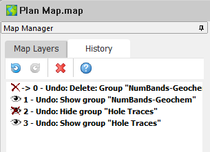

History Tab
This tab is used to keep track of your map editing and provides unlimited undo/redo functionality.
