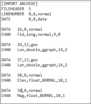

IMPARC requires a template file, which describes the contents and format of the formatted ASCII file and the database channels in which the data will be placed. The template is a text file with the extension (*.i3) that can be edited in a text editor. The "imparc.i3" file, which can be found in the Geosoft folder (C:\Program Files\Geosoft\Desktop Applications \etc), is a blank self-documented template that can be used to create your own templates and as a reference for the contents and structure of a template. See I3 Import Template File for a description of the template file format and parameters.
