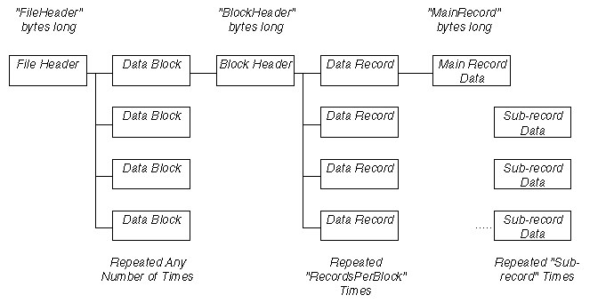

Blocked Binary Data Format
Many types of data are stored in a fixed-block binary format — a binary file consisting of a specific quantity of data. The total number of bytes or quantity of data defines a data storage unit called a block. A blocked binary file has the following format:
Data is organized systematically within each block, so that specifying the offset (in bytes) from the start of the block and the total length (in bytes) can retrieve it. When compared with the variable-record format, fixed format may require more storage space; however, it is more efficient for rapidly accessing and retrieving stored information.
A blocked binary file has the following basic binary structure:
[file header] "FileHeader" bytes long
[data block] "BlockSize" bytes long
[data block] repeated any number of times
Each [data block] has the following structure:
[block header] "BlockHeader" bytes long
[data record] "RecordSize" bytes long
[data record] repeated "RecordsPerBlock" times
Each [data record] has the following structure:
[main record data] holds once-per-record data
[sub-record data] starts at "SubRecord start" offset in the [data record].
[sub-record data] each sub-record holds "Subrecord length" bytes.etc repeated
[sub-record data] "SubRecord number" times.
Data is extracted from the [main record data] and [sub-record data] and placed in the database.
