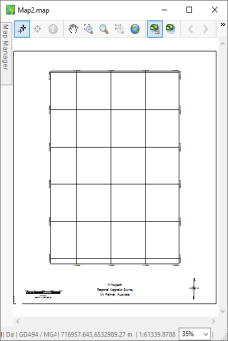

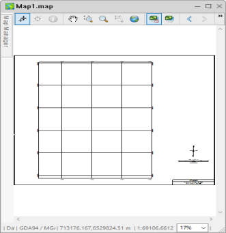

Map style |
Select either a Full Map (select Map) or Figure (select Figure) style map. The Full Map style is normally used for A1/A0 size maps, the Figure style map for A3/A4. |

Full map and figure style layouts:
