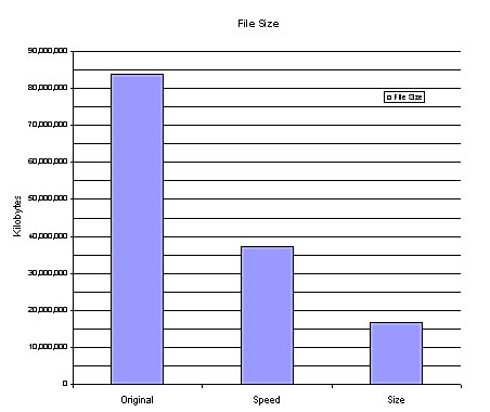

Databases are compressed for storage using the lossless open source library at https://zlib.net. This library supports compression for speed and for size.
The speed and performance values here are considered best-case scenarios where the majority of data in the database is stored as doubles, and the databases are large. Speed and size benefits will be less with other data types, and with smaller databases. Databases with lots of short lines and channel (such as Wholeplot databases) will see little benefit from compression. The chart below shows the effects of a each compression method on a large database.

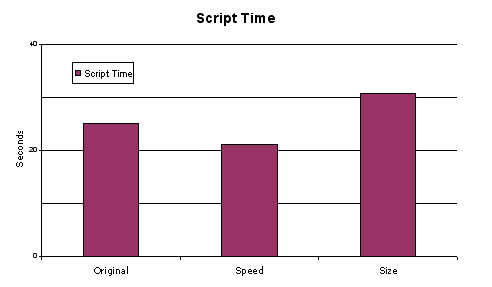

Script Processing Time
The chart below shows the effects of database compression on script processing time.
