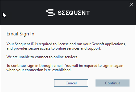

Once the 90 days have passed, the license will lapse, and you will be prompted to sign in via email.
- Click Continue and an email to the Seequent ID Service, with the subject "Seequent ID Sign In Request", is displayed.
Send the email and the second Email Sign In dialog appears.

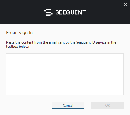

- Once you receive a follow-up email response from the Seequent ID Service, copy the content of the returned email and paste it into the window provided in the Email Sign In dialog.
- When you sign in by email, you will be prompted to sign in again when reconnected.
Click OK. Your software license will be updated and you can continue working offline for another 90 days.
