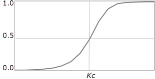

The Resistance Capacitance filter is excellent for smoothing the gravity data.
Parameter:
| kc |
Central wavenumber of the filter. |
