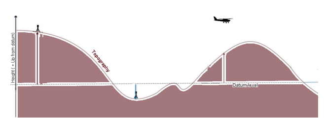

       Figure 1: Schematic illustration of elevation channels and direction

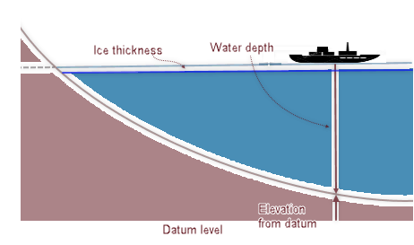

     Figure 2: Schematic illustration of relation between elevation from Datum and water depth/ice thickness
