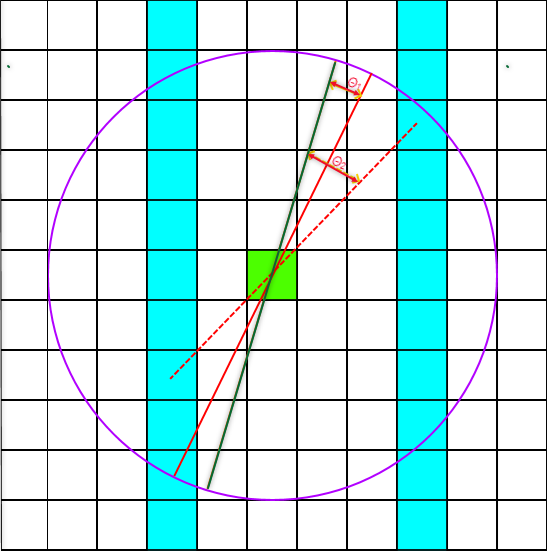

    In Figure 1 below, the original trend direction, determined by the structure tensor, is shown as an orange line. If it does not intercept real data within the search radius, the angle is changed by Theta (red solid line), and the search for real data is attempted again.
    It is recommended to set the angle relatively small but greater than 0° not to deviate from the trend direction determined by the structure. On the other hand, a very small angle may increase the number of iterations and make the gridding process slower.
    Figure 1: The blue cells contain real data; the green cell is the cell being analyzed; the purple circle is the search radius distance variable.
