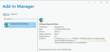

To create your own style file (.stylx) in ArcGIS Pro, you must first install the add-in developed by Seequent.
Install the EsriExportSymbolToStyle Add-In:
  • Browse to the installation folder of your Geosoft Desktop Applications and expand the bin directory.
  • Navigate to the LayerX > AddinX folder and select the ESRI AddInX file (.esriAddinX) that is compatible with your version of ArcGIS Pro.
  • Double-click the file to launch the Esri ArcGIS Add-In Installation Utility.
  • Review the installation details and click Install Add-In to proceed.
After the installation completes, open ArcGIS Pro. If it was already running, restart the application to load the new add-in.
View the Add-In Manager:
  • Open the Settings page in one of the following ways:
    • From an open project, click the Project tab on the ribbon.
    • From the start page, click the Settings tab.
  • In the side tab list, click Add-In Manager.
  • On the Add-ins tab, locate and click EsriExportSymbolToStyle to view details about the installed add-in.
    When you install an add-in using the installation utility, it is copied to the default location: %System Drive%\Users\<username>\Documents\ArcGIS\AddIns\ArcGISPro. Before copying the file, the utility checks whether a newer version of the add-in already exists in that location.

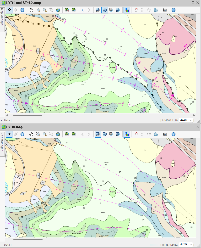

Using the .stylx File in Oasis montaj or Target:
When importing your LYRX file into an Oasis montaj or Target project, include the .stylx file as the input Layer Stylx file. This helps ensure that the symbols in the added layer are interpreted correctly on your map.
The first map shown bellow illustrates the enhanced symbology applied when the LYRX file, identical to the one in the second map, is imported along with its corresponding style file.
