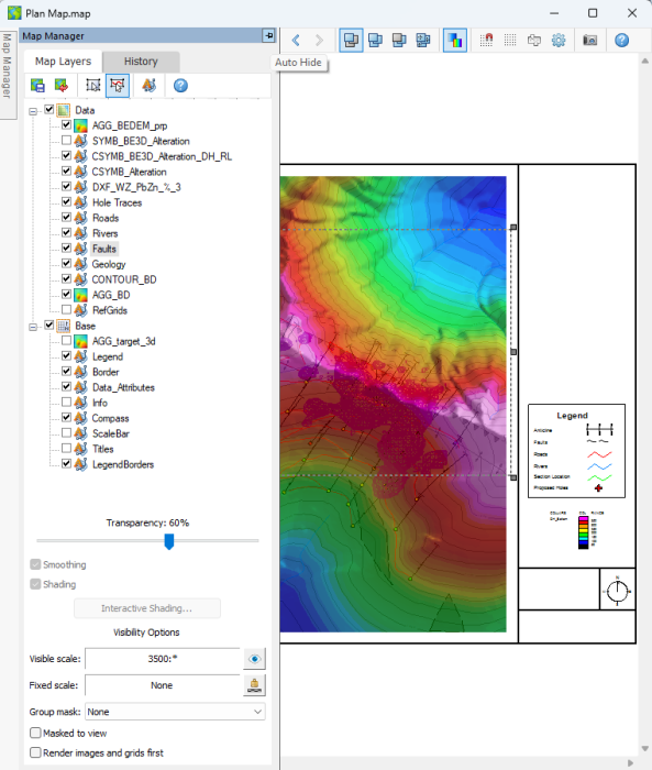

The Map Manager tool, embedded in every Map window, shows all layers in the currently open Map document. Any layers added to or drawn on the map are visible in the Map Manager tree.
Views
Maps are composed of "views". A view is a coordinate translation and a masking region. By convention, Geosoft maps consist of a ‘Base’ view, which uses paper coordinates with an origin at the paper origin, and a ‘Data’ view, which uses ground coordinates. Map surrounds, for instance, are plotted in Base views and map coordinate contours and grids are plotted in Data views.
Groups
Each view may contain a number of graphic groups. A graphic group is a set of graphics elements that make up a graphic component of the map. For example, a line path plot, a contour plot or a profile plot would all be separate graphics groups within the Data view.
Map Layers Tab
Map layers are sometimes referred to as map groups and are often shown within a larger container called a view . Map views organize the various layers into similar coordinate spaces: a Base view, for example, uses paper coordinates (e.g., cm or inches), while a Data view uses ground coordinates (e.g., Eastings and Northings, or Latitude and Longitude). You might also see other views such as Section, Profile, or 3D views. 3D views contain real-world coordinates and are preceded by the image\ebx_-1865674130.jpg icon, which corresponds to the button on the toolbar that opens the view in the 3D Viewer.
  • The visibility of the views on a map can be toggled on and off using the preceding check box, without actually removing them from the map.
  • Each view contains a number of map layers or groups. For example, a line path group in ground units will reside in the Data view, while a legend bar defined in cm units will reside in the Base view.
    Groups are displayed with an icon representing the type of data they contain in the map, followed by a unique group name.

    Map Layers - Display Options
    Transparency
    When a group is selected, the transparency slider becomes enabled. Initially, all groups are opaque. Use the slider to modify the transparency of the selected group.
    Smoothing
    When an aggregate (AGG) layer is selected, this option becomes enabled and acts as a toggle to turn image smoothing on or off:
    • When this option is checked, the grid is first interpolated to the resolution of the monitor, then displayed.
    • Uncheck the option if you prefer to honour the grid resolution. When this option is unchecked, the image will appear pixelated, colours will be solid within each grid cell and change at grid cell boundaries.
    The initial state of this option is set during the process of displaying the colour image on the map.
    This button is disabled for image grid layers.
    You can select multiple AGG layers within a view and toggle the smoothing option on/off for all selected items.
    Shading
    When an aggregate (AGG) layer is selected, this option becomes enabled and acts as a toggle to turn on/off image shading. Shading emphasizes the subtle changes in the data that would otherwise be subdued.
    • When this option is checked, a grey-scale shadow is displayed superimposed on the colour image.
    • See the Shading note for details on how the shadow intensity is calculated.
    • Uncheck the Shading option to remove the shading effect.
    You can select multiple AGG layers within a view and toggle the shading option on/off for all selected items.
    Interactive Shading
    Enabled when an aggregate (AGG) group is selected and the Shading context menu option is selected.
    Click this button to activate the Interactive Shading tool and change the sun angle in real time.
    Map Layers - Visibility Options
    Visible scale
    Click this button to set a scale range in which the currently selected group will be visible.
  • Outside of this scale range, the group will automatically disappear.
  • Fixed scale
    Click this button to freeze the scale of the currently selected group, to a specified value.
  • Items like symbol size, line thickness, and font sizes will stay at the specified size and will be unaffected by the zoom level if this is set.
  • Group mask
    Select a group mask region from the list to mask selected group(s) within the view to the specific named area. Select "None" to remove the masking from the selected group(s).
  • If there are no group masks for the currently selected view, this option remains disabled.
  • Group masking provides a way to hide certain parts of a map without the need to edit or subset the original data.
  • Multiple group masks can be applied to a map so you can have multiple clip regions available while the default "view mask" is not changed.
  • Masked to view
    Every map has a default "view mask" that is the rectangle of the data extents. This is the mask used when you select the [Masked to view] option.
    Render images and grids first
    Check this box to render (draw) any raster images and grids first (i.e., as the bottom layer).
