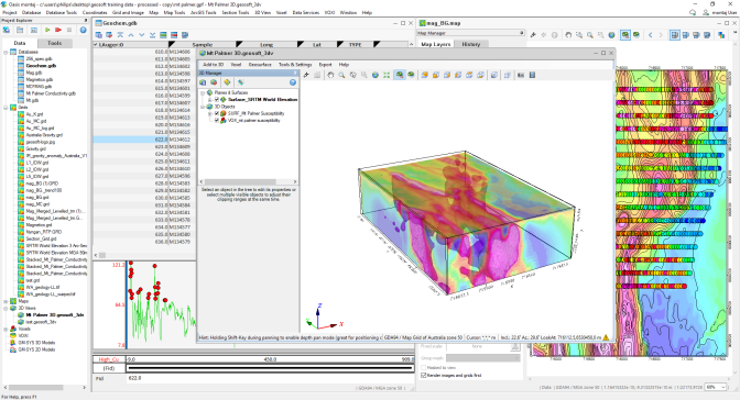

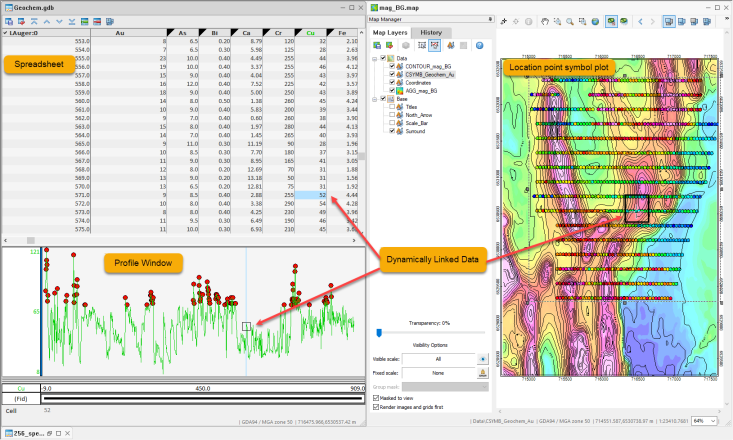

You'll use the desktop area to display your data in various formats, including spreadsheet, profile, grid, map, or 3D view.
The image below shows dynamically linked data displayed in spreadsheet, profile, and map views:

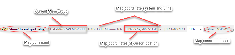

Located at the bottom of every window (e.g., maps, grids, voxels, 3D viewers), the status bar provides information about the currently selected data. This includes the current cursor position, and tooltips describing the purpose of buttons and interface elements within Oasis montaj.
The image below illustrates an example of status bar details from a 2D map window:
