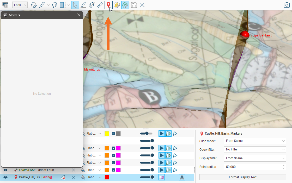

The Markers window will appear, along with a Place Marker button (
) in the toolbar:

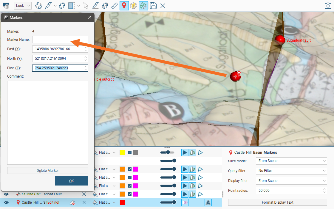

Click the Place Marker button, then click in the scene where you would like to add the marker. A new marker will be added to the table, along with its coordinates:
Enter a Marker Name and a Comment, if required, then click OK to save the table.

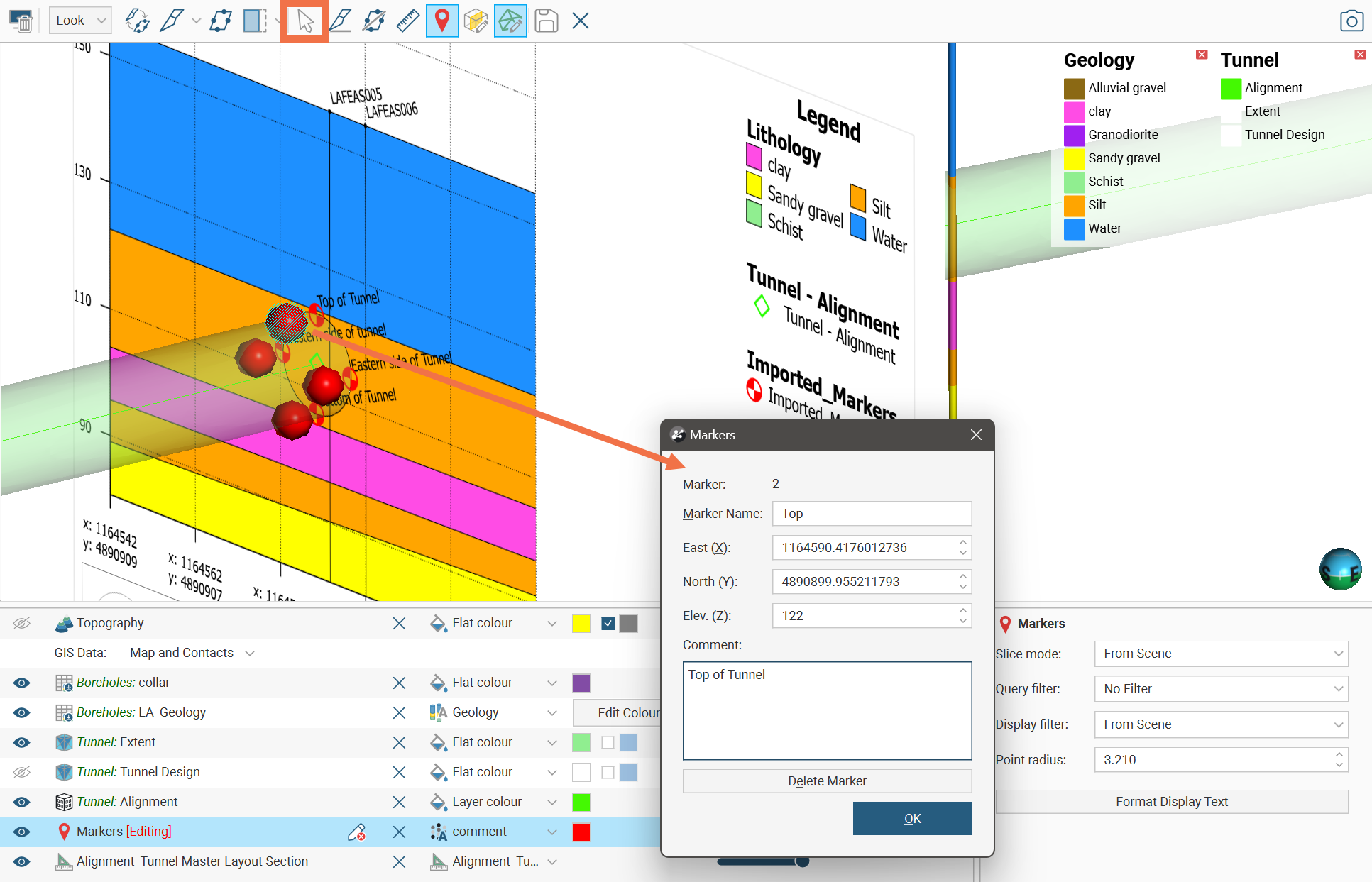

To make changes to an existing marker, right click on its marker table in the project tree and select Edit Markers. The Markers dialog window will appear. In the toolbar, click the Select icon (
) then click in the scene on the marker you wish to edit. The marker’s information will be displayed in the Markers window. You can then make changes to the Marker Name, the marker location and the Comment.

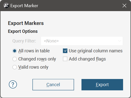

Right click on the marker table in the project tree and select Export. In the window that appears, select whether to export All rows in table, Changed rows only or Valid rows only. You can also choose to enable or disable the options Use original column names and Add changed flags.
When you click Export you will be prompted for a filename.
