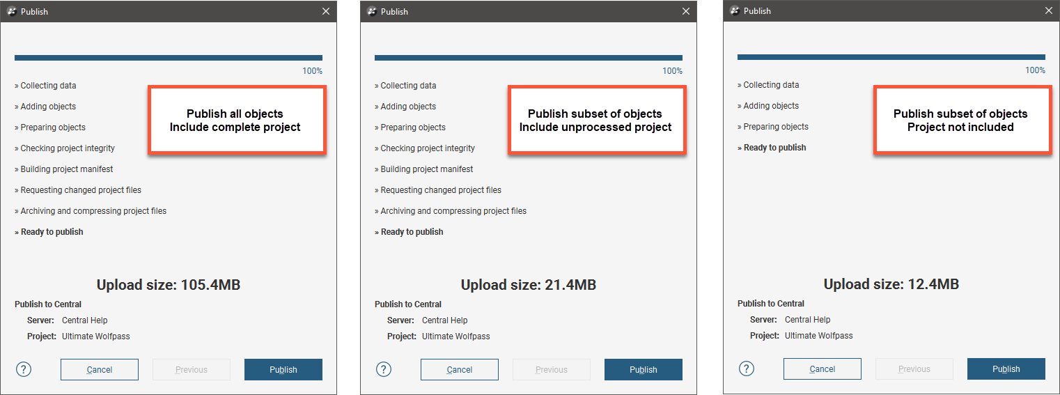

Another consideration in choosing when to publish is how large the publishing upload will be, as publishing many objects and/or including the Leapfrog Works project can result in a large upload that takes some time. Here, for example, are three upload summaries for the same project. The first upload includes all objects, plus the full project, the second includes a limited set of objects and an unprocessed version of the project, and the third upload is only a limited a set of objects:

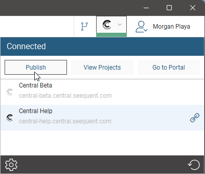

Initiating a Publish Event

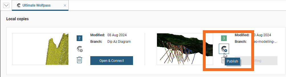

When you are ready to publish your revision to Central, you can start the publishing process by clicking on the Central button in the top right-hand corner of the screen and selecting Publish:
You can also use the Publish button (
) in the Local copies panel:
Leapfrog Works will then step you through the different options, which are described in the sections that follow.

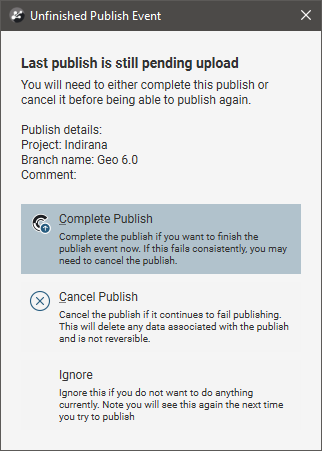

When you click Publish, you may receive a message saying there is an unfinished publish event:
This occurs when a previous publish event was interrupted. Choose from the options presented.
If the publish event was abandoned, it can be removed via the Central Portal.

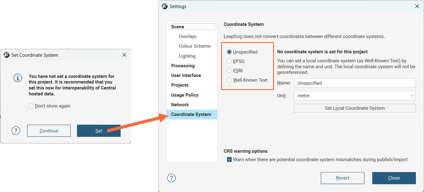

Setting a Coordinate System
If a coordinate system has not been set for the project, you will be prompted to set one when you initiate a publish event. Click the Set button to open the Settings window where you can set a coordinate system:
See Coordinate System Settings for more information.

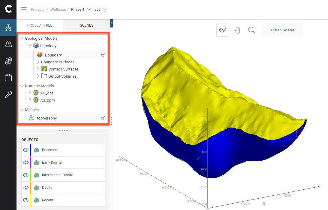

In this example, only four objects have been selected to be published:
In the Central Portal, it will be possible to visualise the Topography mesh, the surfaces in the Lithology geological model and the surfaces in the AG_gpt and AS_ppm numeric models from the Wolfpass project:
Unticked objects such as the Distance to collar mesh, the topography inside Distance to collar mesh, the Lithology on 9/10/2020 geological model and the AU_gpt numeric model will not be available.

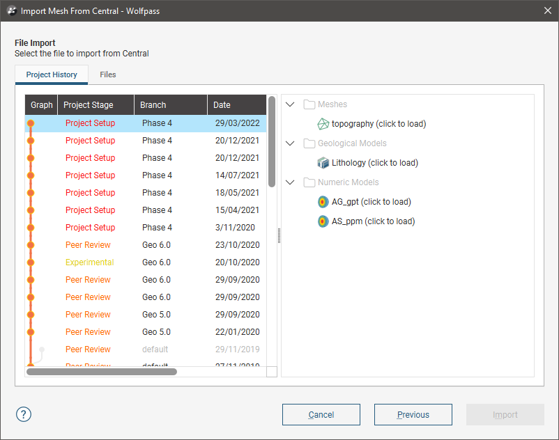

Another consideration in selecting the objects you will publish is whether or not you want to make a data object available for use in other revisions of the project or in other projects on the server. Published objects can be imported into other projects by team members who have permission to access the project from which the objects were published. For example, here the four published objects from the Wolfpass project can be imported into another project:

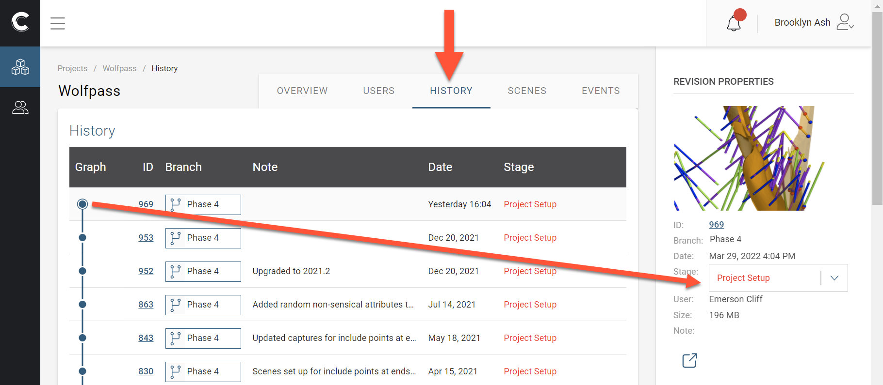

If you set the wrong project stage, you can change it later in the Central Portal, once the publish is complete. To do this, click on the project’s History tab, then click on the node for the revision you need to update:

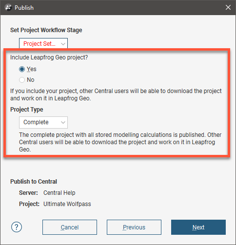

Including the Project
Whether or not you include the Leapfrog Works project along with the publish event depends on many factors, including whether it’s time to back up your work and whether or not other members of your team will need to work on the project in Leapfrog Works.
First choose whether or not to include the project. If you choose not to, the Leapfrog Works project will not be published and other Central users will not be able to download the project and work on it in Leapfrog Works. They will, however, be able to visualise and review the published objects and their history in the Central Portal.
If you are including the project, there are two options:
- Complete.This option publishes the complete Leapfrog Works project, including stored modelling calculations. Other Central users will be able to download the project and work on it in Leapfrog Works without reprocessing the project.
- Unprocessed. An unprocessed project has a smaller upload/download size because stored modelling calculations are removed. When an unprocessed project is downloaded again, all of the modelling calculations will need to be reprocessed from the underlying data. Other Central users will be able to download the project and work on it in Leapfrog Works. Depending on the size of the project, reprocessing may take some time.

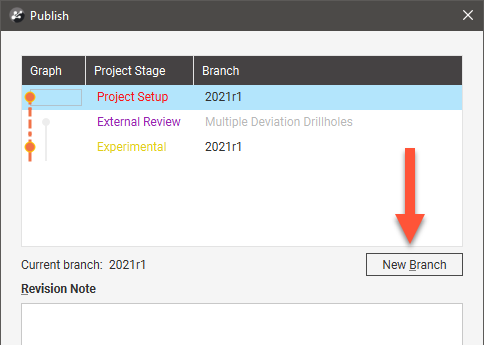

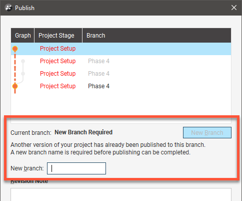

Branches are created in Leapfrog Works as part of the publishing process:
Branches cannot be created in the Central Portal, although they can be renamed.
If the revision you have been working in is the most recent on that branch, you can publish to that branch. However, you cannot publish to a different branch, even if your revision is more recent than the revisions on that other branch.
If, however, there is a more recent revision on the current branch, you will receive a message saying you need to publish to a new branch:
Most likely, this has occurred because another team member has download a copy of the project and published a revision to Central. If you wish to prevent other Leapfrog Works users from publishing to that branch while you work on it, you can lock the branch, as described in Locking Branches in the Central Projects topic.

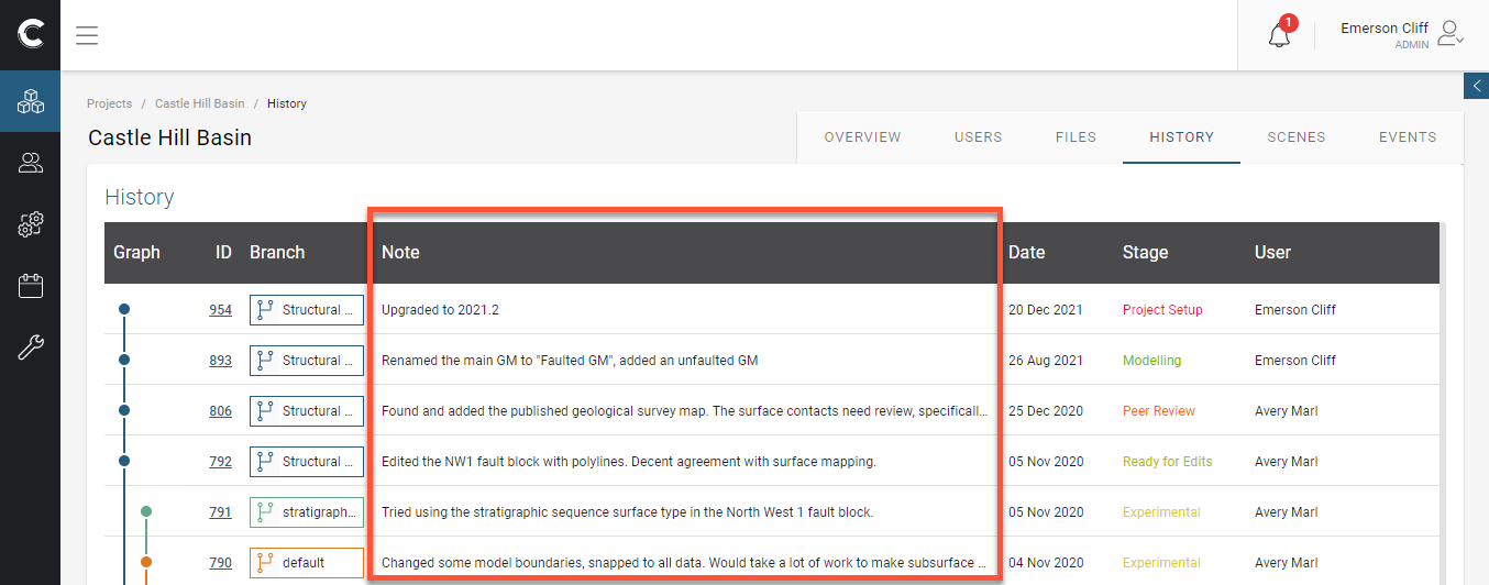

Adding a Revision Note
Enter information about the new revision; this will appear in the project’s history and is useful for keeping track of work carried out by different team members:

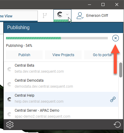

Once you set the various options for the publish event, Leapfrog Works will prepare the package. Disable the Auto upload option if you wish to review the summary before starting the upload. This gives you the option of cancelling the upload before it starts. Otherwise, the upload will begin automatically once all the information has been packaged.
If for some reason you need to stop the upload, click on the Central dropdown menu and click the cancel button (
You can resume the upload by clicking Publish in dropdown menu.
