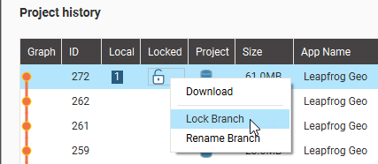

To lock a branch, right-click on it in the project history and select Lock branch:
In the window that appears, set the Lock duration and add any comments. The lock can be set for as little as one day; when the lock expires or when a new publish is completed, the branch will be unlocked for other users. While the branch is locked, other users are still able to download projects, create new branches and publish to branches that are not locked.

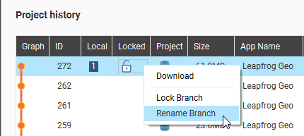

Renaming Branches
To rename a branch, right-click on it and select Rename:
Enter a new name for the branch, then click OK. The project’s history will be refreshed.

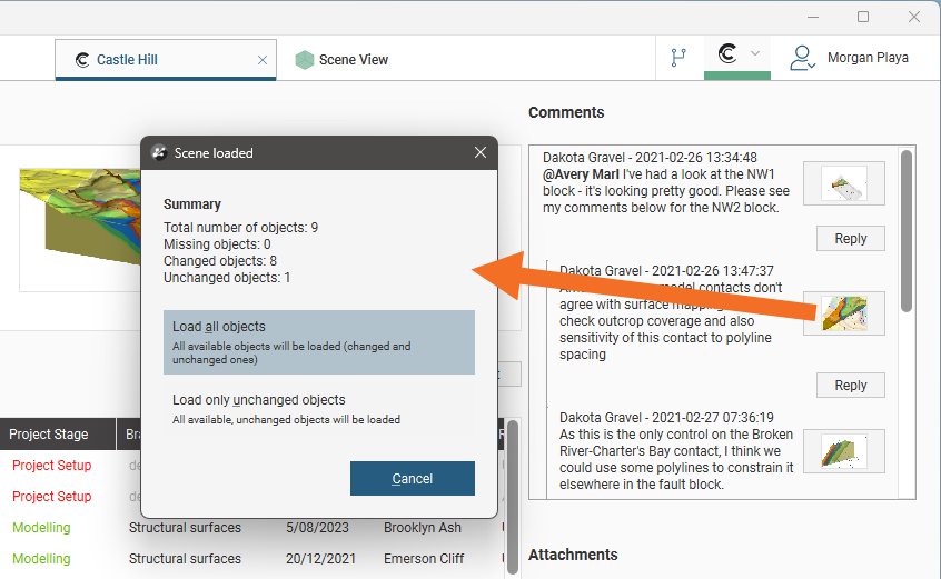

With comments, Leapfrog Works, Central Portal users can carry out conversations about specific aspects of the model. Comments include a scene snapshot to help you point out specific features in a model to your team. If you already have the project downloaded and open in Leapfrog Works, you can load the current version of the object referred to by the comment. Click on the scene snapshot; you will be prompted to load all the objects or only the unchanged objects:
If the snapshot has a geotag, it will be added to the shape list and displayed in the scene.

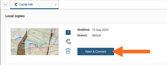

Click the Open & Connect button in the Local copies panel to open the project:
Work in the project as you would any other Leapfrog Works project, then once your work is complete, you can publish a new revision, as described in the Publishing to Central topic.

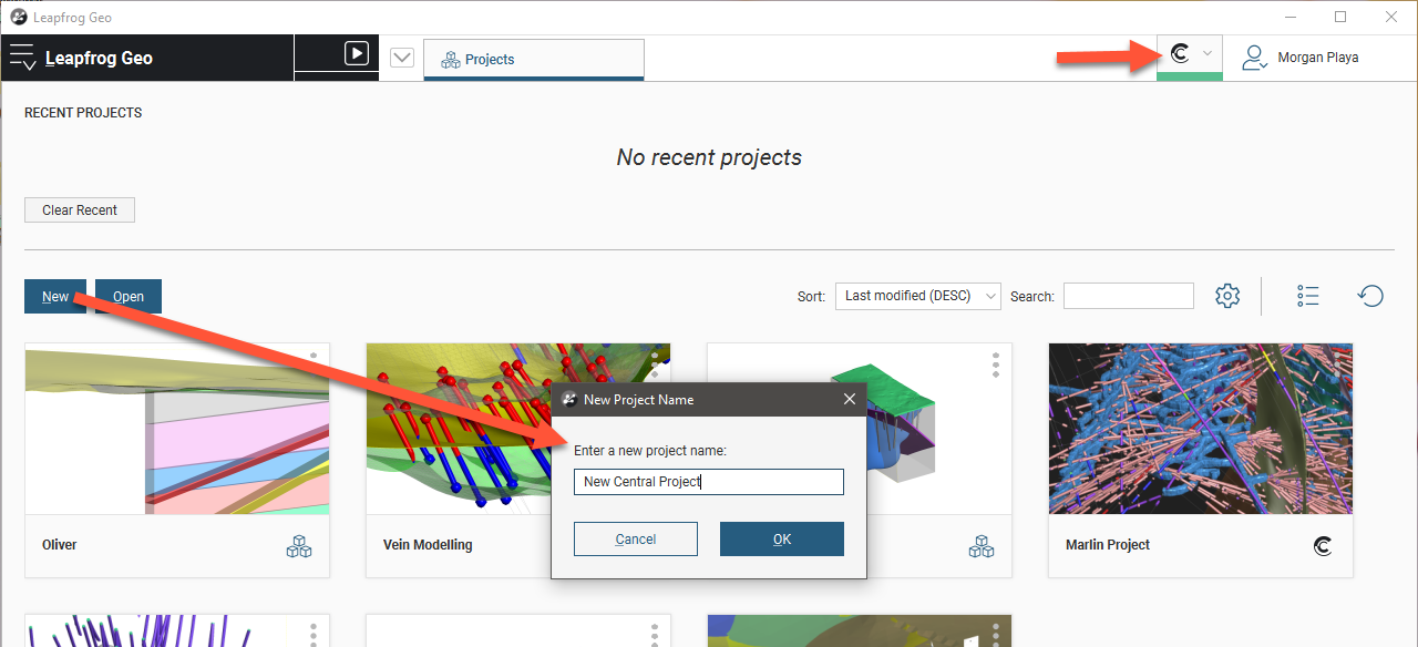

Creating a New Central Project
Use this option to create a new Leapfrog Works project and put it into Central. In the Projects tab, first make sure you are connected to the Central server you wish to add the project to. Then click the New button:
Enter a name for the project and click OK.
A new Leapfrog Works project will be created and saved in the location on your local drive specified in the Settings > Projects window.

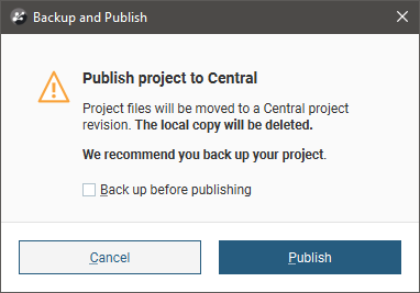

When prompted, enter a name for the project and click OK. Next you will be prompted to backup your project before it is published to Central:
Tick the box to back up the project, then select where on your local drive you wish to save the backup. Once the backup has been created, a new Central project will be created and the existing project will be copied to the location on your local drive specified in the Settings > Projects window.
