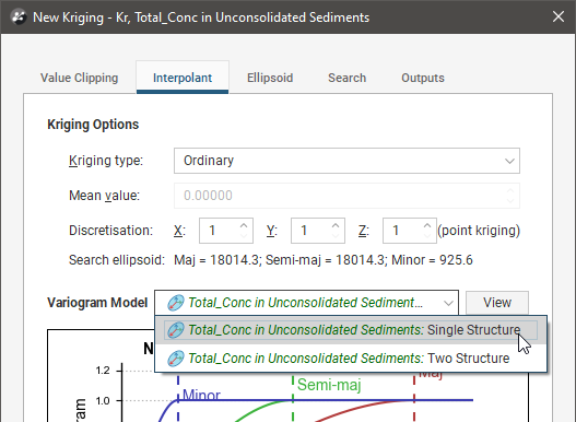

You can define as many variograms as you wish; when you define an estimator that uses a variogram model, you can select from those available in the estimation’s Spatial Models folder:

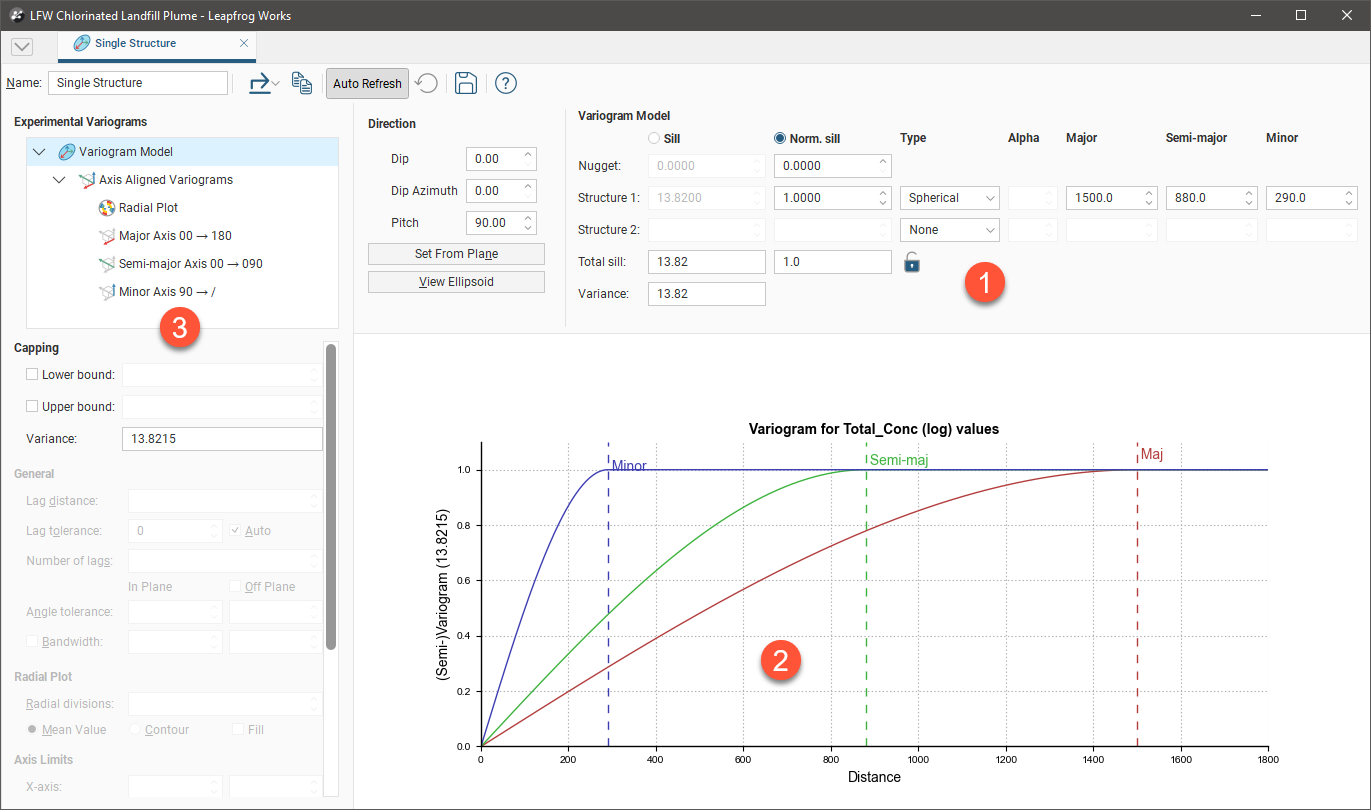

The Variogram Model Window
The Variogram Model window is divided into three parts:
Variogram model controls for adjusting the variogram model type, trend and orientation. See Experimental Variography and Variogram Models below.
Graphs plotting the selected variogram
Experimental controls for verifying the theoretical variogram model. See Experimental Variography and Variogram Models below.
When you edit a variogram model in the Variogram Model window, an ellipsoid widget is automatically added to the scene. The ellipsoid widget helps you to visualise the variogram in 3D, which is useful in setting variogram rotation and ranges and in defining search neighbourhoods.

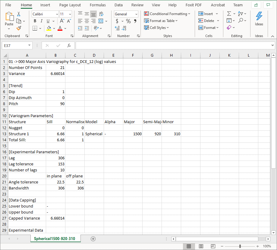

Additionally, you can save variogram parameter data by selecting a theoretical variogram from the list, clicking the Export button () and selecting Export data from the options. Note that Export data is not available for the experimental variogram or the Radial Plot.

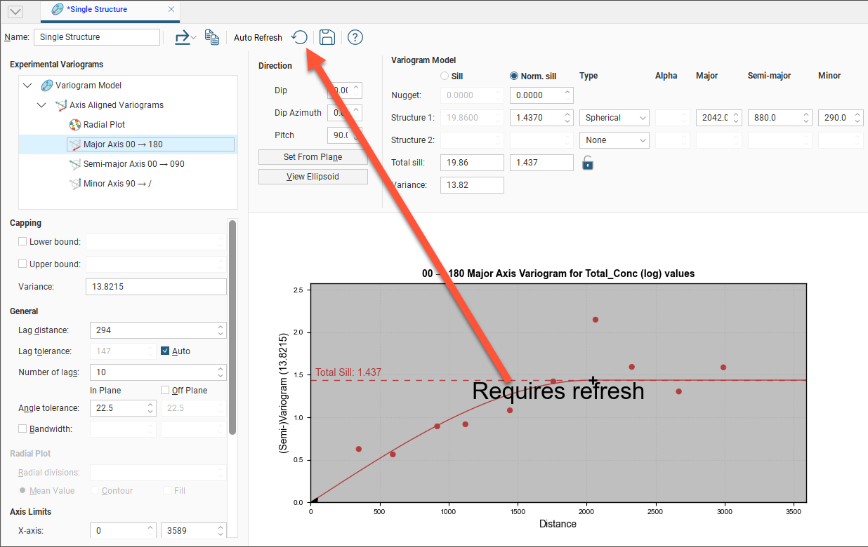

There are two buttons for refreshing the graphs when changes are made:
  • When Auto Refresh is enabled, recalculations will be carried out each time you change a variogram value. This can produce a brief lag.
  • When auto refresh is disabled, you can click the Refresh button () whenever you want the graphs to be updated. This is the best option to use when working with a large dataset.
If auto refresh is disabled and values have been changed without the graphs being updated, the chart will turn grey and a reminder will be displayed over it:

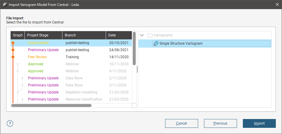

To import a variogram model stored in a Central project, right-click on a Spatial Model folder under the target estimation and select Import Variogram Model > Central. Select the project where the variogram model object has been stored, then select the appropriate revision from the version tree. The variogram models available in the project will be listed; select one, then click Import.
