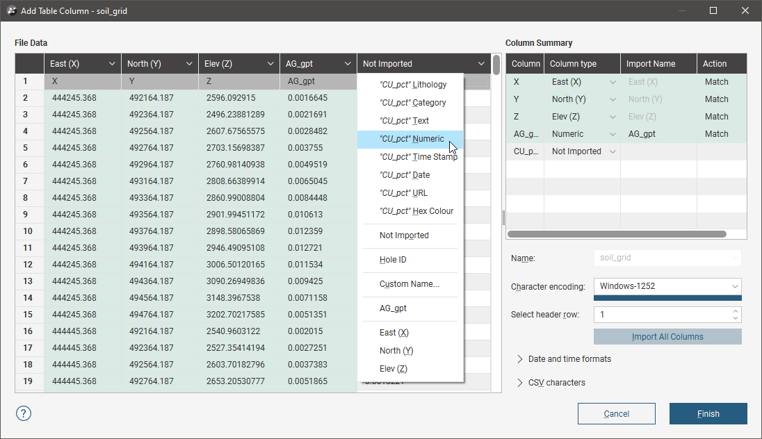

If new columns of data are available or if when you imported a table into Leapfrog Works you did not import all the available columns, you can add more columns by right-clicking on the existing table and selecting New Column > Import Column. You can choose the file to use as part of this process, so the new columns can be in the original file or in separate files.
Importing a column is similar to importing tables themselves. Leapfrog Works will display the data in the file in the Add Table Column window and you can select how you wish to import any additional columns. Here, we will import the CU_pct column as numeric data:
It is not necessary to re-import any columns that are already part of the project.
Click Finish to import the new column.
