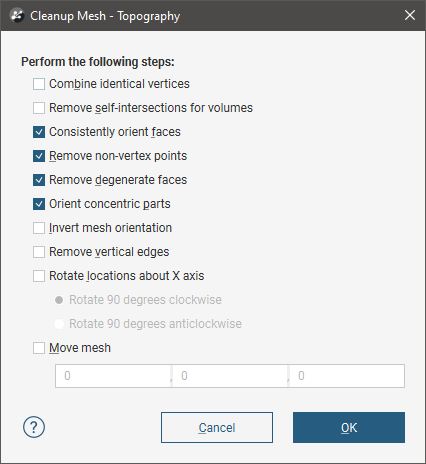

There are several options for cleaning up a mesh that can be applied to meshes imported into Leapfrog Works and to non-editable meshes created in Leapfrog Works.
The next four options are automatically applied to meshes created in or imported into Leapfrog Works:
- Consistently orient faces ensures that a mesh can be used for inside/outside testing.
- Remove non-vertex points removes points that are not used by any triangles.
- Remove degenerate faces removes triangles with duplicate vertices.
- Orient concentric parts ensures that internal parts have the correct orientation.
Other options are:
- Invert mesh orientation reverses the polarity of the mesh.
- Remove vertical edges removes any vertical faces from the mesh boundary.
- Rotate locations about X axis lets you rotate the mesh 90 degrees clockwise or anticlockwise.
- Move Mesh lets you offset the mesh by a vector. Tick the Move Mesh box and enter the required values. The offset values can be changed by opening the Clean Mesh window once again.

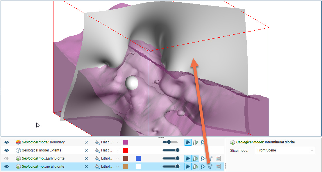

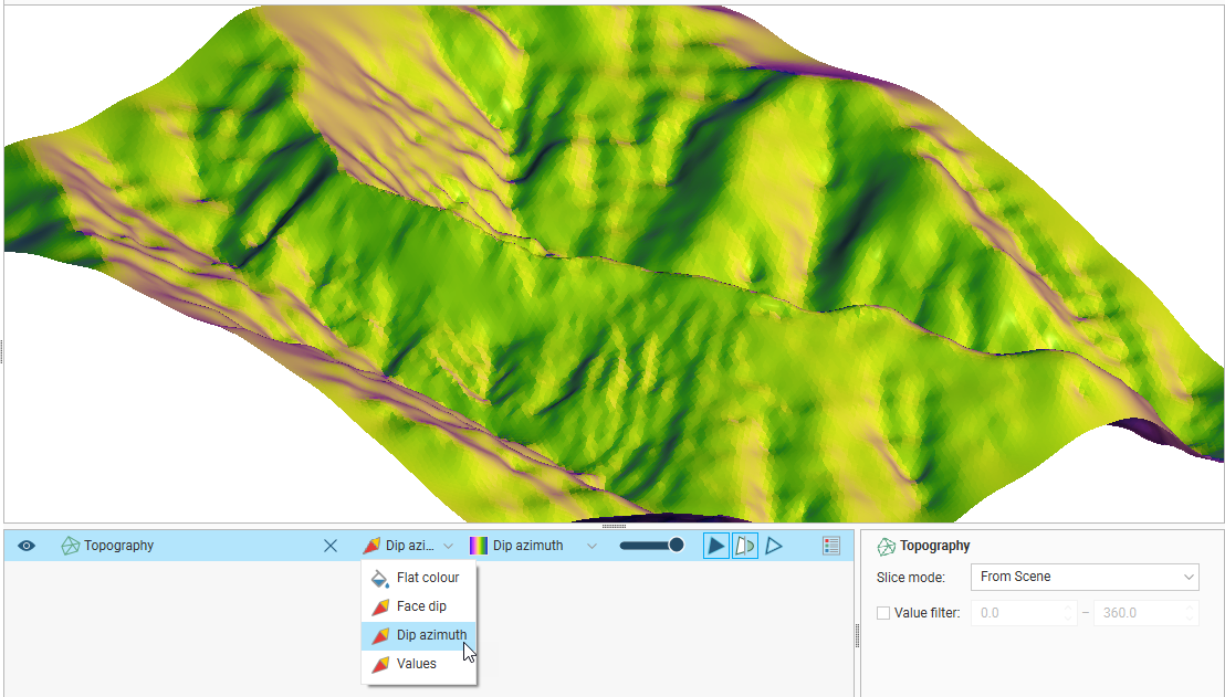

Many meshes in Leapfrog Works can also be displayed using other properties, such as the Dip azimuth of the surface, which can be useful in highlighting areas of the surface that change direction rapidly:

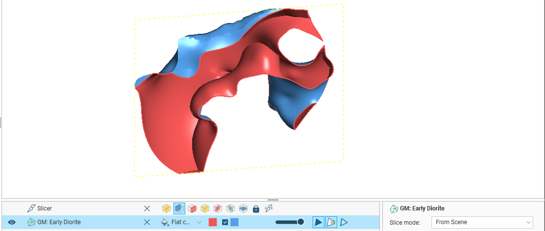

Disable the Clipped surface button (
) to view the surface unclipped:

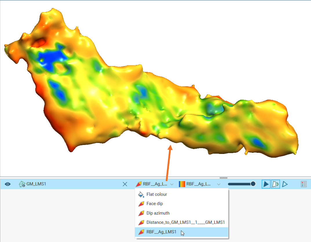

Leapfrog Works supports the import of attributed meshes in GOCAD (*.ts) and Leapfrog Works Attribute Binary Mesh (*.msh, *.ara) file formats. You can display such meshes using an attribute by selecting the attribute column from the view list.

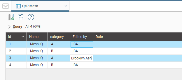

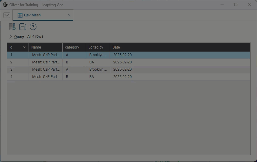

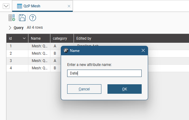

You can assign attributes to a mesh, which adds a new column to the mesh object. To do this, right-click on the mesh in the project tree and select Attribute Table. In the window that appears, click the Add new attribute column button (
). In the window that appears, select the attribute type:

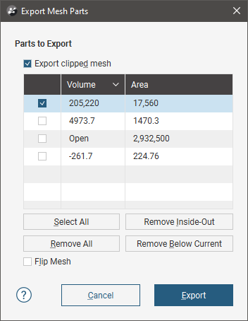

Exporting Meshes
Leapfrog Works exports meshes in the following formats:
- Leapfrog Attribute Binary Mesh Format (*.msh)
- GOCAD Files (*.ts)
- Gemcom Files (*.tri)
- Datamine Files (*_pt.asc, *_tr.asc)
- Micromine Files (*_MMpt.dat, *_MMtr.dat)
- Surpac Files (*.dtm, *.str)
- DXF Polyface Files (11/12 [AC1009]) (*.dxf)
- Alias Wavefront Object Files (*.obj)
- Industry Foundation Classes 2x3 (*.ifc)
- Industry Foundation Classes 4.0 (*.ifc)
- Industry Foundation Classes 4X3 RC4 (*.ifc)

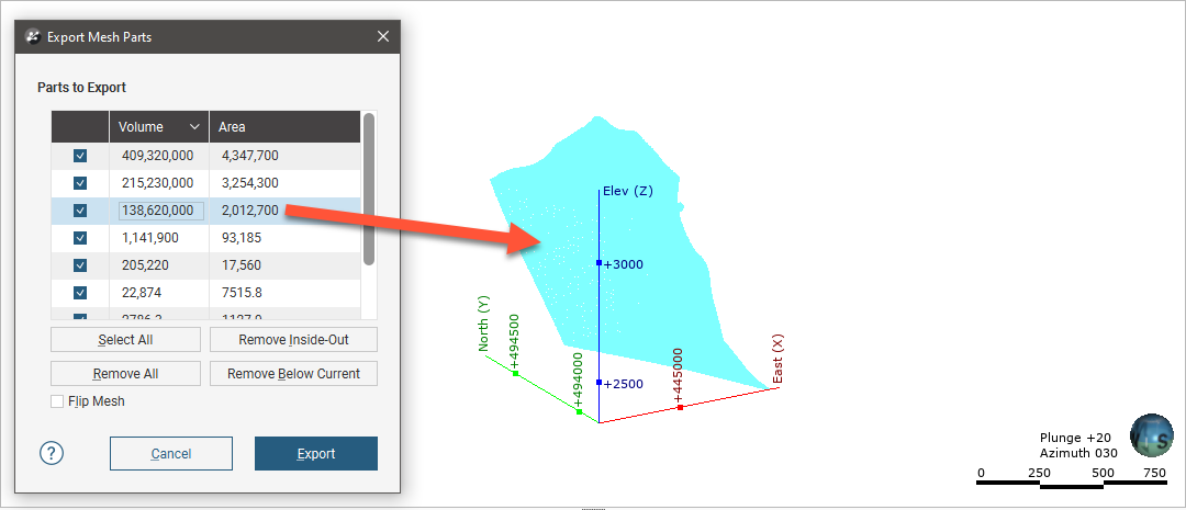

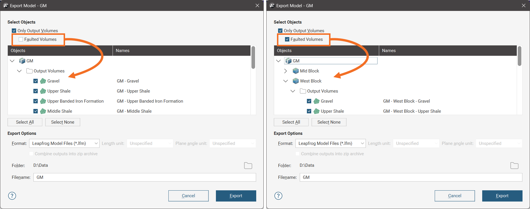

- Exporting a Single Mesh
- Exporting Multiple Meshes from the Meshes Folder
- Exporting Multiple Meshes from Models

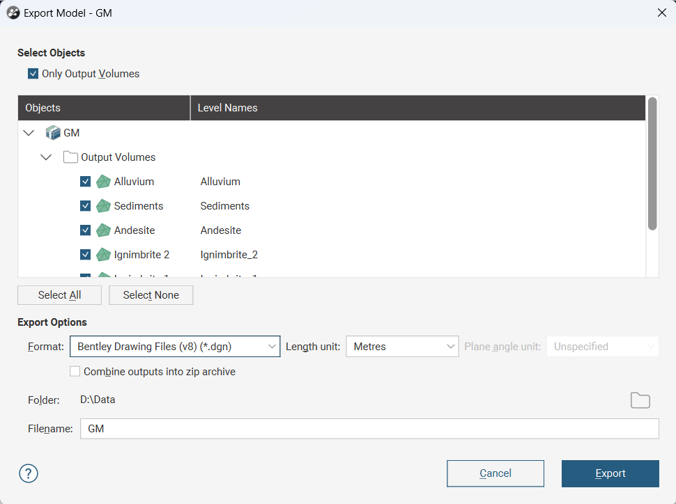

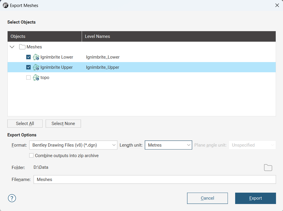

When exporting in Bentley Drawing Files (v8) (*.dgn) format, a Length unit needs to be specified.
For any of the export options other than Leapfrog Model Files format, you can save the meshes as a zip file. IFC files can be saved as an ifczip archive. See the Exporting Project Data to IFC topic for more information on the IFC formats supported.
