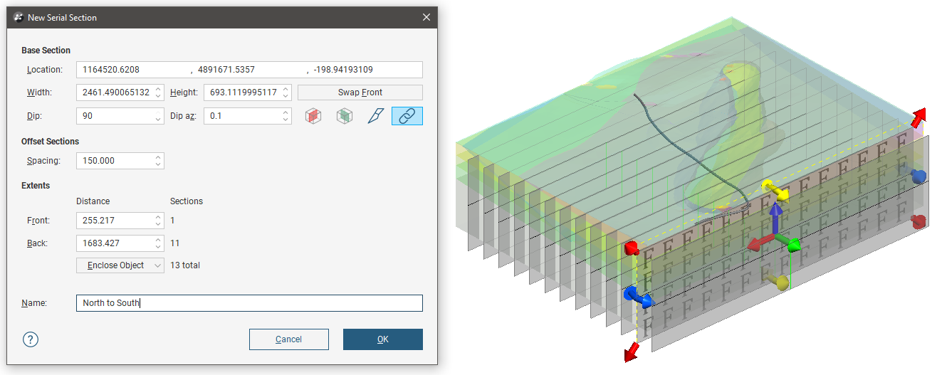

To create a serial section, add a model to the scene. Next, right-click on the Sections, Plans and Contours folder and select New Serial Section. The New Serial Section window will appear and planes representing the base section and the offset sections will be added to the scene:
If the slicer is already in the scene when you select New Serial Section, the position of the slicer will be used to define the initial orientation of the base section.
The handles in the scene control the position of the base section and work in the same manner as the moving plane controls (see The Moving Plane).
The front (F) and back (B) of the base section plane are indicated in the scene. To swap the front and back, click the Swap Front button.
Two buttons in the New Serial Section window let you create a base section that is aligned north-to-south (
) or east-to-west (
). The other two buttons are active when the slicer is in the scene. Clicking the Set section to slicer button (
) creates a cross section from the position of the slicer in the scene. When the Lock section to slicer button (
) is enabled it will be highlighted in blue, and moving the position of the slicer will update the position of the cross section in the New Serial Section window, and moving the orientation of the base section will change the position of the slicer.

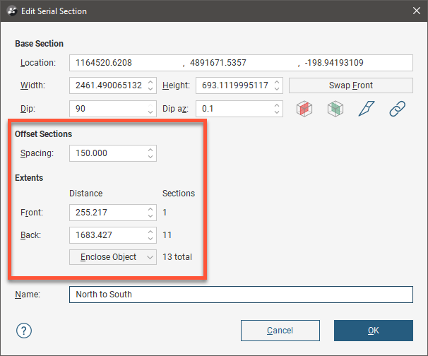

The number of offset sections is determined by the value of the Spacing setting and the Front and Back Extents:
You can change the number of offset sections by:
- Changing the Spacing setting, which changes how far apart each of the section slices are. The number of offset sections will be recalculated and updated in the scene.
- Changing the Front or Back settings. For example, increasing the Front setting adds an offset section on the front of the base section, increasing the extents by the value of Spacing.
- Changing the object used to define the extents. Select an object from the Enclose Object list. The base section will be moved to the centre of the selected object.

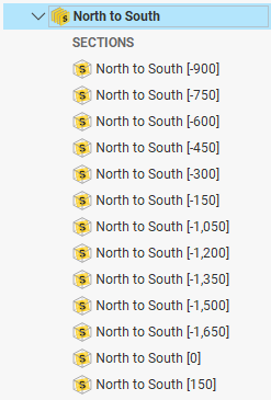

In the project tree, the serial section includes the individual cross sections:
At this point no sub-section in the serial section has any defined layout.

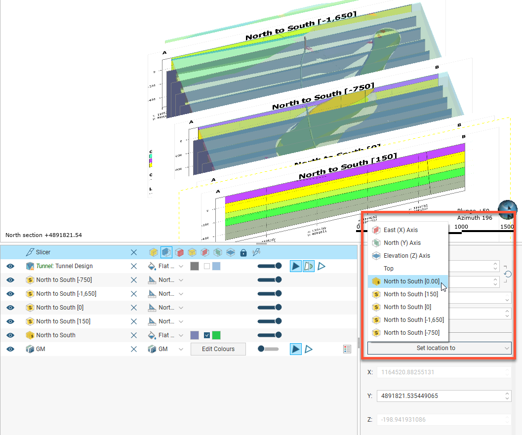

When you display a serial section in the scene, you can add the slicer to the scene and use it to move easily between the sections in the stack. To do this, click on the slicer in the shape list, then select the base section from the Set location to list:
Next, set the Step size to the Spacing setting used to create the section. You can then use the , and . keys (these also have < and > on them) to go back and forwards to view each individual cross section.
You can also select any layout that has been added to the scene from the Set location to option list.
