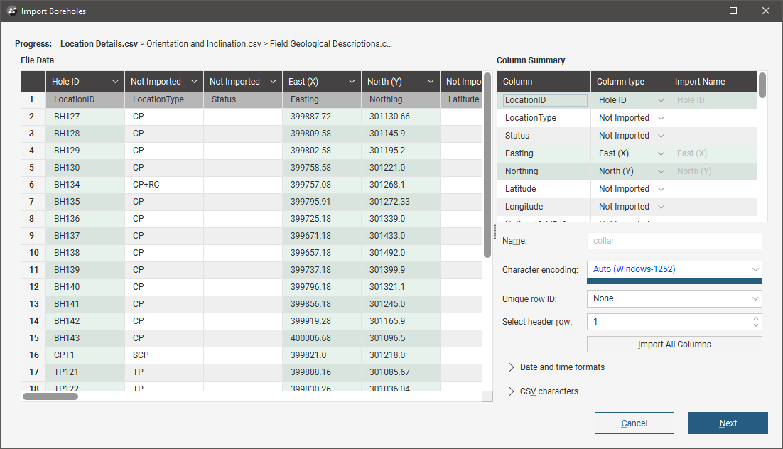

For data imported in CSV, ASCII, TXT, DAT and TSV formats, separate files are required for each type of table. For data imported in AGS format, a single file is imported that contains each type of table and a summary of the relevant data is presented at each stage of the importation process so you can select from the available groups of data. AGS format is described in AGS Format Drilling Data below.
The collar table should contain five columns:
- A borehole identifier
- The location of the borehole in X, Y and Z coordinates
- The maximum depth of the borehole
A collar table can also contain a trench column, and collars marked as trenches will be desurveyed in a manner different from other boreholes. See Desurveying Method for more information.
Leapfrog Works expects a 0 for a normal hole and a 1 for a trench. If there is no trench column in the collar table, Leapfrog Works will create one.
The borehole ID is used to associate data in different tables with a single borehole. The ID for a borehole must be identical in all tables in order for data to be associated with that borehole. Inconsistencies in the way boreholes are identified are common sources of errors.
The maximum depth column is optional. If it is present, is used to validate the data imported for the interval tables. The maximum depth specified is often a planned quantity, whereas the interval table records actual measurements. For this reason, Leapfrog Works has an option for fixing the maximum depth value in the collar table to match the data in an interval table.
If maximum depth information is not included in a collar file, Leapfrog Works will determine it from the maximum depth sampled as indicated by data in the interval tables.
Boreholes in AGS format may also include a Project ID column that can be used to identify boreholes that have the same hole ID but are actually from different projects.

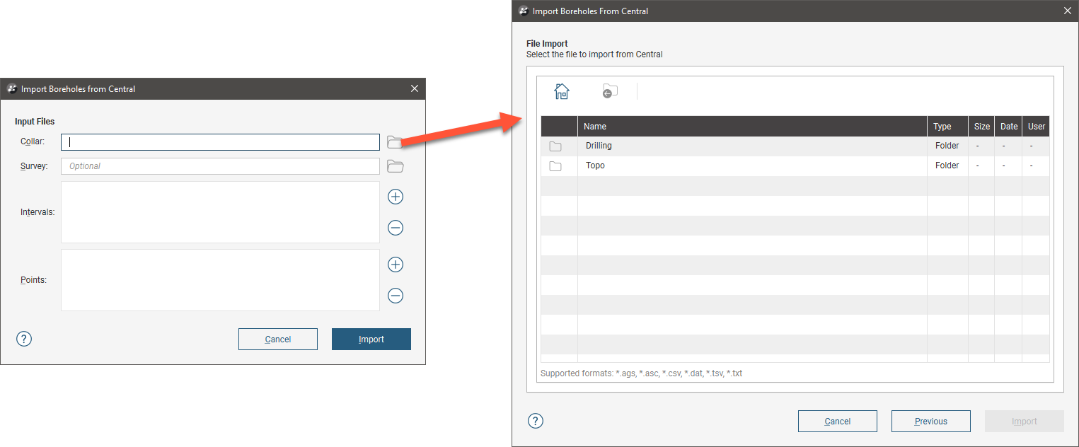

Importing Drilling Data from Central
Drilling data can only be imported from a project’s files. Although drilling data can be published to Central, that is for the purpose of visualising the data in the Central Portal. Published drilling data cannot be imported into other Leapfrog Works projects.
To import drilling data from Central, first make sure you are connected to a Central server. Next, click on the Borehole Data folder and select Import Boreholes > Central. In the window that appears, select the project you wish to import data from. The Import Boreholes from Central window will be displayed. Click the button for Collar to navigate the project’s files to locate the collar file you wish to use.
Select the file and click Import. Work through the files as described in Importing Data Tables.

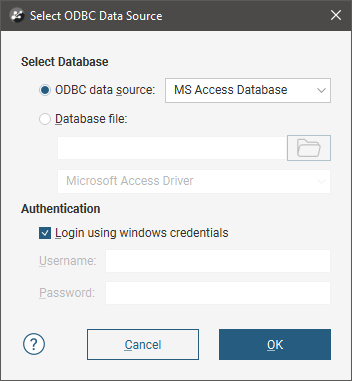

Leapfrog Works supports database files in Access Database (*.mdb, *.accdb) and gInt Project (*.gpj) formats.
To import drilling data directly from any database that uses an ODBC interface, right-click on the Borehole Data folder and select Import Boreholes > ODBC. The Select ODBC Data Source window will appear:
Enter the information supplied by your database administrator and click OK.
If you are importing from a local database file, click the Database file option and then browse to locate the file.

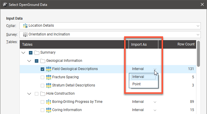

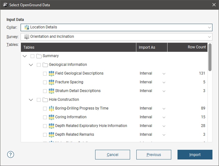

Connecting to an OpenGround Database

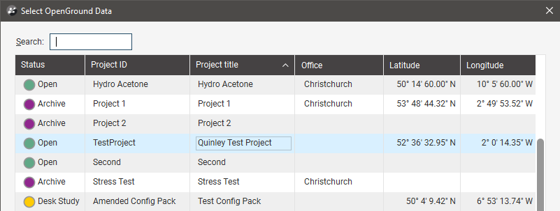

To import drilling data via OpenGround, right-click on the Borehole Data folder and select Import Boreholes > OpenGround. In the window that appears, enter your credentials for the database you wish to connect to, then select the instance you will use.
In the next window, you can filter the list of projects using the Search box. Select the project you wish to open, then click Next.
Once the project has been opened, select the data columns to map to the Collar, Survey and Tables lists.
You can only select one collar table and one survey table, but you can select as many interval and point tables as you need. Change how tables are mapped using the Import As dropdown list:
Select only as many columns as you need to work with. You can import additional data columns from the project later.
Once you have selected the columns you wish to import, click Import to work through the data tables and add the data to the project tree.

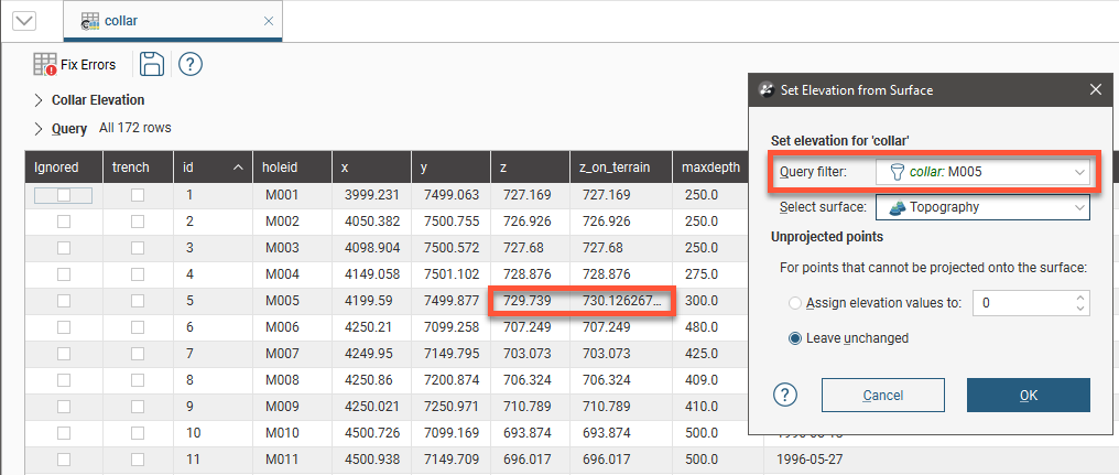

Setting Elevation for Collar Points
You can set the elevation for all collar points or for a subset of collar points by projecting them onto a surface. This creates a new column in the collar table called z_on_terrain, and you can switch between using the original values in the z column and the projected values in the z_on_terrain column:

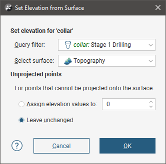

To set the elevation for collar points from a surface, right-click on the collar table in the project tree and select Set Elevation. The Set Elevation from Surface window will appear:
Select from the surfaces available in the project and set a query filter, if you wish to limit the collars you will project onto the surface.
If the surface does not intersect vertically with some points, you can choose how the z_on_terrain values for those points will be determined. There are two options:
- Leave unchanged makes no changes to the z values for unprojected points; the original z column values will be used.

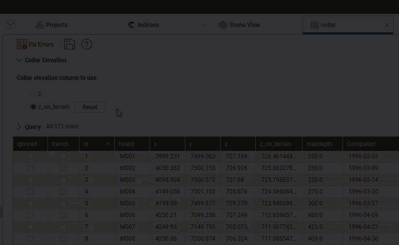

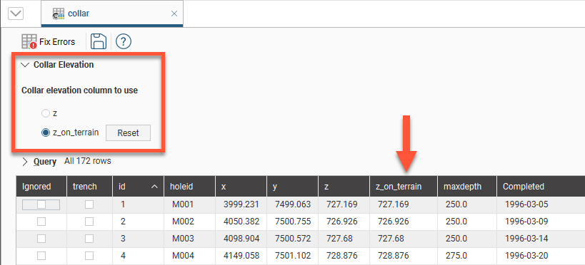

The collar table will be updated with an additional column, z_on_terrain:
The z_on_terrain column values are determined as follows:
- For selected points that can be projected onto the surface, the elevation values from that surface are used
- For points that cannot be projected onto the surface, either a fixed elevation value or the original values from the z column are used, depending on the chosen Unprojected points option.
- For points you have chosen not to project, i.e. if you have used a query filter, the original values from the z column are used.

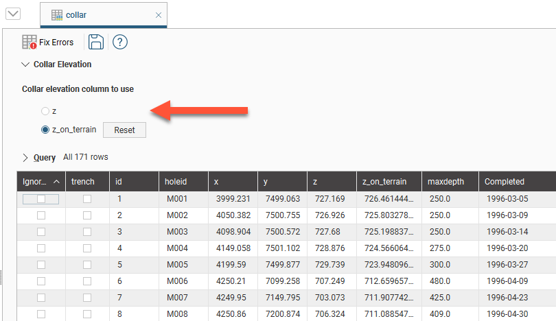

The original z values are preserved in the z column. To switch back to the original z values, click on Collar Elevation, then select the original column:
The z_on_terrain column will remain in the collar table; switching to using the original z column does not delete the z_on_terrain column.
Applying a query filter is useful for limiting the collars projected onto a surface. Here, a query filter has been used to project a single collar, M005, onto the topography:
All other values in the z_on_terrain are from the z column.
Note that you can repeat this process for multiple subsets of collar points, if there are different surfaces you wish to use in setting the elevation for different subsets of points.

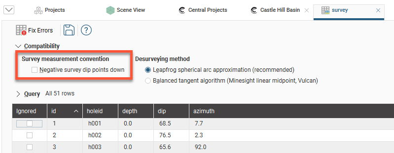

Dip Direction
To correctly represent the orientation of boreholes in Leapfrog Works it is essential to understand the convention used when the data was recorded. Leapfrog Works uses the negative-dip-values-point-up convention internally. When the survey table is imported, Leapfrog Works sets the Negative survey dip points down value according to the data in the imported table. When the majority of the dip data in the table is positive, Leapfrog Works assumes all these boreholes will point down and leaves the field Negative survey dip points down disabled. When most of the values are negative, Leapfrog assumes the external data has used a negative-dip-values-point-down convention, as it is unlikely that most of the boreholes have been drilled upwards, and the field is enabled. This field can be changed by double-clicking on the survey table to open it and then clicking on Compatibility to show the table’s desurveying settings:
If you are going to change the automatically set value of Negative survey dip points down, consider carefully the implications if there is a mix of boreholes pointing down and up.
Leapfrog Works uses the negative-dip-values-point-up convention. If the data you are importing uses the negative-dip-points-down convention, tick the Negative survey dip points down option. This will convert the imported data to the convention used by Leapfrog Works.

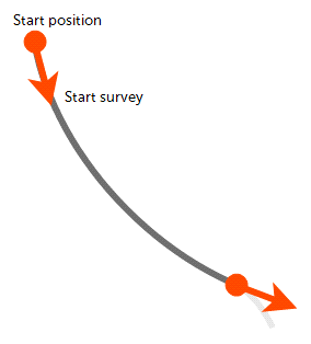

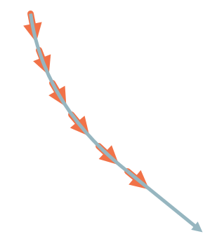

The Spherical Arc Approximation Algorithm
The default algorithm used in Leapfrog Works is spherical arc approximation, which is sometimes referred to as the minimum curvature algorithm. Downhole distances are desurveyed exactly as distances along a circular arc:
The algorithm matches the survey at the starting and end positions exactly and the curvature is constant between these two measurements. At the survey points, the direction remains continuous and, therefore, there are no unrealistic sharp changes in direction.
If you wish to use spherical arc approximation, there is no need to change any settings.

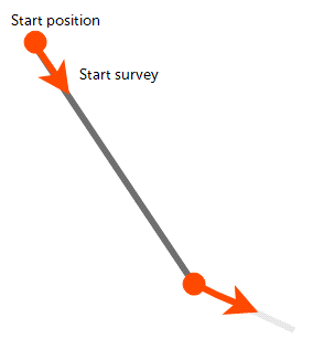

The Balanced Tangent Algorithm
The balanced tangent algorithm uses straight lines but attempts to improve the accuracy of the raw tangent algorithm by assigning equal weights to the starting and end survey measurements:
It is an improvement on the raw tangent algorithm but still suffers from an unrealistic discontinuity in the borehole path. It is, however, a better approximation of the overall borehole path and is reasonably accurate when the spacing between measurements is small.
To use the balanced tangent algorithm, double-click on the survey table in the project tree. Click on Compatibility and change the Desurveying method.
The Raw Tangent Algorithm

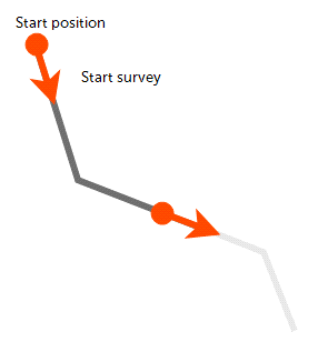

The raw tangent algorithm assumes the borehole maintains the direction given by the last survey measurement until the next new measurement is reached:
This implies that the borehole makes sharp jumps in direction whenever a measurement is taken, which is unlikely, except when the borehole is being used to define a trench.

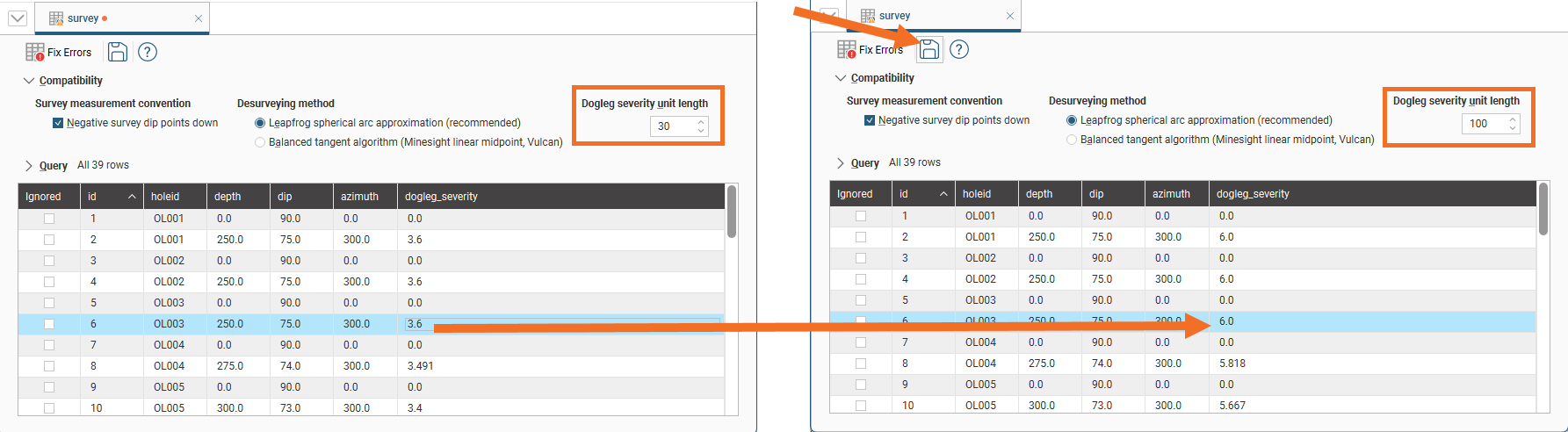

Dogleg Severity Unit Length
In the survey table the dogleg severity is expressed as degrees of deviation for a certain distance. The default distance is 30 distance units, however this can be changed.
