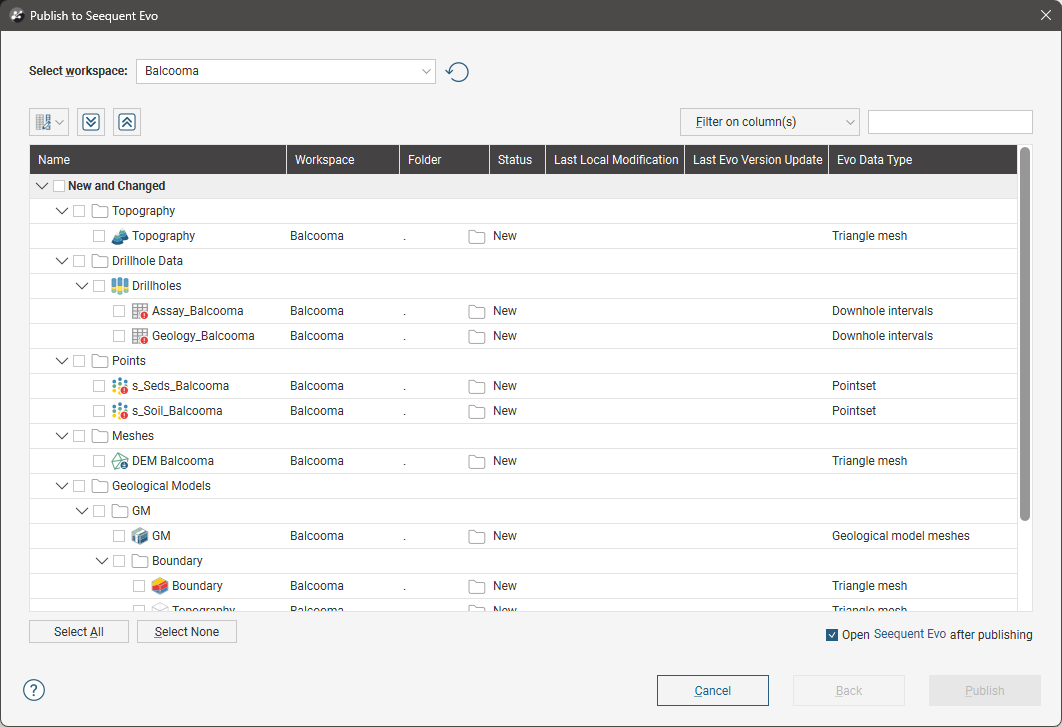

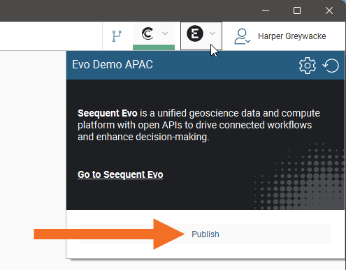

Not all data objects in a Leapfrog Works project can be published to Seequent Evo. The easiest way to find out what objects in a project can be published to Evo is to click on the Evo menu next to the user ID menu and then click Publish:
This opens the Publish to Seequent Evo window, which lists all the objects in the project that can be published to Evo along with their Evo data type:
You may need to select an Evo workspace before you can scroll through the list, and if a workspace you expect to see is not listed, click the Refresh button (

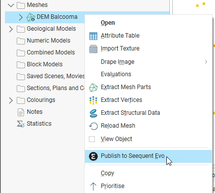

Right-click on individual objects in the project tree to find out if an object can be published to Evo. The Publish to Seequent Evo option appears for those that can:
If you right-click on a project tree item and Publish to Seequent Evo does not appear in the menu, it is not an object that can be published to Seequent Evo.

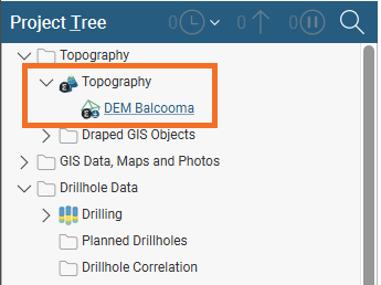

Objects in a project that have already been published to Evo are indicated in the project tree using an Evo badge, which is the case for the Topography and DEM Balcooma objects here:
Objects that have already been published to one workspace cannot be published to another. If you wish to publish an object to another workspace, you must either:
- Sign in to Seequent Evo at evo.seequent.com
and delete the object from the workspace. In Leapfrog Works you will then be able to publish the object to a different workspace. - In Leapfrog Works, make a copy of the published object and publish that copy to a different workspace.

There are two ways to start publishing data to Evo:
- From the Evo menu next to the user ID menu. With this method, you can bulk publish all objects in the project that can be published to Evo. To do this, click on the Evo menu and then click Publish. This opens the Publish to Seequent Evo window, listing all the objects in the project that can be published. None of the objects will be selected.

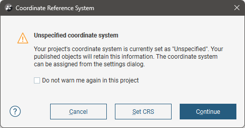

Setting a Coordinate System
The coordinate reference system that objects are published with depends on that set for the Leapfrog Works project.
Setting a coordinate system for your project is recommended when working in Seequent Evo, and if one is not set for the project, you will be prompted to set one when you try to publish to Evo:
The Coordinate System setting is primarily an informational field. The project coordinate system should be set when the project is created and all the data imported into Leapfrog Works should use the coordinate system that has been decided on for the project. Leapfrog Works will not convert any data that is imported with references using a different coordinate system into the project coordinate system, nor does changing the project coordinate system perform a conversion of the data within Leapfrog Works from the previous coordinate system to the new coordinate system.
Click the Set CRS button; the Settings > Coordinate System window will open where the coordinate system can be applied to the current project. See Coordinate System Settings for more information.
For most objects published to Evo, CRS information is published along with the object the first time that object is published to Evo. The exception is block models, which do not include CRS information when published to Evo.

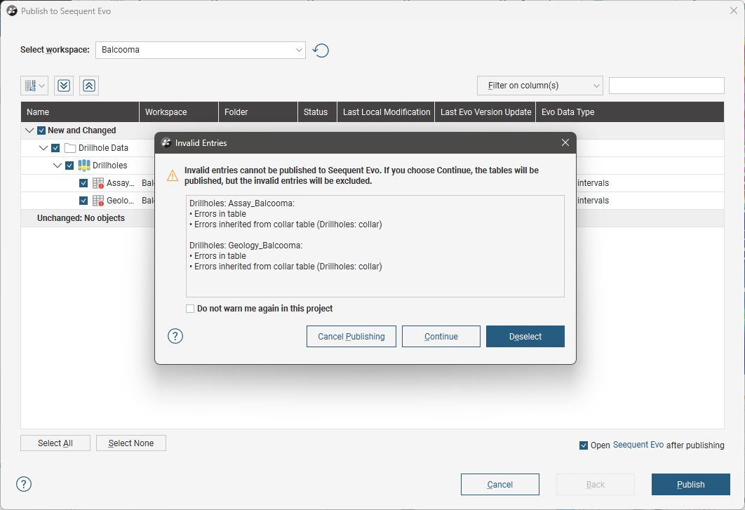

If any of the objects selected for publishing contain invalid entries, a warning will be displayed listing those objects. For example, here there are tables in a drilling dataset that contain invalid entries:
This warning does not mean that those objects cannot be published to Evo, but if you do go ahead with publishing those objects, the invalid entries in those tables will not be included.
If selected data objects contain invalid entries, you can:
- Cancel Publishing. Choose this option if you wish to correct errors in the data. This closes the Publish to Seequent Evo window without publishing any objects.
- Continue. Choose this option if you are satisfied with going ahead with publishing the selected data objects without the invalid entries. The warning window will be closed without closing the Publish to Seequent Evo window. You can then continue with publishing the selected objects.
- Deselect. Choose this option if you decide not to publish the objects that have invalid entries. The warning window will be closed without closing the Publish to Seequent Evo window but objects that contain invalid entries will be deselected. You can then continue with publishing the selected objects.
If you no longer wish to see this warning in the currently open Leapfrog Works project, enable the tickbox. If you later decide you want to see this message when publishing data objects that contain invalid entries, you can enable it via the Settings window. Click on the Leapfrog Works menu, select Settings, then click on the User Interface tab:

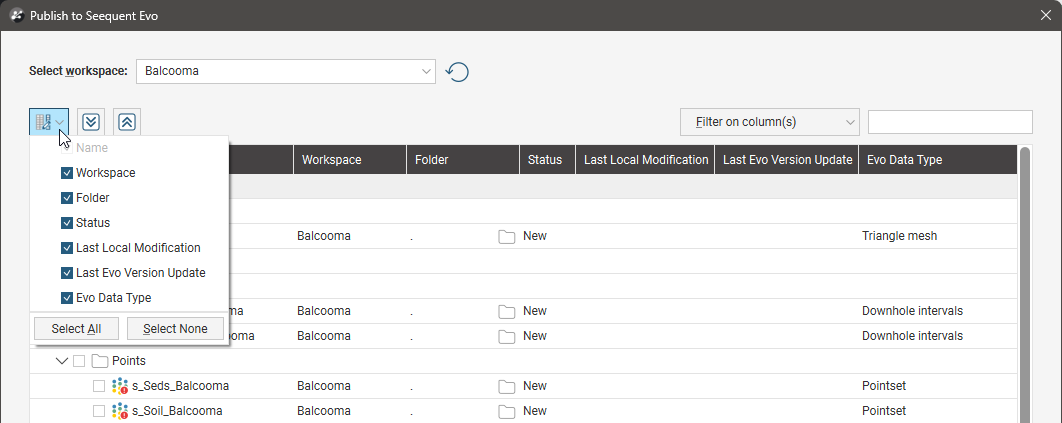

Filtering and Selecting Objects
With the column button (
), you can choose which columns appear in the table, which can assist in selecting data to publish when the project contains a lot of data.

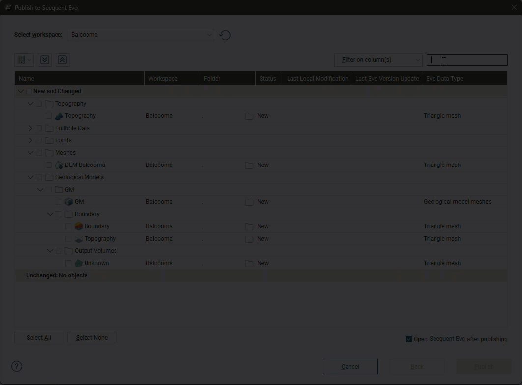

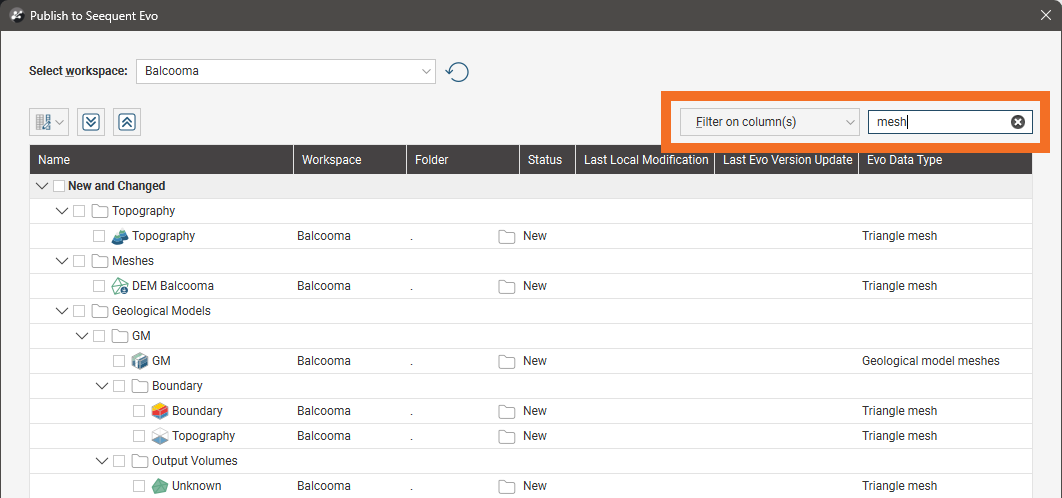

You can also filter the list to limit the number of objects displayed. For example, here we have used the filter to restrict the list to the term ‘mesh’, which shows all objects that include ‘mesh’ in their names or whose Evo data type contains ‘mesh’:

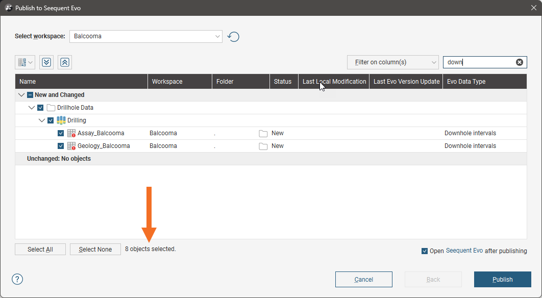

You can choose which columns are used to filter the list by clicking on Filter on columns. When no columns are selected, the filter is applied to only object names, which is why the first filter applied returns no objects. Then when the Evo Data Type column is selected, the data types with ‘mesh’ in their names are listed:
Note that filtering out objects in this way does not deselect them, if they were selected before the filter was applied. The actual number of selected objects will always be displayed below the list. For example, the list has been filtered to show only two objects but 8 are selected:

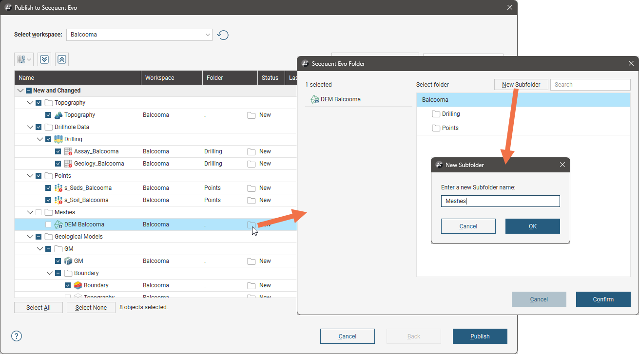

Organising Data Into Folders

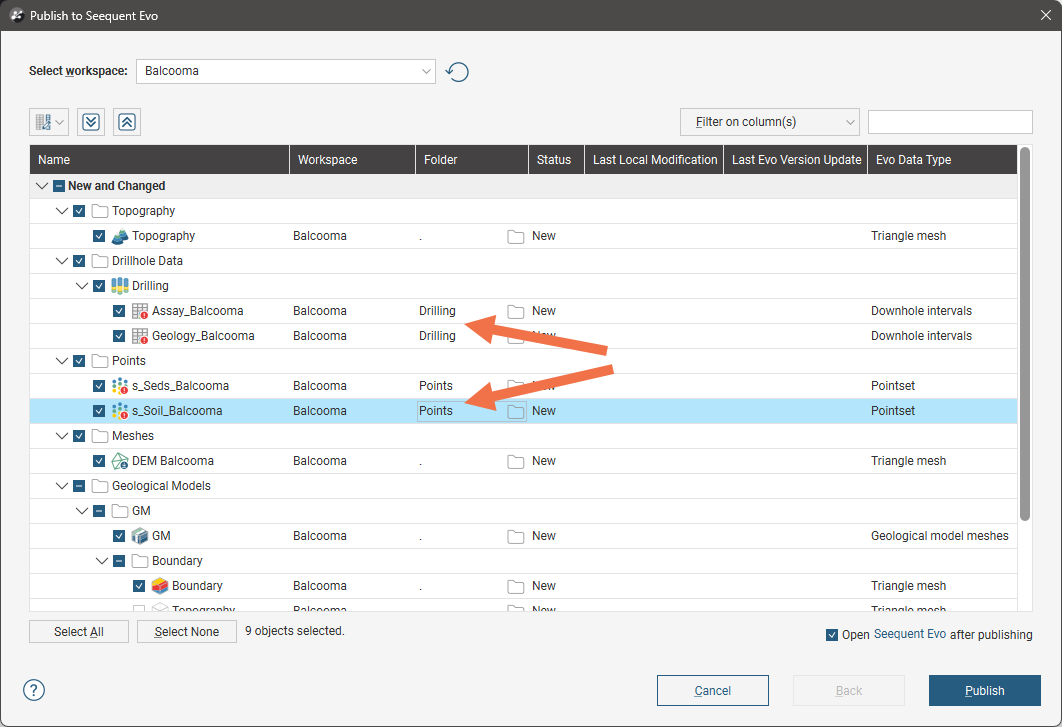

You can specify folders to which objects will be published. For example, here, four of the objects listed will be published into two folders:
Note that once an object has been published, the folder to which it is published cannot be changed, nor can the folder be renamed.
To publish a data object to a folder, click the Folder button (
) for that object. You can also select multiple objects and add them to the same folder; to do this, select the objects, then click the button for one of them.
In the Seequent Evo Folder window, you can define the folder structure for the workspace:
If there are other objects in the workspace in existing folders, they will appear in this window and you can publish more objects to them.
Create new folders, if necessary, and choose the one you want to publish the selected data objects to.

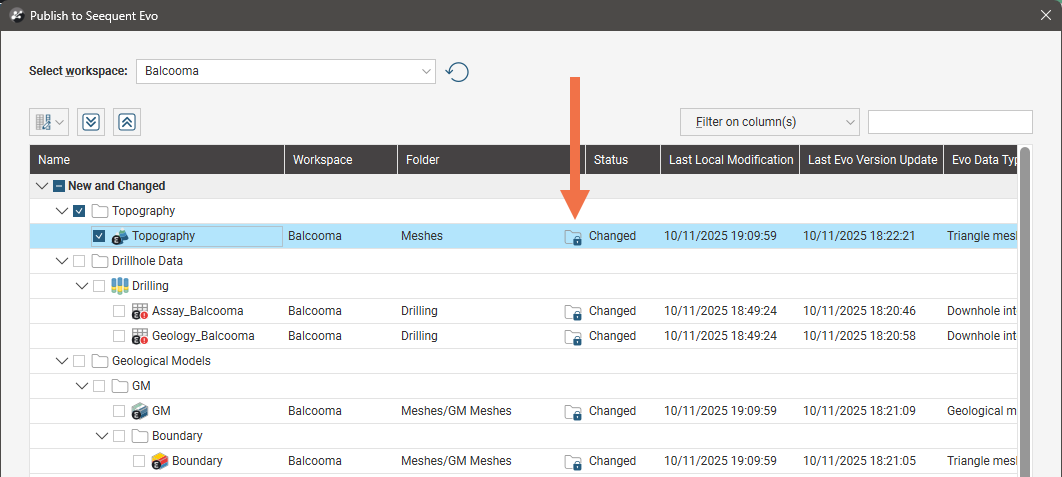

Note that once you publish objects to Evo, you cannot change the folder they have been published to, nor can you rename folders that already contain published data. In the Publish to Seequent Evo window, such folders are shown as locked:

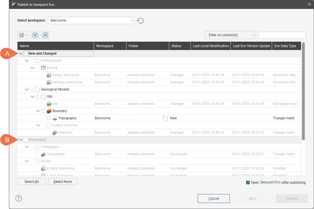

The Publish to Seequent Evo window categorises objects into those that have changed and those that haven’t:
New and changed objects can include:
- Objects that have been updated in the Leapfrog Works project.
- Objects that are new to the Leapfrog Works project.
- Objects that were previously published to Evo but have since been deleted from Evo. If this is the case, you will be prompted to publish the object as a new object. You cannot publish an ‘update’ to an object that has been deleted from Evo.
If an object has already been published to Evo, you cannot change the folder it was published into.
