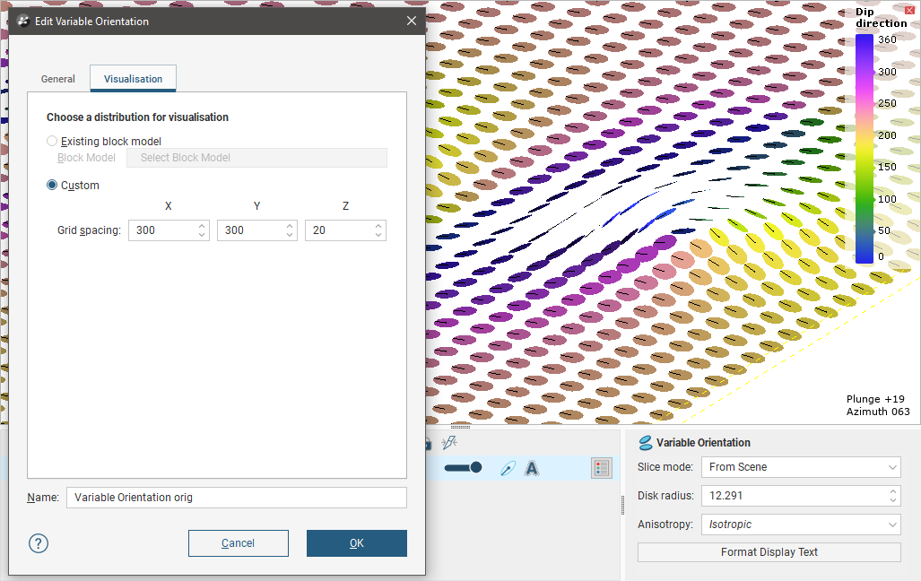

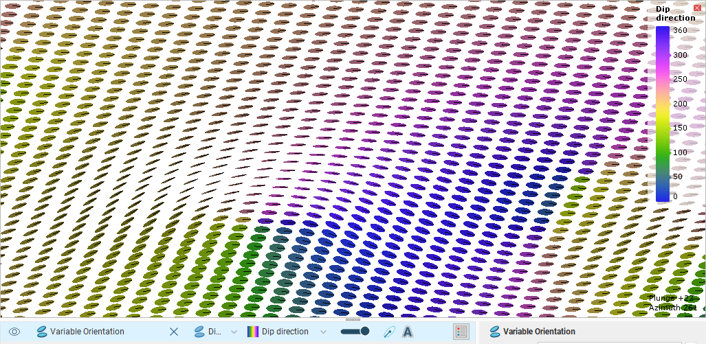

Variable orientations can be viewed as disks or lines. The grid used for visualisation can be any block model or sub-blocked model in the project, or a custom grid can be specified as part of setting up the variable orientation.
Here a variable orientation is visualised on a custom grid, with disks coloured using the Dip direction values at each point on the grid. Enabling text display (
) shows the values in the scene. The disks are a representation of the local orientation of the maximum-intermediate plane calculated at the chosen centroids. They represent both the search ellipsoid and the variogram, by indicating their principal plane. The line on each disk indicates the position and direction of the major axis.
Search ellipsoids are described using axes of maximum, intermediate and minimum continuity. Variogram ellipsoids are described using major, semi-major and minor axes. Because both the local search ellipsoid and local variogram orientation are indicated by variable orientation disk and line objects in the scene, we will avoid potential confusion by using the terms maximum, intermediate and minimum in this topic, unless specifically discussing variograms.
Click on a disk to view further information about it.

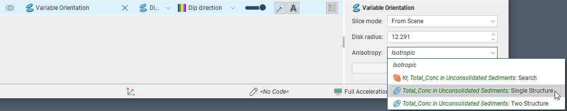

You can also change the Anisotropy used to display the variable orientation. Options are Isotropic and any variogram models and search spaces defined in the estimation:
When anisotropy is displayed, the ratio of the maximum-intermediate axis of the chosen object is displayed. The actual range is not shown.

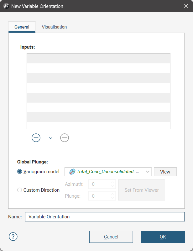

To create a variable orientation, right-click on the domained estimation’s Variable Orientation folder and select New Variable Orientation. Inputs and the Global Plunge are set in the General tab, and how the variable orientation will be displayed is set up in the Visualisation tab.
Selecting the Inputs

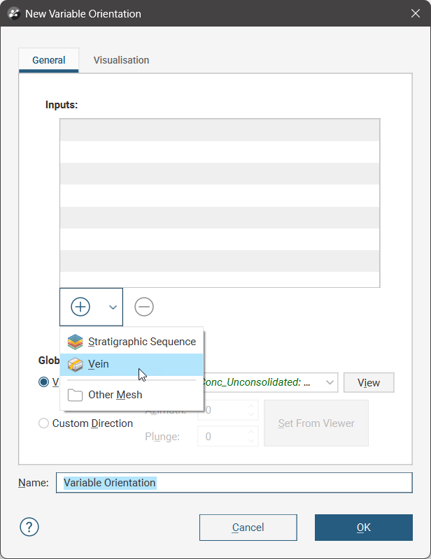

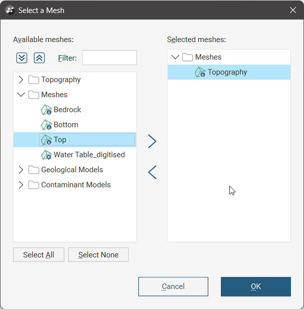

On the General tab, click the Add Inputs button, then select a type of object to use to provide a form for the variable orientation. You can choose from:
- Stratigraphic Sequence objects
- Vein objects
- Other Mesh objects
You will then be presented with a Select window presenting a list of available objects and a list of selected objects. Move the objects you want to use to provide form to the variable orientation into the list of selected objects.
Inputs to a variable orientation can include veins, a stratigraphic sequence and any mesh in the project. When a mesh is used, it should be an open mesh that draws out the shape of the undulations of the structure, rather than a closed mesh such as the domain. The facing direction of the surface is relevant; it is used to determine the direction of the surface normal vectors. Each vertex of the mesh is used to generate the orientation, so the resolution of the mesh should be sufficient to capture subtle changes in trend without adversely increasing processing time.

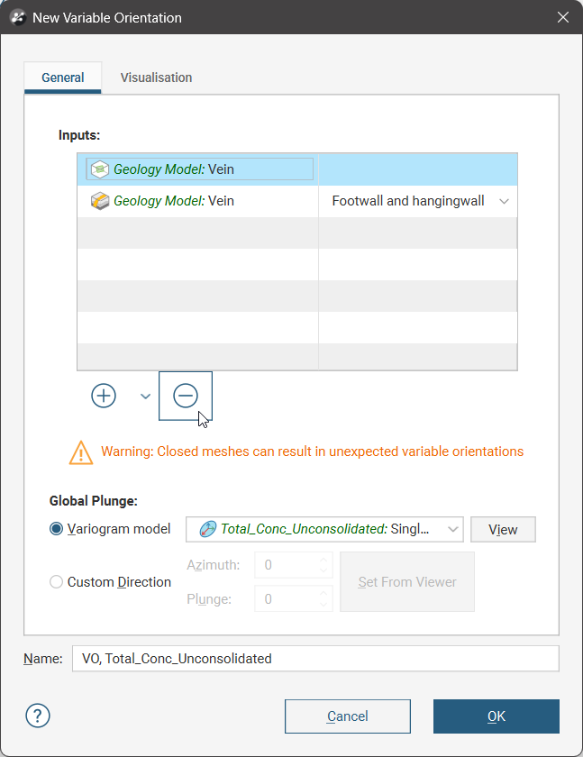

Closed surfaces have a consistent inside and outside direction. Normals on a closed surface will therefore point either inwards or outwards, resulting in the normals on the opposite side of the mesh pointing in the opposing direction. Interpolating these conflicting normals will lead to sudden unpredictable changes in orientation.

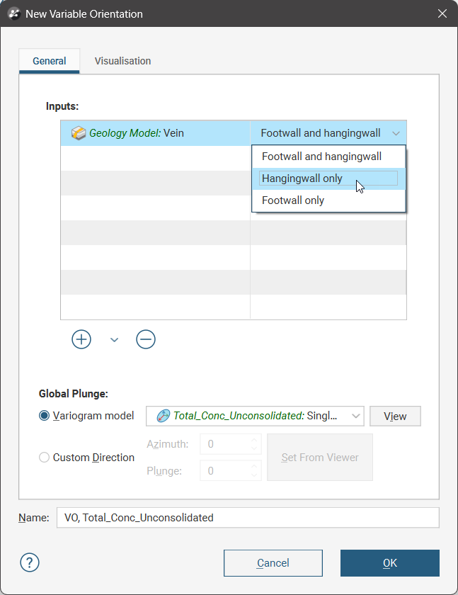

When a vein is added as an input, you will get both closed mesh and open hangingwall and footwall meshes. Removing all the closed meshes by selecting these objects and clicking the Remove button will dismiss the warning.
For each of the open vein surfaces, you can choose to use the Footwall only, Hangingwall only or Footwall and hangingwall meshes.
Where both footwall and hangingwall meshes are used, orientation is computed from an average of the two gradients.

The Global Plunge is used to determine the direction of the principal axis on the principal plane. The Global Plunge is a vector defined by either the major axis of the global variogram or globally defined search, or it is set from the view. This vector is used to determine where the direction of the principal axis should lie within the locally re-oriented principal plane. This is achieved by finding the direction on the local plane that is closest in orientation to the global vector. In practice this amounts to projecting the shadow of the global plunge vector, in the direction of the local normal vector, onto the re-oriented local plane.
You have two choices for the Global Plunge:
- Use one of the variogram models defined for the contaminant estimation. Select one from the dropdown list.
- Set a Custom Direction. Click and drag in the scene to align the view to the direction of the perceived maximum continuity, then click Set From Viewer. Capture the current scene to bookmark the direction you have set, as the Custom Direction cannot be visualised in the scene.

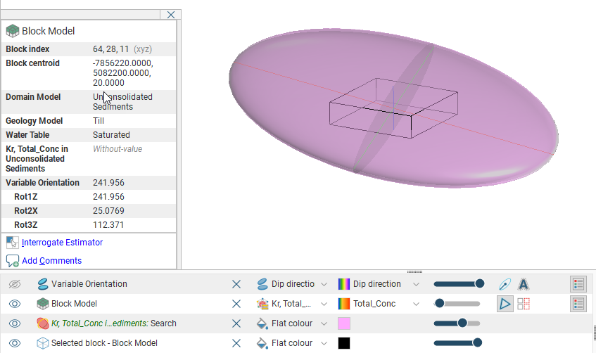

When a variable orientation is applied to an estimator, the local search can be visualised using the block model interrogation tool.
Here one block in a block model is shown with the search area indicated by the ellipsoid widget. The orientation of the ellipsoid reflects the direction set by the variable orientation for this block:

When a variable orientation is evaluated onto a block model, the Dip Direction and Dip in the variable orientation are represented in the rotation using the ZXZ convention.
- Rot1Z is the value of the rotation about the z axis. This turns y into y' and x into x', which is equivalent to the Dip Direction in the variable orientation.
- Rot2X is the value of the rotation about the x' axis and is equivalent to Dip.
- Rot3Z is the value of the rotation about the z'' axis.

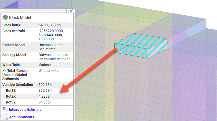

When a variable orientation is evaluated onto a block model, you can click on a block to view the rotation information:

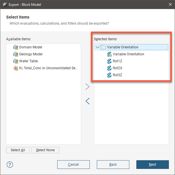

If required, you can export the rotations for use in other packages. When exporting the block model, be sure to select the variable orientation evaluation:
