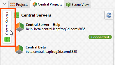

The Central Servers panel in the Central Projects tab shows all the Central servers you have access to. If a server you expect to see does not appear in the list, click the Refresh button (
Click a button to connect to a server. To hide the Central Servers panel, click the button.

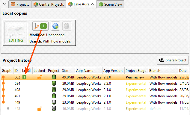

These are displayed visually in a project’s history tab, with local copies of projects shown in the panel at the top of the tab:
Each local copy is numbered so that it can easily be seen what versions have local copies in the Local column. The number in the column corresponds to the project in the Local copies panel. You can also:
- Click a thumbnail to open a local copy.
- Click the branch/copy number button (
) to identify the parent version of the local copy in the project history. - Click the Publish button (
) to publish the copy being edited to Central. - Click the Delete button (
) to delete a local copy, if the project is not open.
In the Project history, revisions are displayed chronologically, from the most recent down to the oldest. In the Graph, offshoots from a revision are branches where an alternative hypothesis has been investigated. Changes made in a branch do not appear in other branches; branches effectively diverge from the base revision. The dots on the graph line up with the revision information.
To view more information about a revision, click on it in the history.

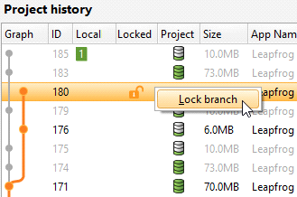

To lock a branch, right-click on it in the project history and select Lock branch:
In the window that appears, set the Lock duration and add any comments. The lock can be set for as little as one day; when the lock expires or when a new publish is completed, the branch will be unlocked for other users. While the branch is locked, other users are still able to download projects, create new branches and publish to branches that are not locked.

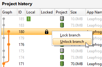

If you locked a branch, you can unlock it before the lock expires by right-clicking on it and selecting Unlock branch:

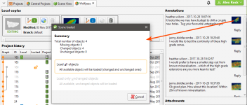

With Annotations, Central Browser and Leapfrog Works users can carry out conversations about specific aspects of the model. Annotations include a scene. If you already have the project open in Leapfrog Works, you can load any scene from that project’s history by clicking on it. Information about the selected scene will be displayed and you will be prompted to load all the objects or only the unchanged objects:
If the selected scene has a geotag, it will be added to the shape list and displayed in the scene.

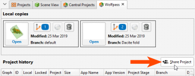

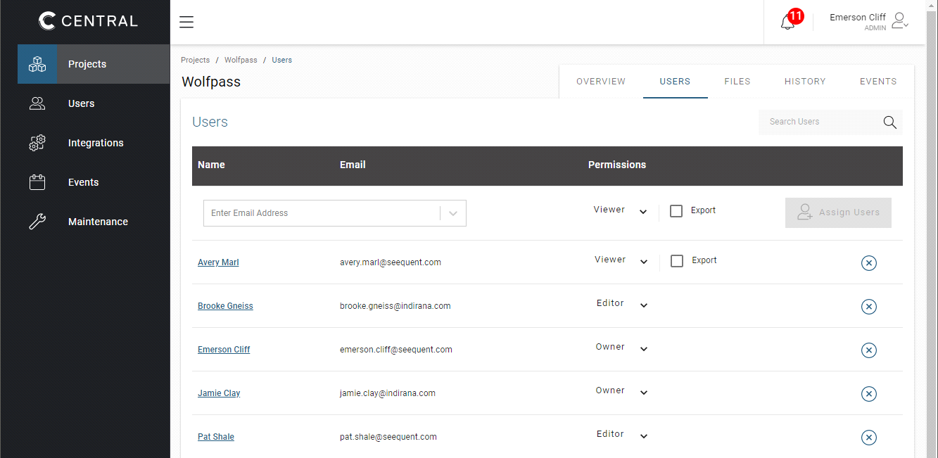

If you are a project’s owner, you can share it with other Central users by clicking the Share Project button in the project’s history tab:

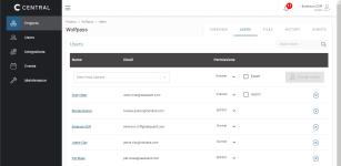

Clicking Share Project opens the Central Portal, displaying the list of users for that project:
You may need to sign in to the Portal.
You can select from the other users in the system or enter a user’s email address, then assign their permissions.
There are four levels of project permissions in Central: Owner, Editor, Viewer+Export and Viewer.

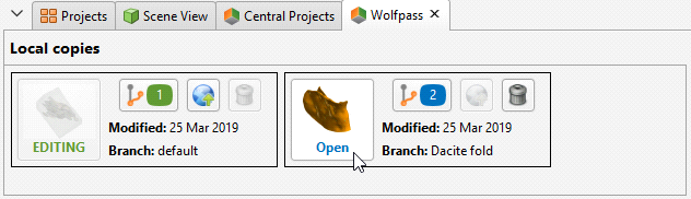

Click the Open button in the Local copies panel to open the project:
