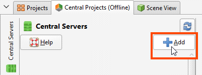

If your Central server requires that you manually set up your Leapfrog Works connection to it, you will need to enable Central. To do this, open the Settings window by clicking on the Leapfrog Works menu. Select Central and tick the box to Enable Central integration. A Central Projects tab will appear in the main window.
The first time you connect to Central, you will need to set up your connection. Request an account from your Central administrator, who will provide you with your connection details. Once you have these details, click on the Central Projects tab. Click the Add button to add a new server:
Click New user to enter your activation code, then enter the information provided to you by your Central administrator.
